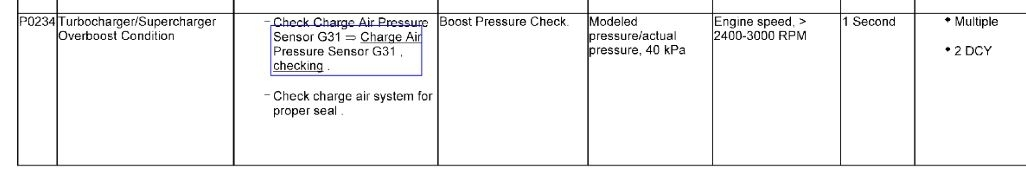

Honestly, either there is an over boost issue or the charge air pressure sensor is bad. I attached a diagnostic flow chart, but it will require specialized tooling. See picture 1.
Here are the diagnostic directions for the sensor. All remaining pics but the last one correlate with these directions.

Let me know if this helps. And honestly, if it is over boosting, it can cause engine damage. When you remove the sensor for cleaning, do the checks listed above to confirm it is good.
