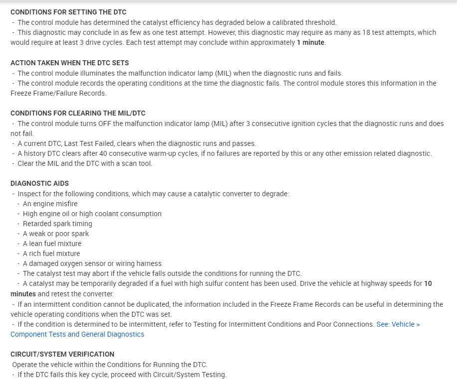

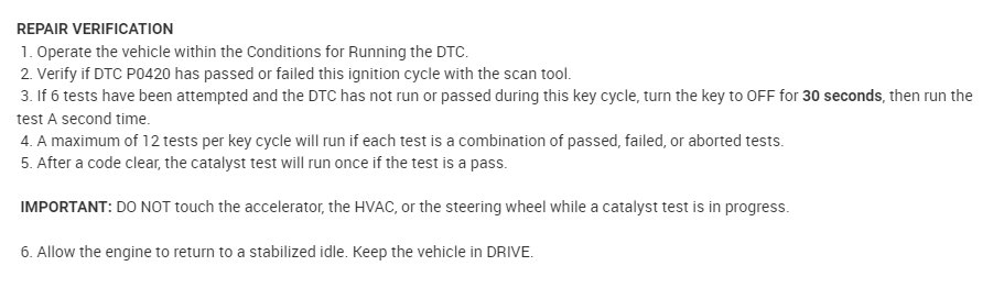

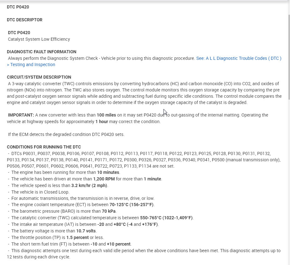

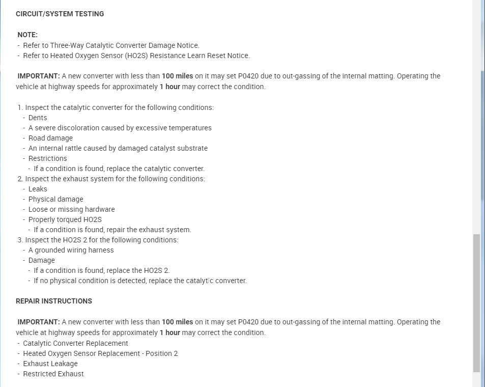

I attached the diagnostic information that gives the detail about the other items to check. The largest cause of this (after the sensors and cat) is an exhaust leak. It could also be a wiring issue but check out the diagrams and let me know if you have questions. Thanks
