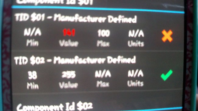

I have done the proper driving patterns to set the system and still everything passes except catalyst, and there are still no trouble codes(no check engine light). The diagnostic device gives me info that I am not familiar with (see image).
Nov 7, 2016 at 9:03 AM
WRENCHTECH
  • 20,761 POSTS
That is raw data that has not been processed yet. Do not worry about that.
