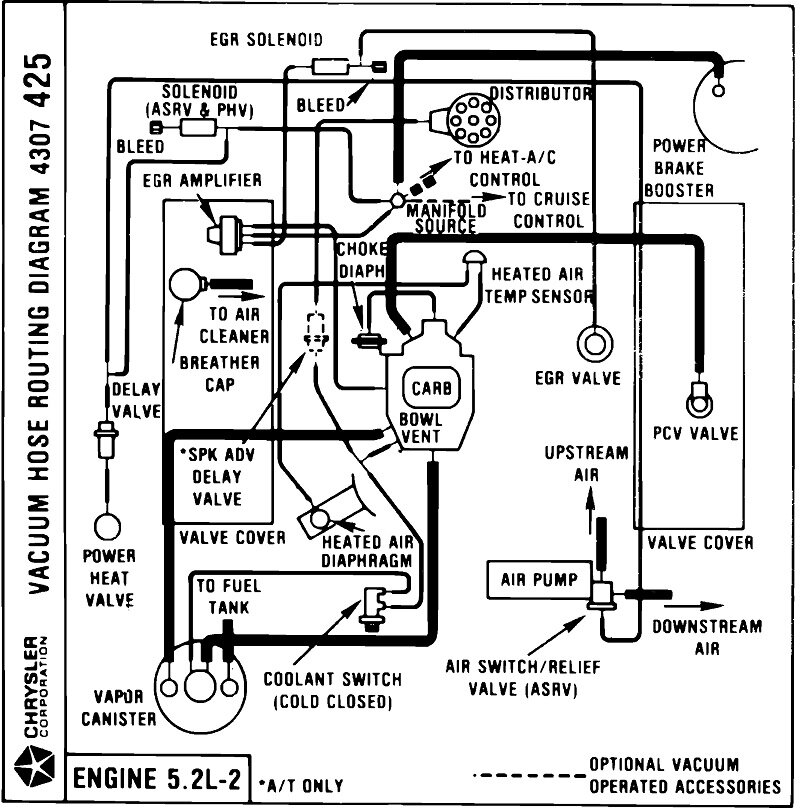

Hello, I’m Mark, this is my 2nd time here. You guys so far have been awesome with help. So, my son bought a 1984 dodge d250, 318ci/727auto. He is going to try doing a restore on it. Now my questions would be where I can find or get schematics for every thing emissions related to the truck. Example the smog pump is locked solid and what ever else that was on it was just cut off and plugged up. So, he has no idea what would go where. Could really use any diagrams of airlines, vacuum hoses. Anything with the air cleaner would be a great start to making her right to diagnose band illuminate any problems with the entire emissions system. Thanks in advance

Normally there can be dozens of variations for a given year and model, so the best is to use the diagram on the truck. You'll find that under the bottom of the hood. In this case they only show one diagram for the 318 c.i., so there's no guessing.
Nothing beats a paper copy of the manufacturer's service manual. The best place to find them is on eBay. Also look at old car show swap meets. I'll be selling lots of manuals at the nation's second largest show in Iola, WI right after July 4th. There's a couple dozen other vendors with nothing but manuals, so they're easy to find.
The next best alternative is to buy a subscription to AllData. That's where this diagram is from. For these older models, it's a copy right out of the original manual. Repair shops pay over a thousand dollars per year for access to this site. You can buy a subscription for just your one model for a lot less. The last time I looked a few years ago, it cost around $27.00 for one year, or $49.00 for five years. AllData also has recalls and service bulletins. Those are never in the service manuals.
