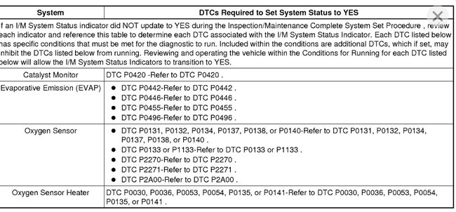

Was there a code that was set before?
I attached a chart for the monitors. I need to know if any of those codes were present.

As for the code set before, I don't have a clue. This is my first time getting this car tested. Also, to my knowledge, the battery was never disconnected which would require the sensors to be reset. Furthermore every sensor says "ready" except the O2 sensor.
