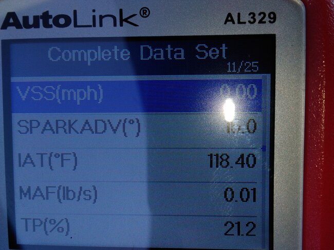

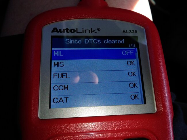

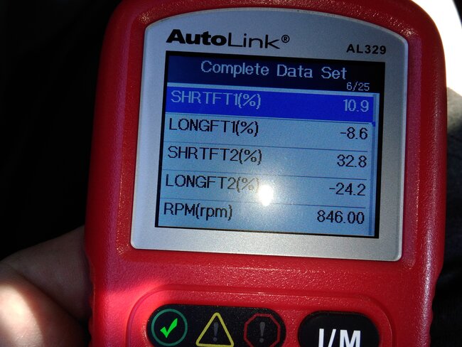

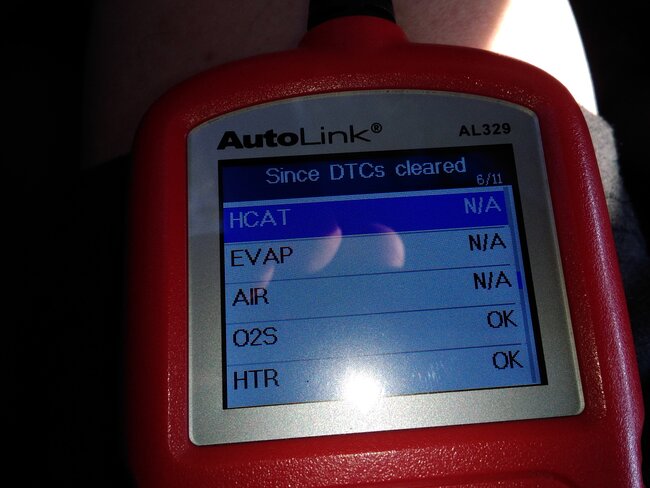

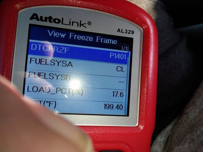

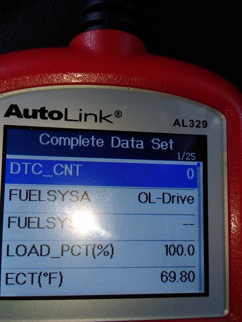

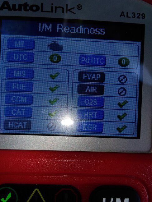

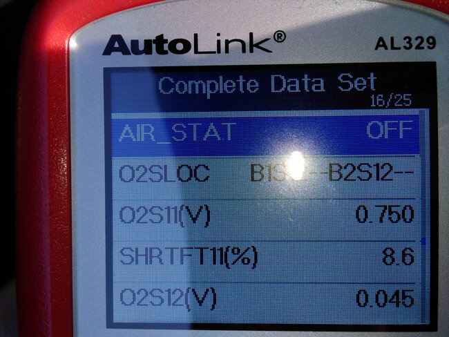

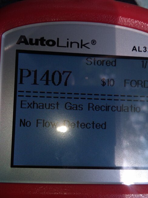

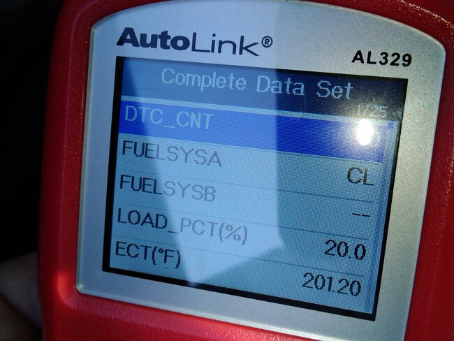

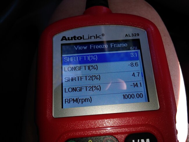

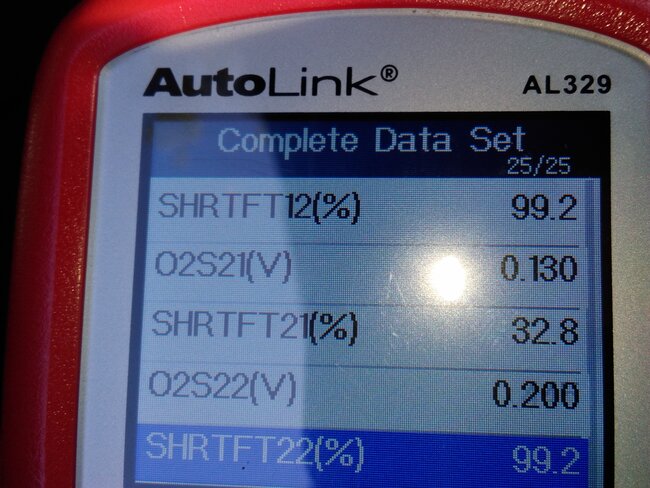

I have changed MAF sensor, and all four O2 sensors. Now I am getting a code P1407. Exhaust gas recirculation no flow detected. Is there a way to check the functioning of my EGR valve and the two other related electrical sensors without having a bunch of tools and related scanners. I'm a backyard mechanic with very limited tools. Could I just unplug a sensor at a time to see if it changes the running of the engine, when the engine is warm of course? It seems by my scanner in "live mode", the system is always in "closed loop" Maybe you can steer me to something else that may be wrong. Sorry for the terrible image of my scanner. Thanks in advance.
