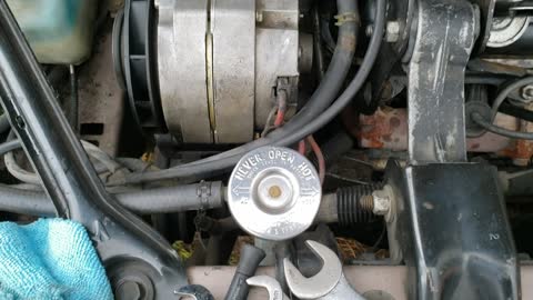

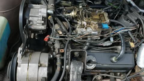

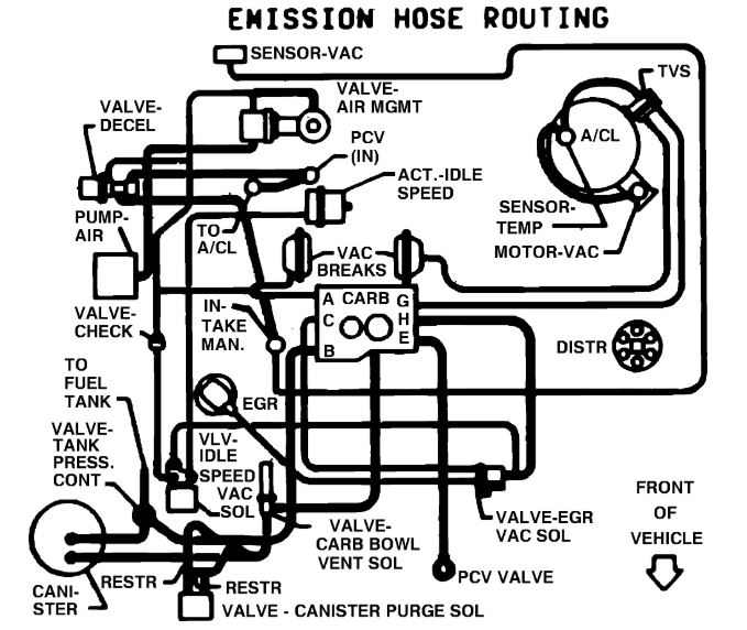

So I had never worked on a car in my life and I got this for free (first car as well). I replaced the rocker arm gaskets and messed up the emission hoses in the process and now it has no power like before and I can't figure out the diagram. any help would be appreciated.

Can you upload a video of the top of the engine so I can see what you see?
I need to see how you have the hoses hooked up so I can help.
I attached a vacuum hose diagram for you to view.

yea here you go. just let me know if you need to see anything specific.

Okay, that did not help that much.
Disconnect the EGR valve and drive it and see if it has power now.

yes, here's it running and when I rev it.
Apr 23, 2020 at 12:48 PM
I am sorry, no video came up.
Can you resend it?
Apr 23, 2020 at 12:49 PM
ZIP_SENPAI
  • 8 POSTS
sorry about that.
Apr 23, 2020 at 12:55 PM
Thank you.
I do not like the noise at all. that is an engine knock.
I would take this to a shop and have them listen to that noise.
Did you do anything with the valves when you have the covers off?
Give them a copy of the hose diagram as well so they can check each hose for the proper routing.
