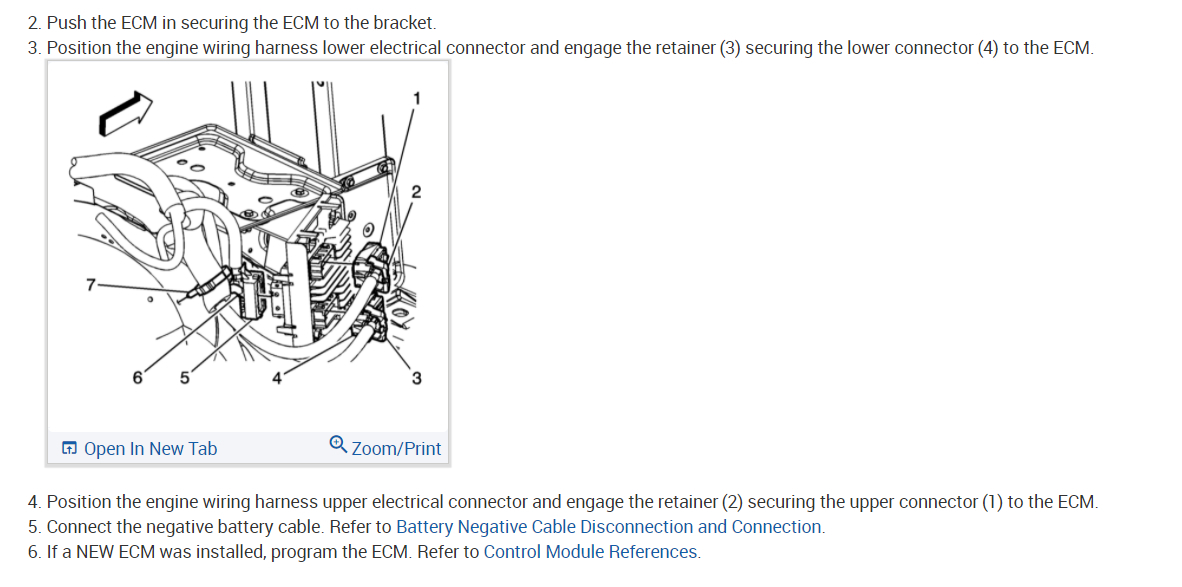

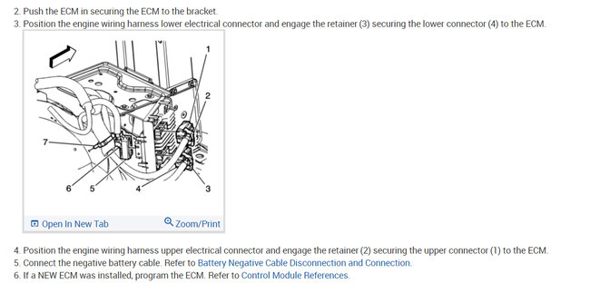

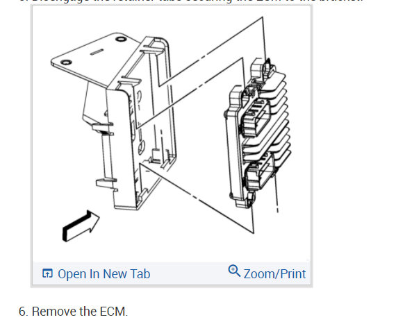

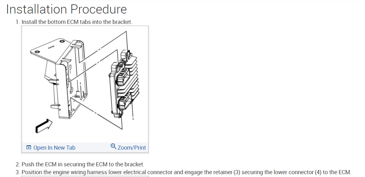

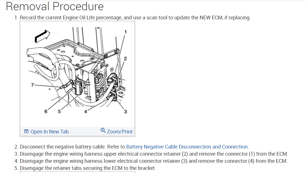

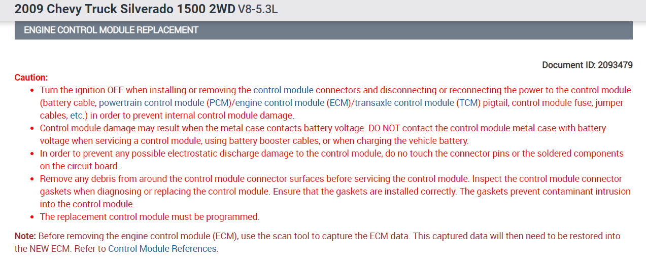

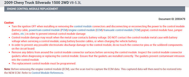

This is common when the PCM goes out here are the instructions for reapclemen in the diagrams below. You can get a rebuilt unit online just search google for the service. Check out the diagrams (Below). Please let us know what happens.
