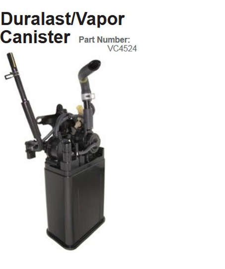

Have a check engine light, codes p0442 small leak and p0456 very small leak. Where is the purge solenoid vacuum hose and canister purge valve?
Nov 28, 2018 at 8:11 PM
Good evening,
Okay, both valves are in the one unit in the back of the car. It is under the back, in the middle bolted to the frame. I attached a picture for you to view.
This is a very common failure for both codes.
