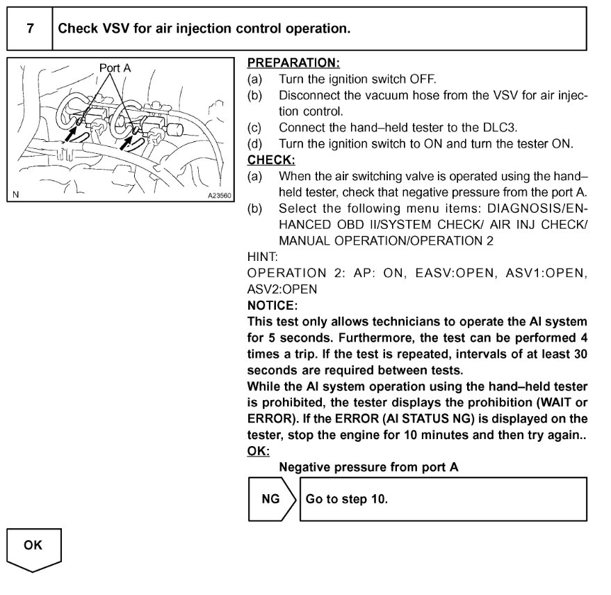

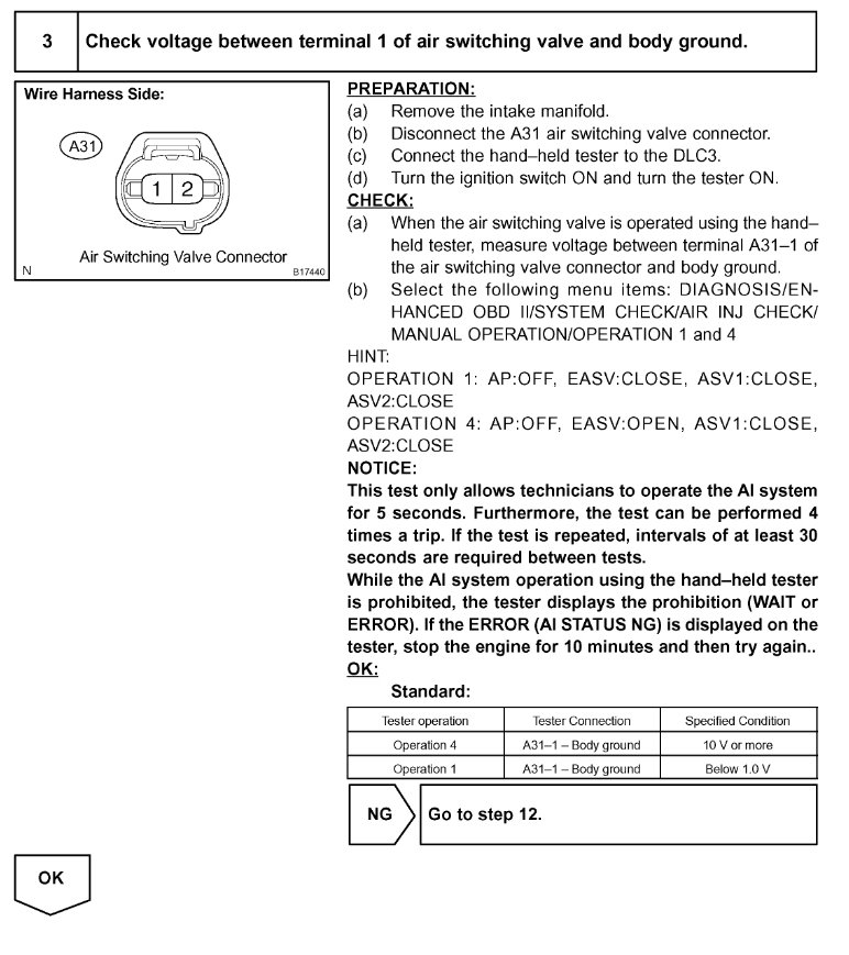

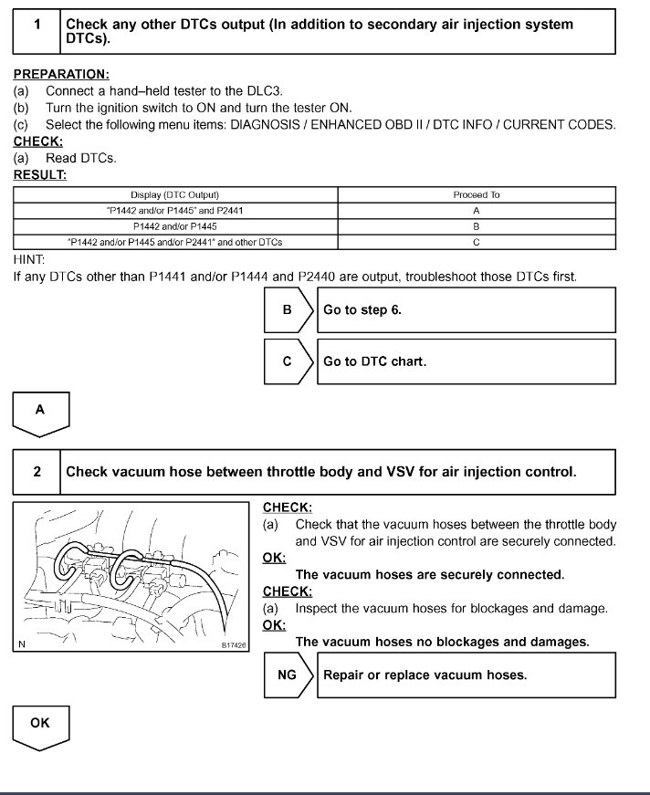

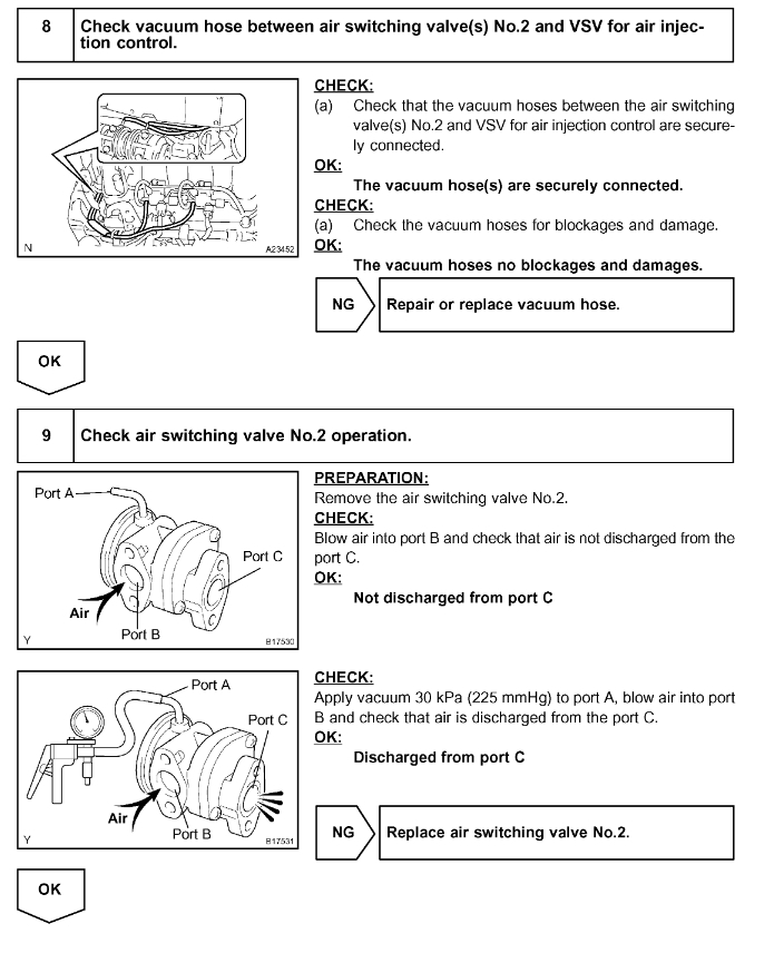

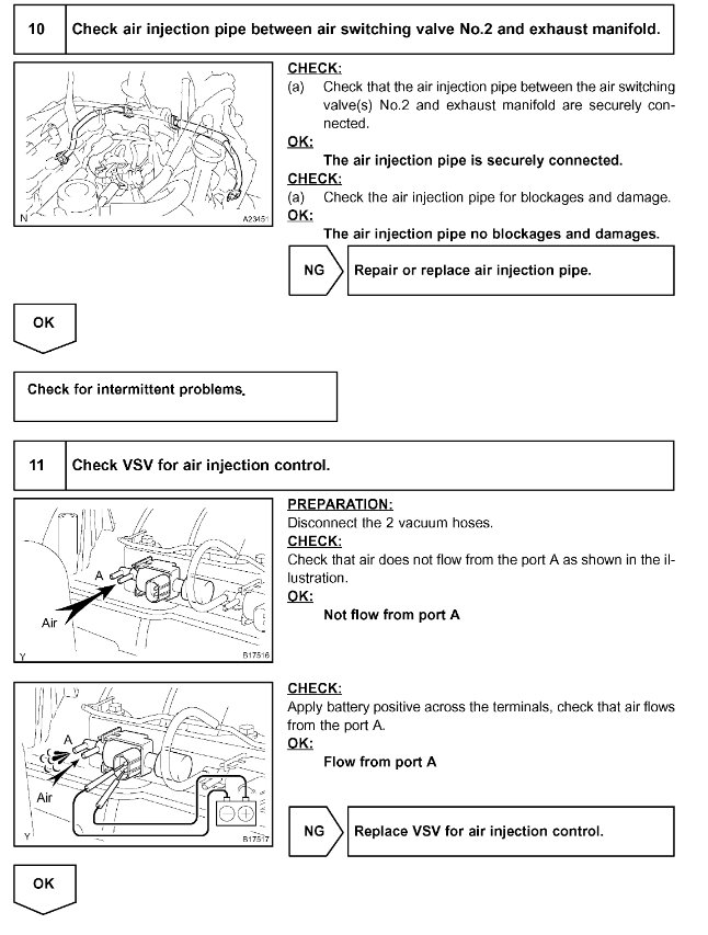

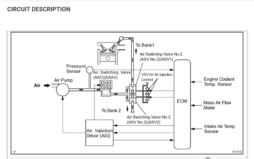

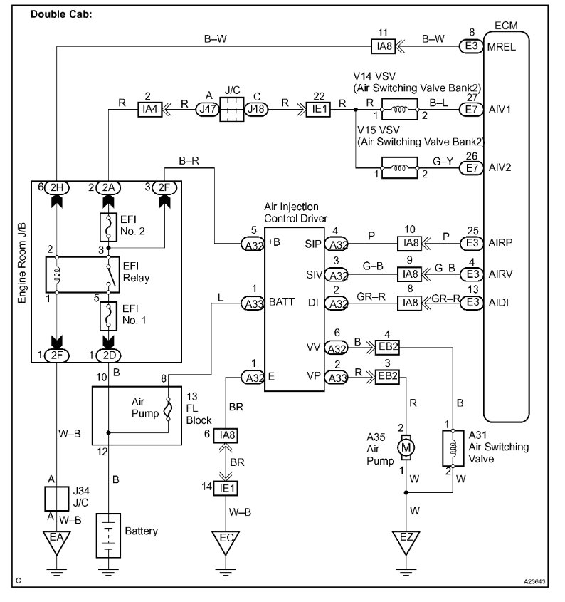

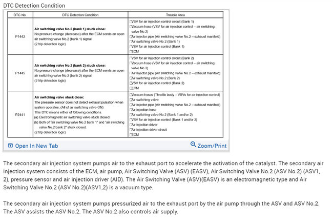

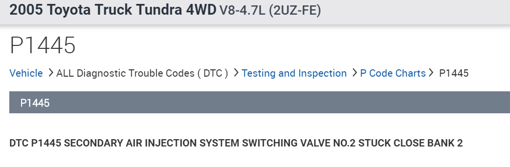

Getting p1445 code. do the bypass kits really work and how do I get one?
Feb 13, 2019 at 3:52 PM
SCGRANTURISMO
  • 4,897 POSTS

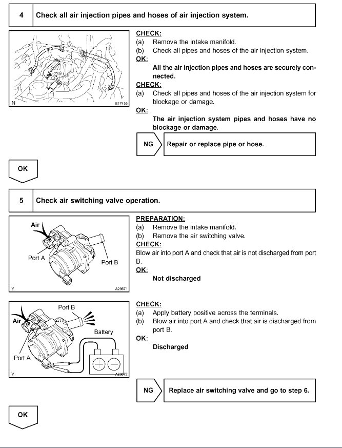

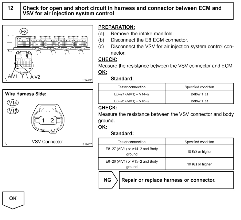

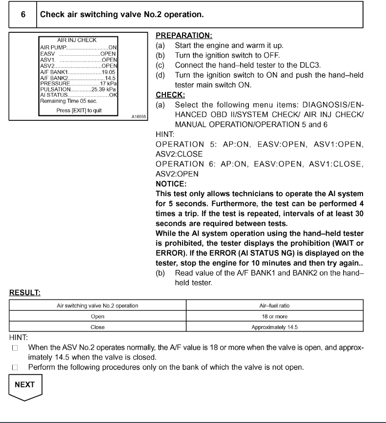

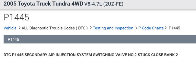

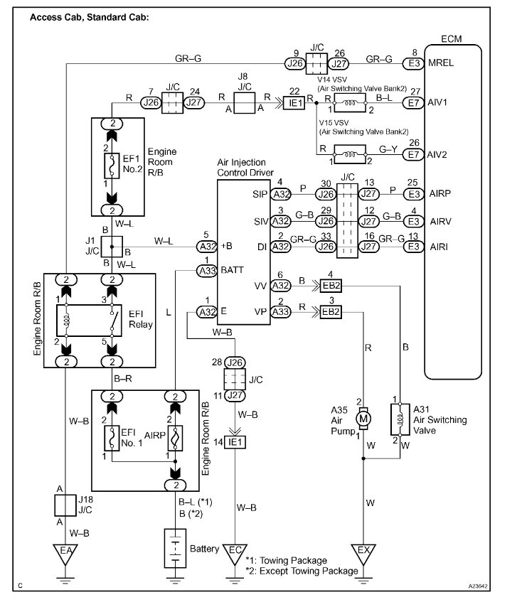

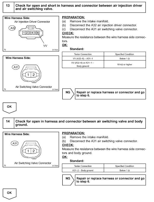

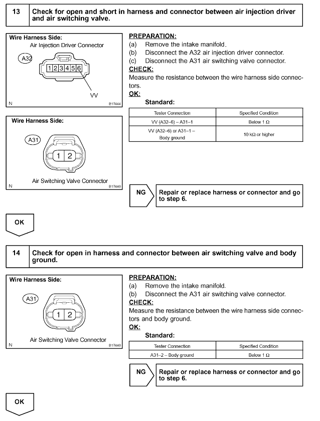

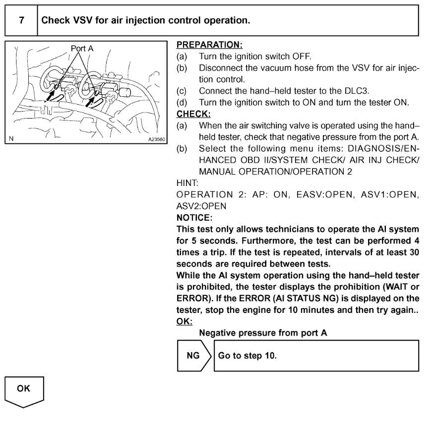

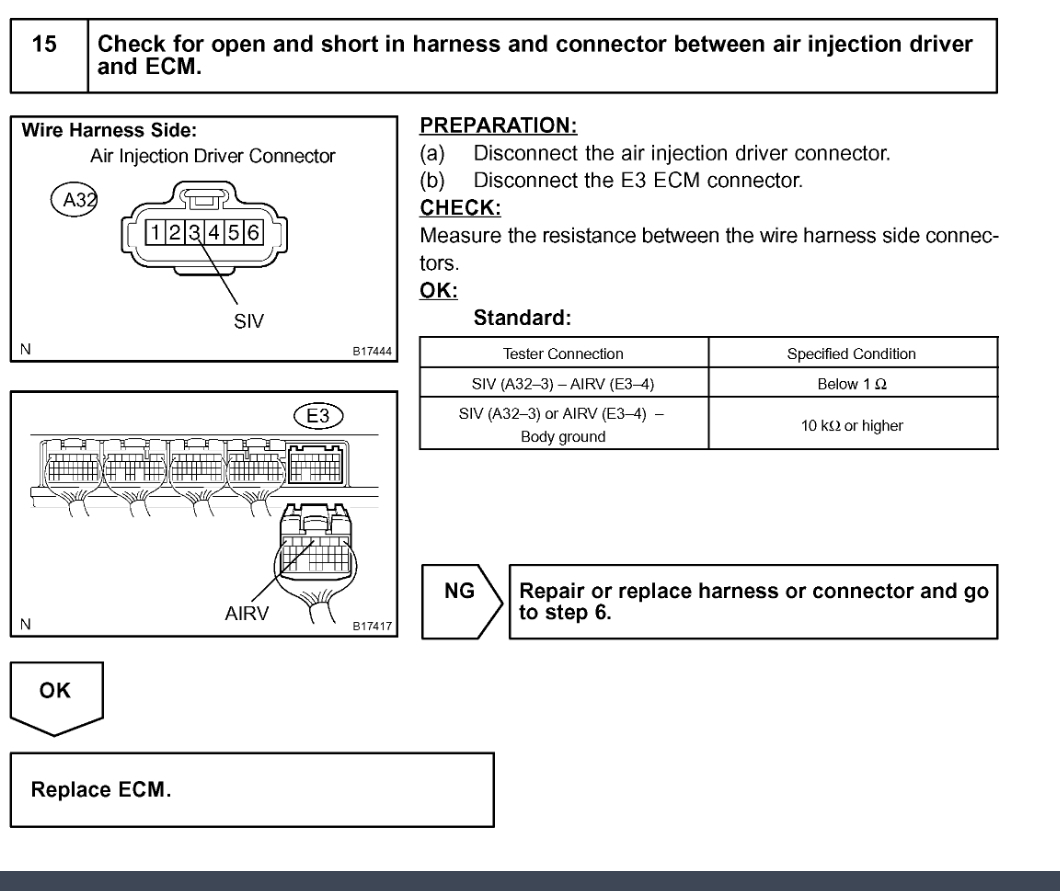

Hello, Direct Trouble Code(DTC) P1445 is secondary air system switching valve #2 stuck closed bank two. I have included a step by step flowchart, description of dtc, and wiring diagrams in the diagrams below. Please go through the troubleshooting flowchart and get back to us with what you find out.
Thanks,
Alex
