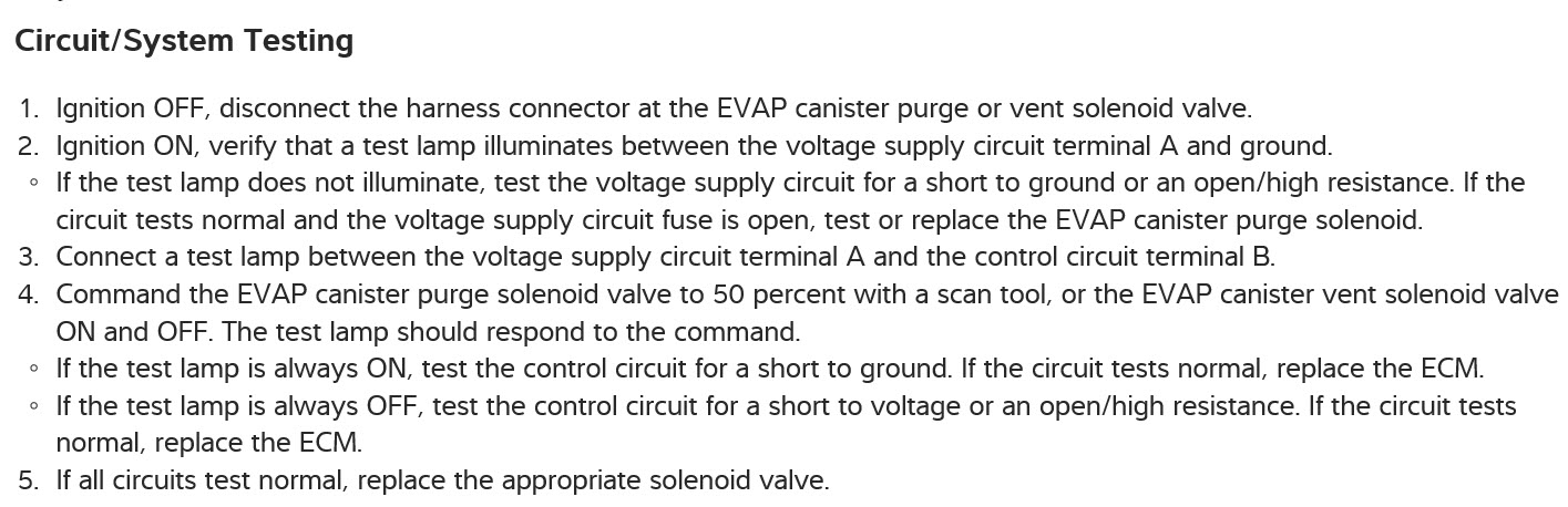

You either have a bad connection or short to ground which can be in the wire or ECM. See picture for instruction on how to test.
