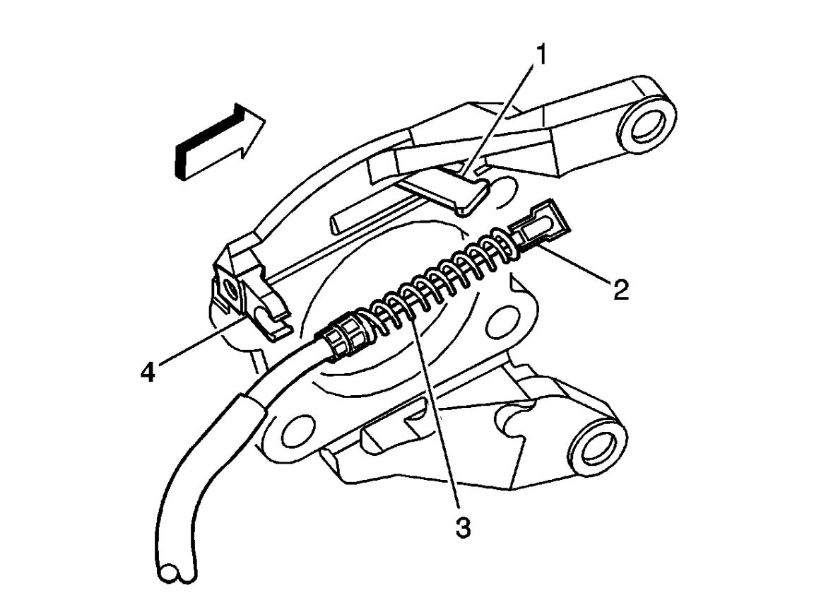

Hi and thanks for using 2carpros.com. I read your question and I believe you are asking how to access the parking brake assembly. That is based on your post. Additionally, you ask about where the parking brake cable attaches. It seems you are already aware that the parking brake shoes are behind the rear brake rotor. Therefore, I have provided the directions to access them. Once you remove the rotor, you will see where the park brake cable attaches. I have limited pictures of the assembly, but I hope they help. First, here are the directions for removal and replacement:

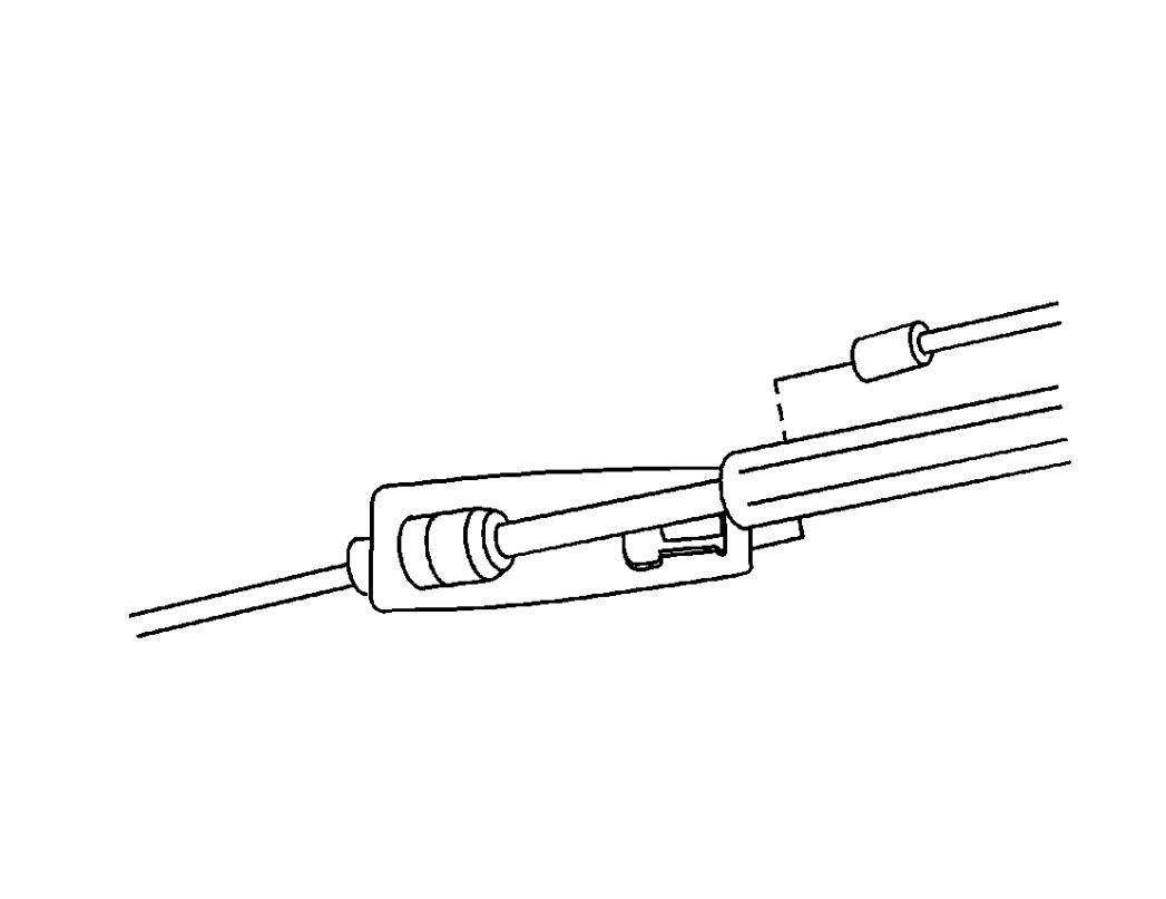

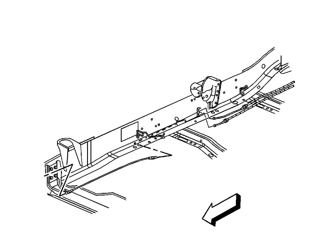

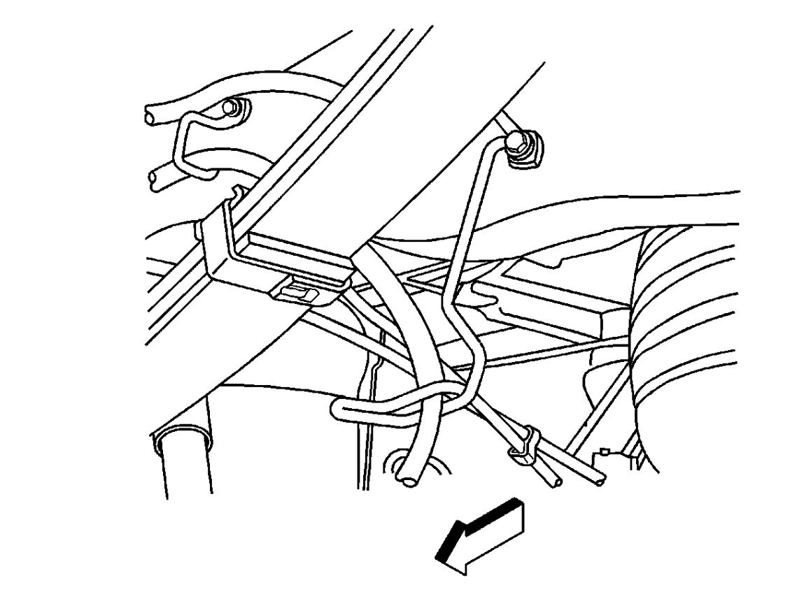

Again, I have attached the few pictures I was able to find regarding replacing the cables
