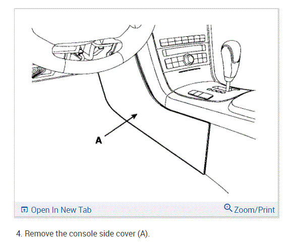

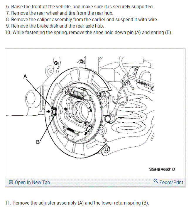

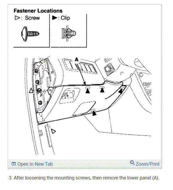

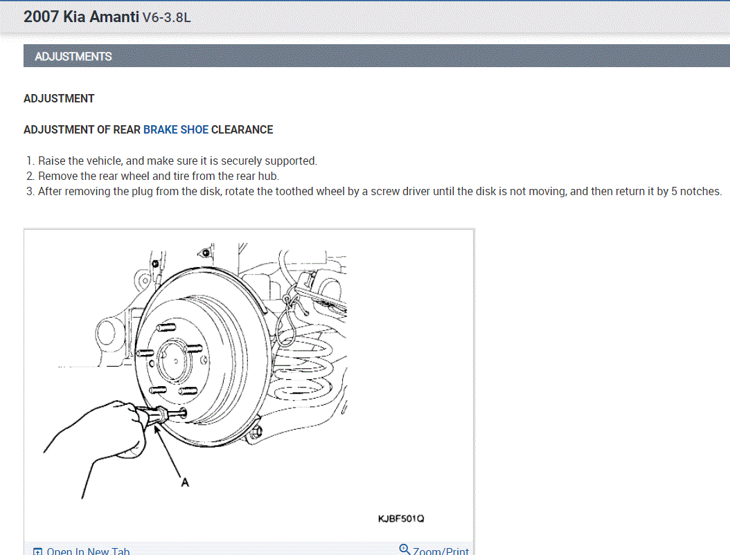

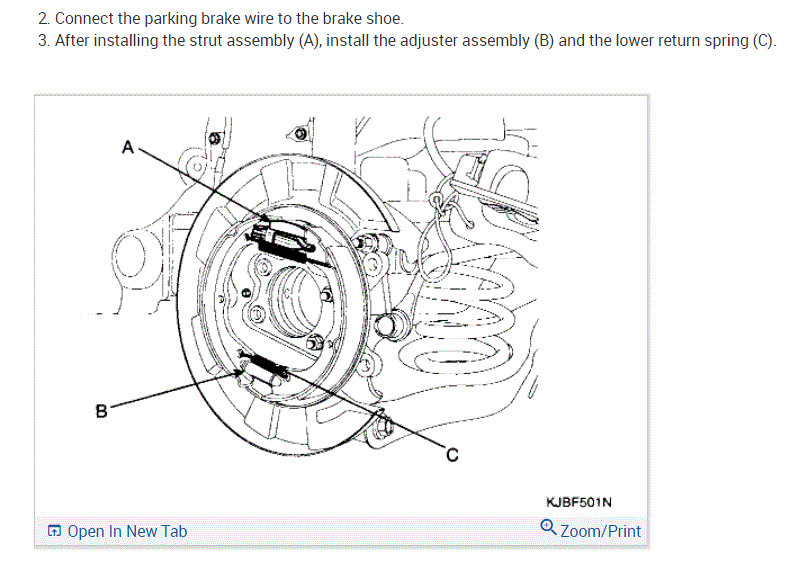

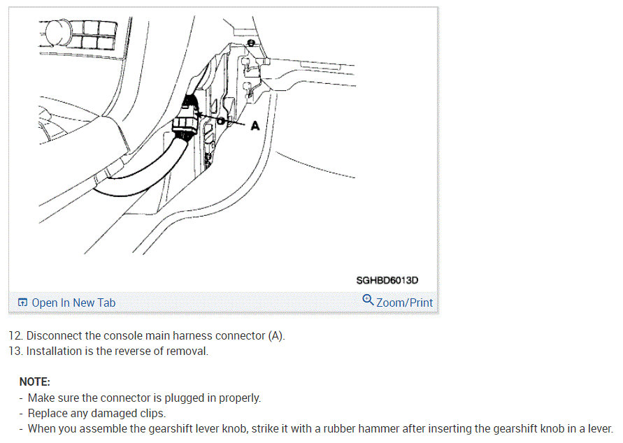

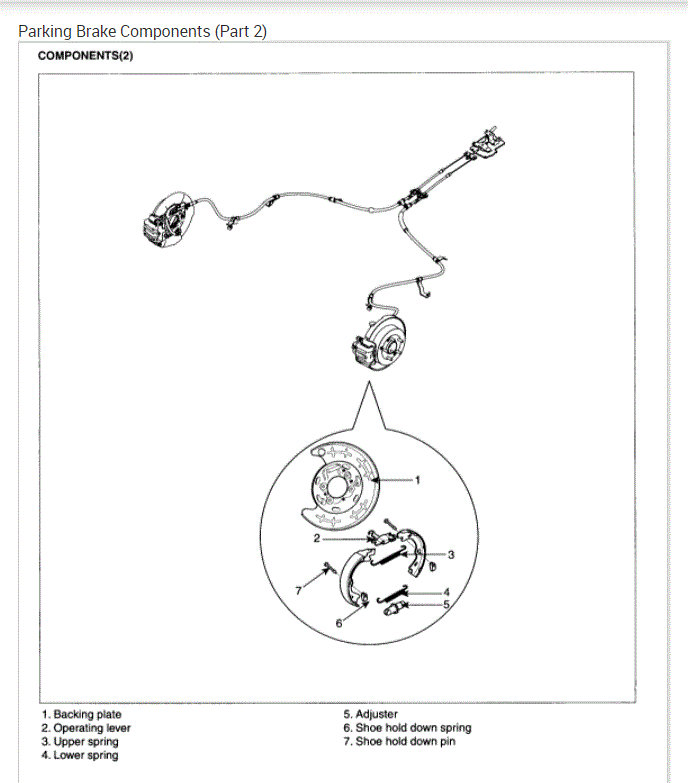

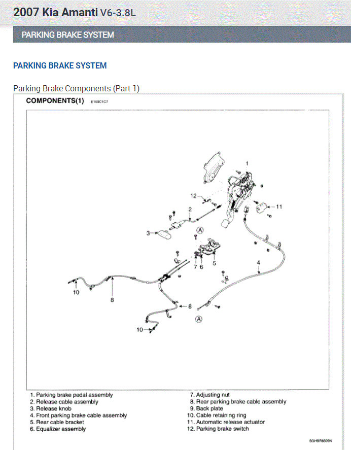

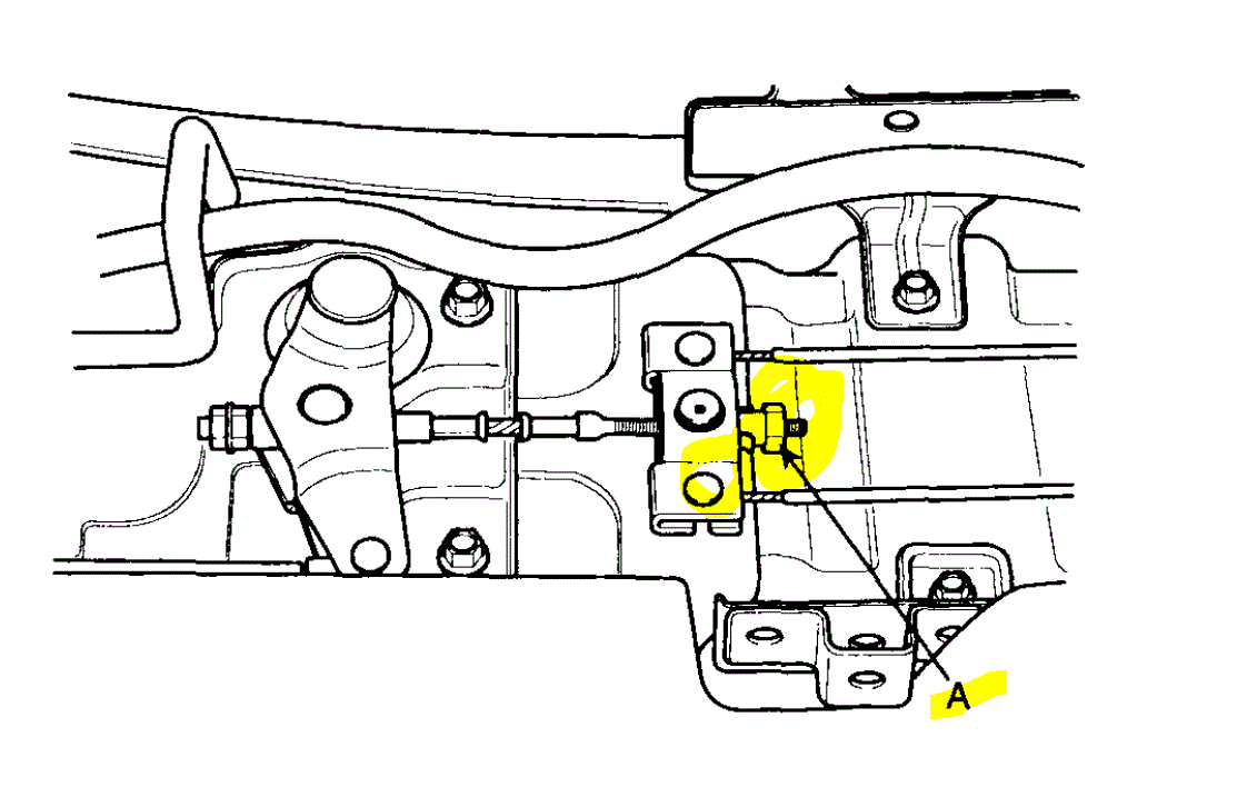

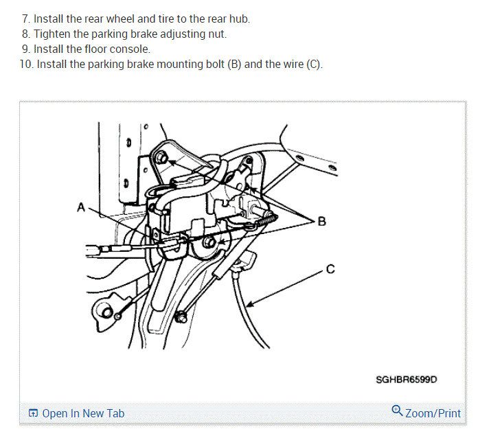

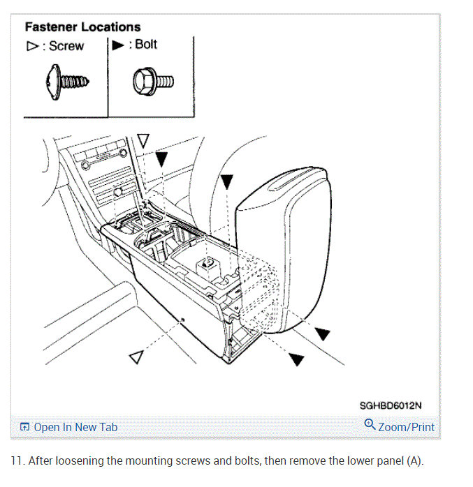

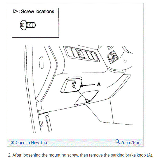

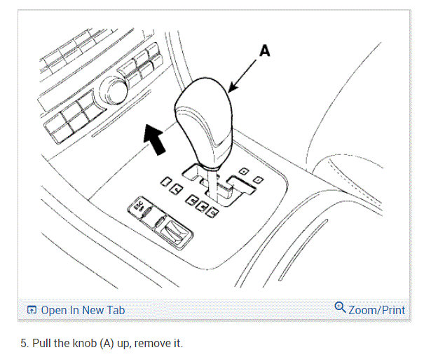

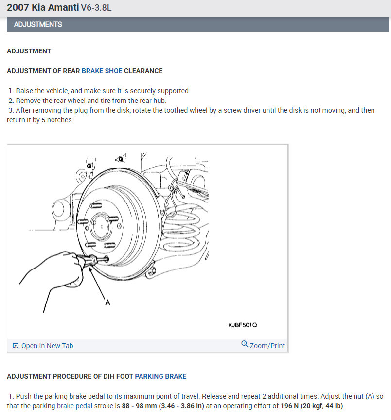

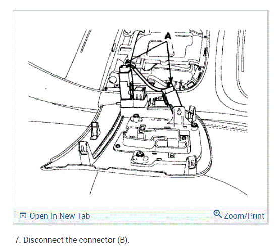

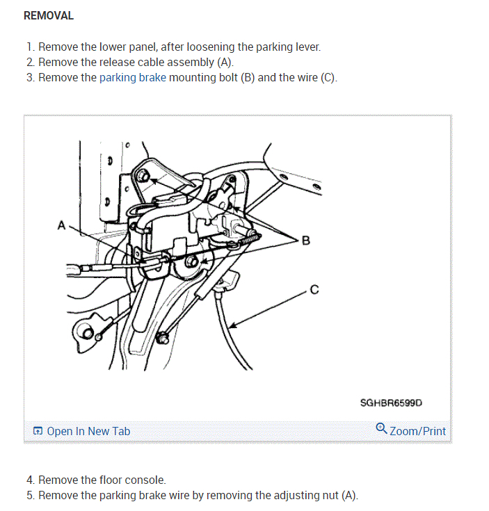

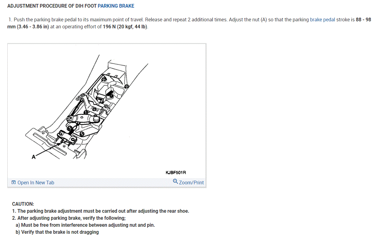

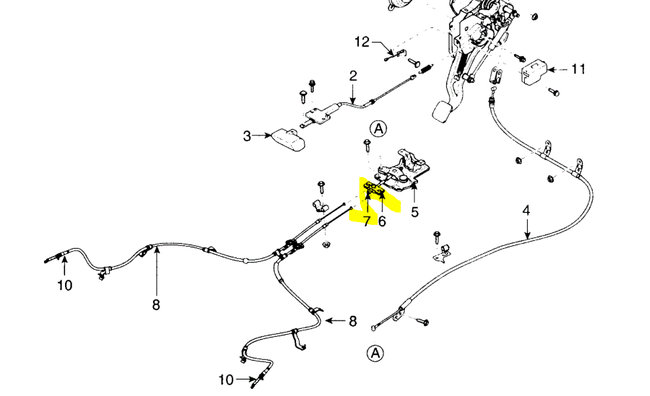

when I press the emergency brake pedal, the car still rolls, even if there is a slight slope. A long time ago I changed the emergency brake shoes, but it didn't fix the problem.
Car rolls, and when I driving sounds are heard from the rear brake rotor. I can guess only its brake cables stretched.

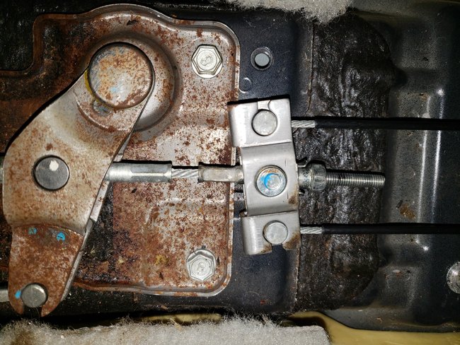

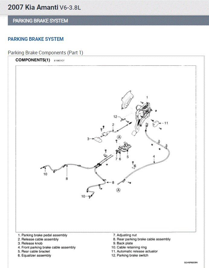

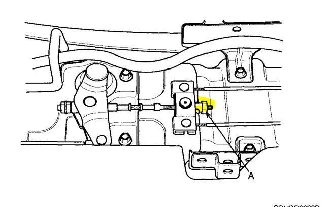

My question is where to start to disassemble brake cables. And check if they really stretched out or not?
