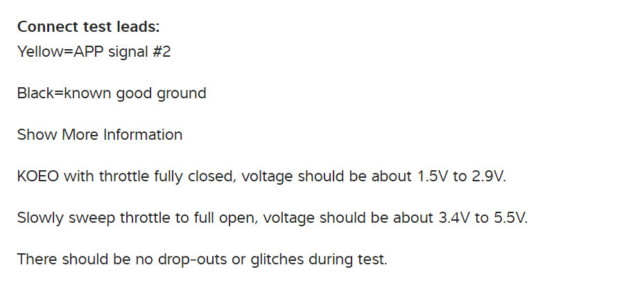

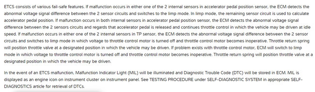

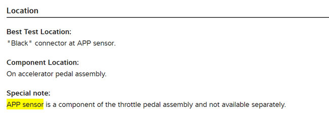

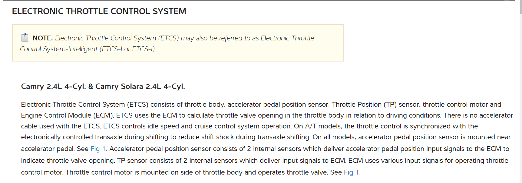

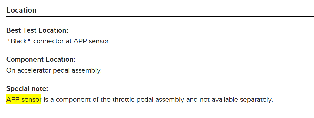

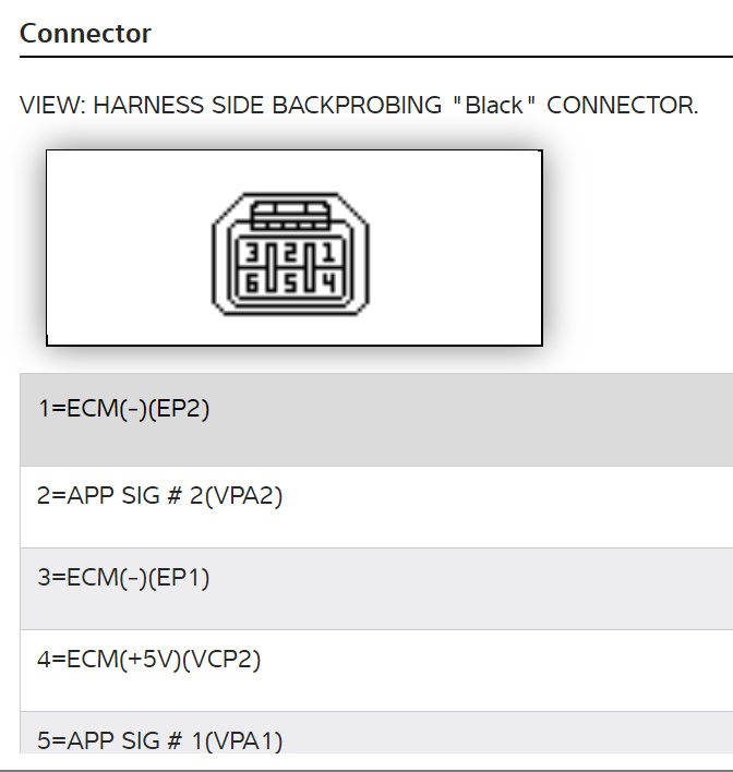

So I left my keys in over night and tried to jump it. it turned over and started I tried to press the gas pedal and there was no pressure going to the accelerator and after a few minutes it just quit running again. so I replaced the battery but it happened again. The air won’t work and the radio won’t turn on but the headlights will come on and the dash lights too. Now it just turns over begins to start then just shuts off every time. I checked all the fuses and the electrical connection on the gas pedal they were all good.
