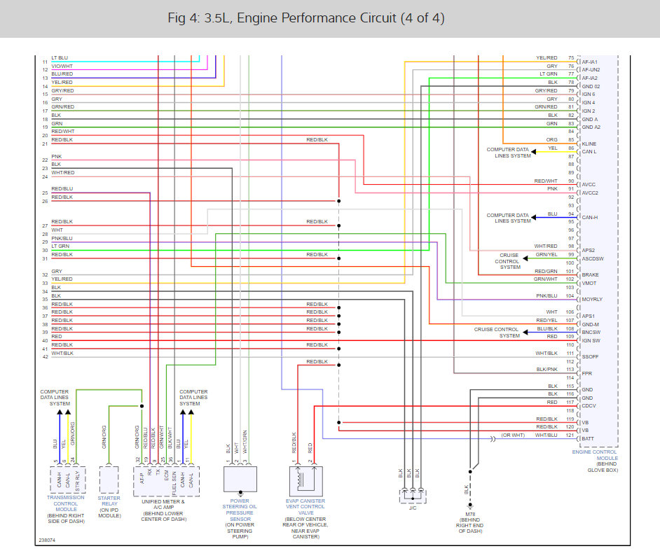

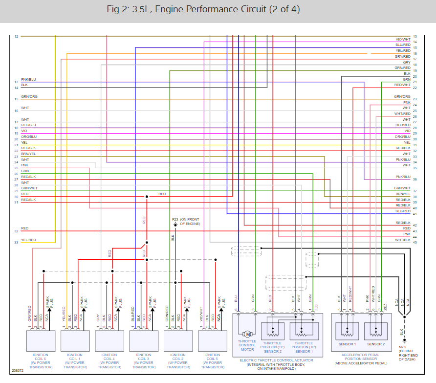

Please can i have a simple diagram procedure using a multi meter to test on ground if a throttle body is still in good condition. Thanks.
Jan 5, 2021 at 8:34 AM

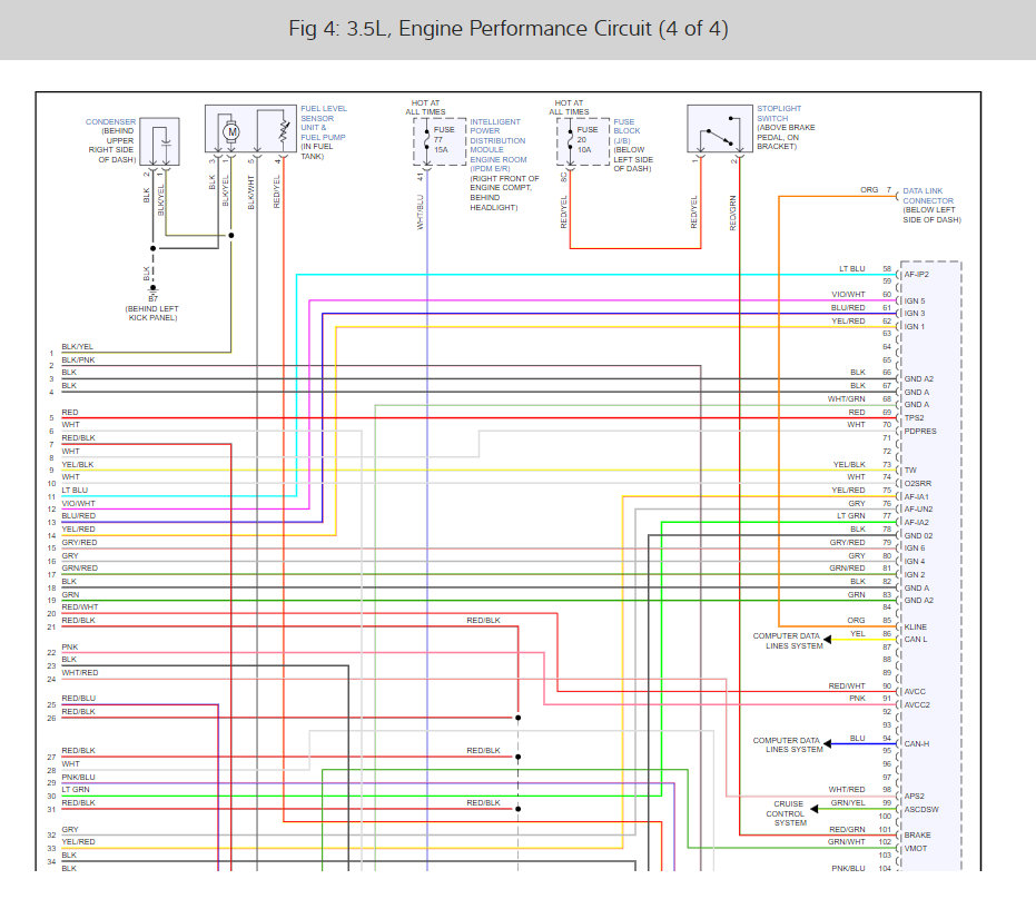

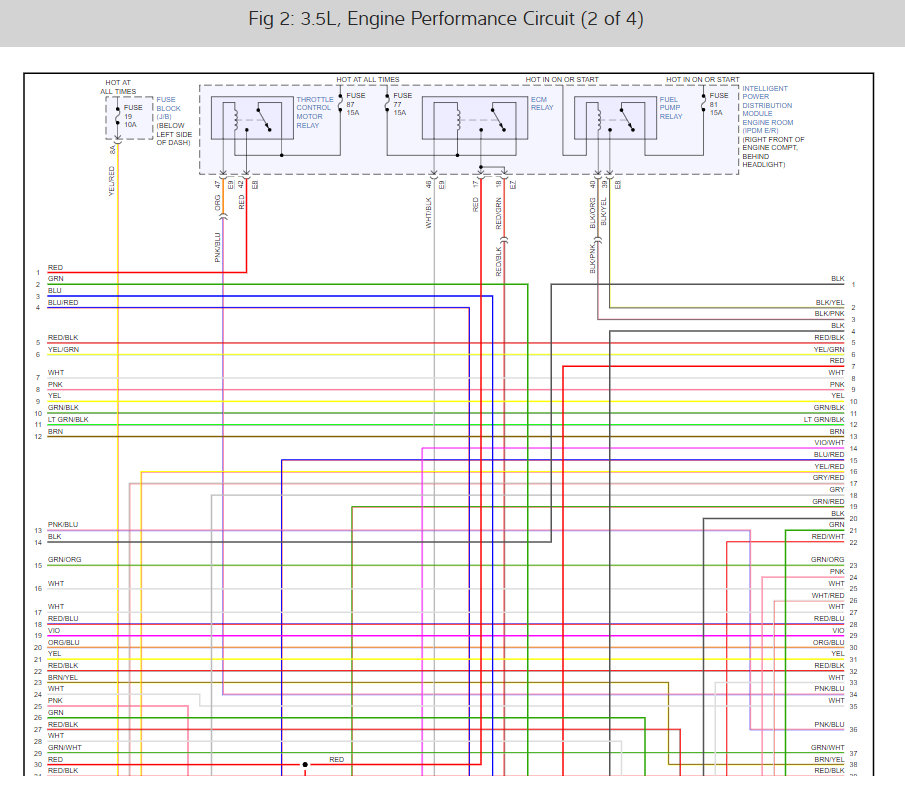

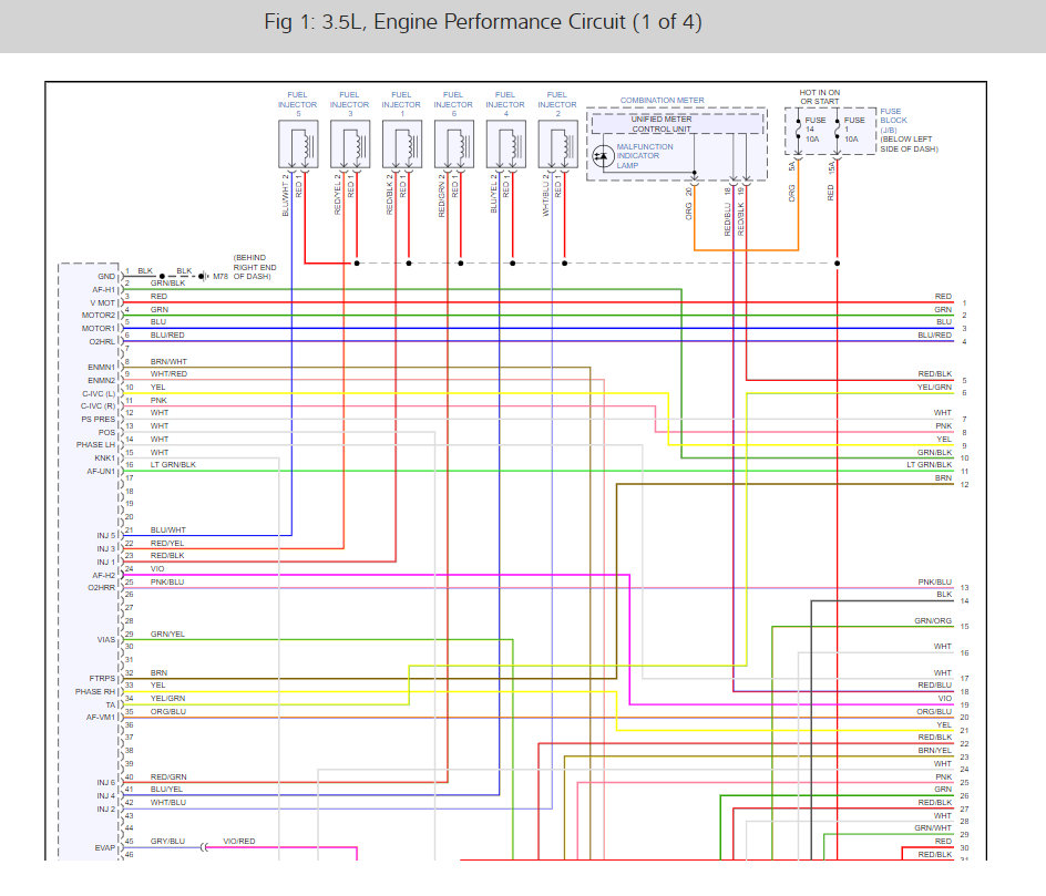

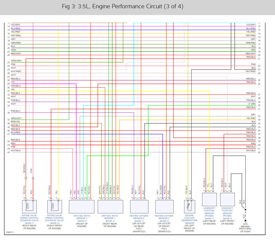

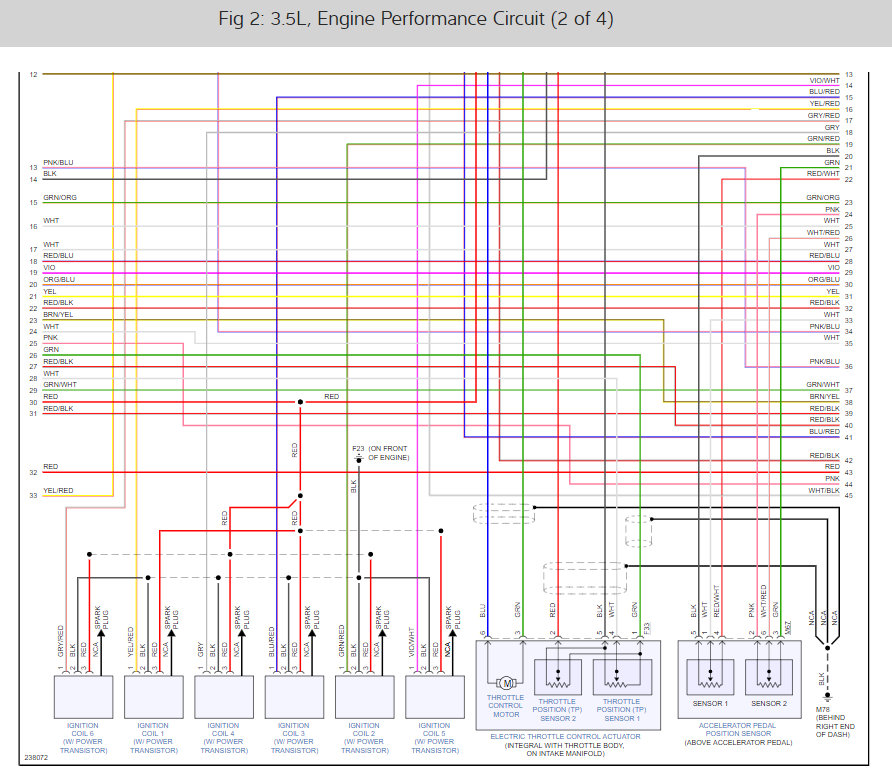

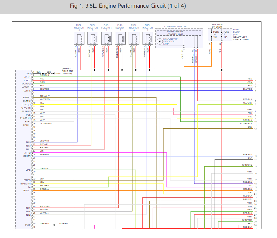

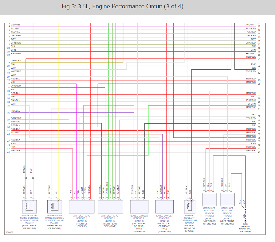

Here is a guide to help you test the ground, power and connections of the throttle body. I have included the complete engine wiring diagrams so you can see how the system works (below).
