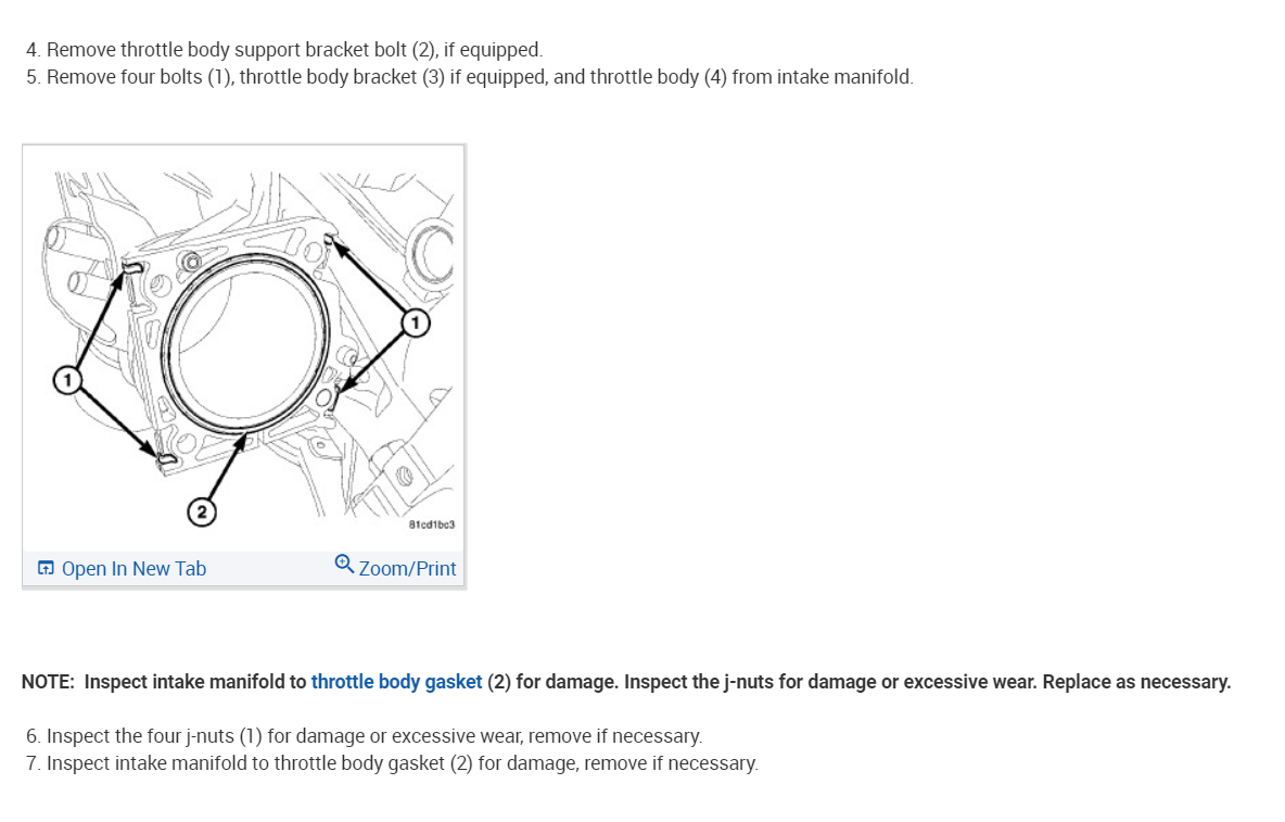

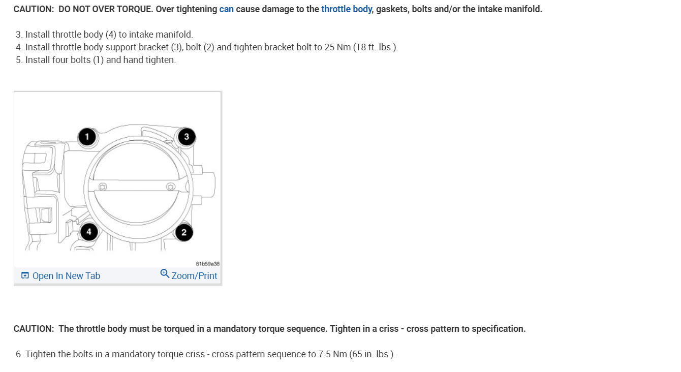

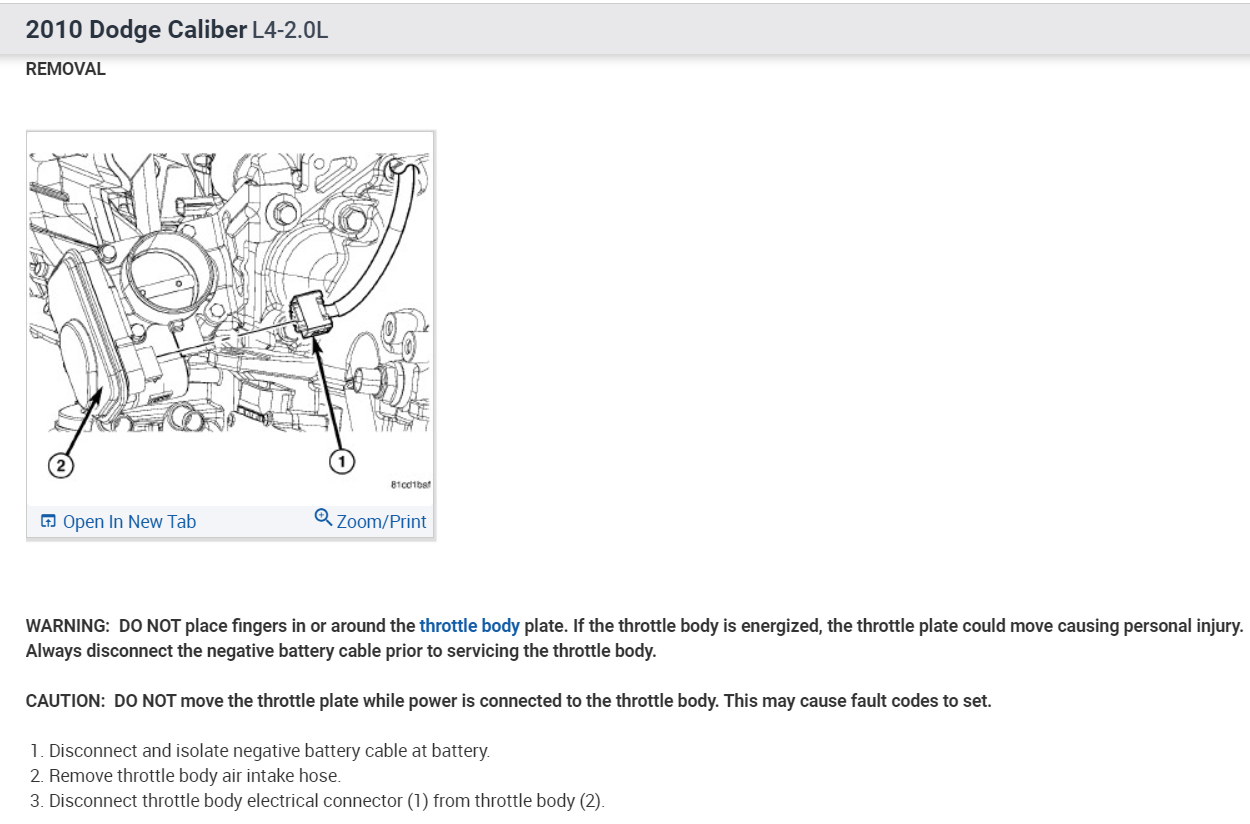

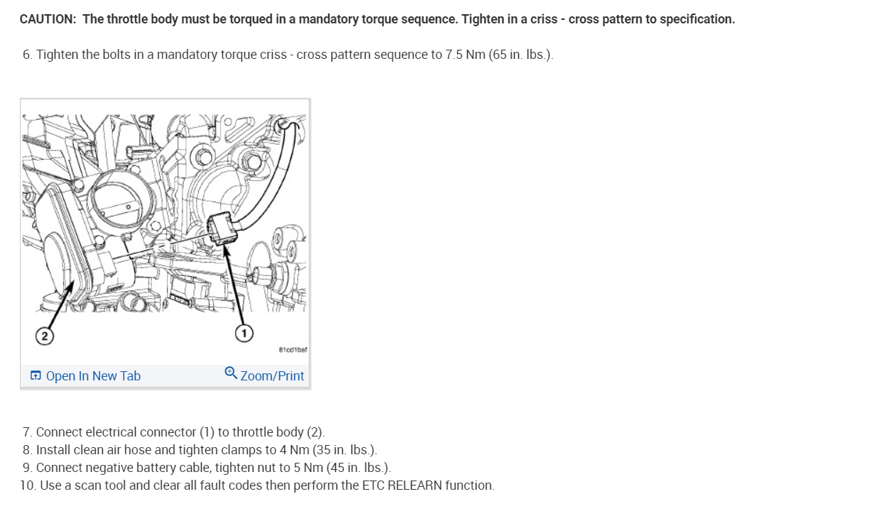

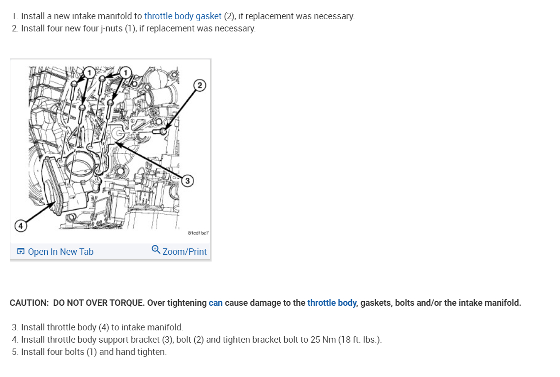

It sounds like you have a defective electronic throttle body. Was it an OEM replacement? We should run the codes to see what comes up.
Here is a guide to help:

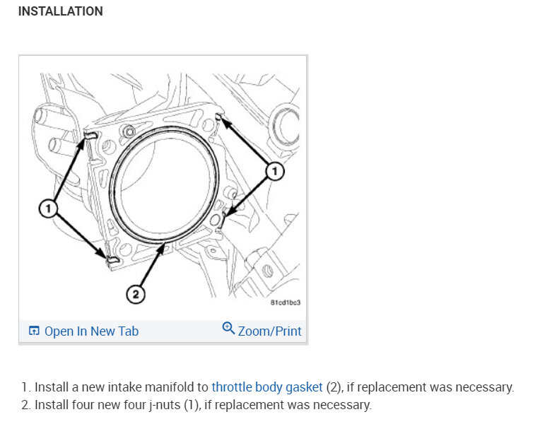

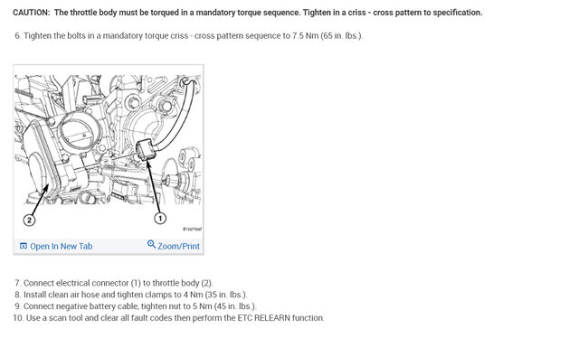

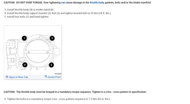

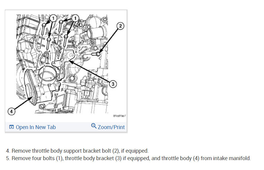

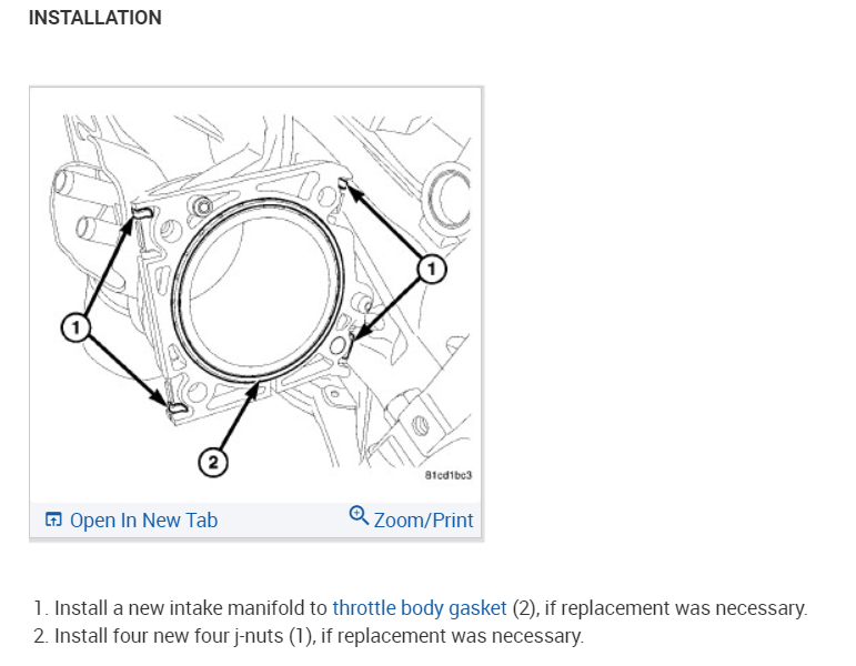

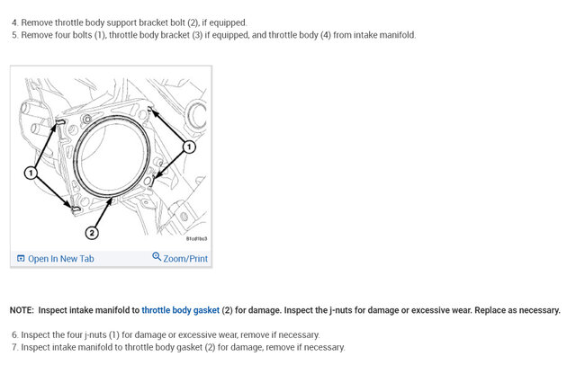

Here is the instructions on how to replace the throttle body in case you need them. Check out the images (below). Please let us know what happens.
