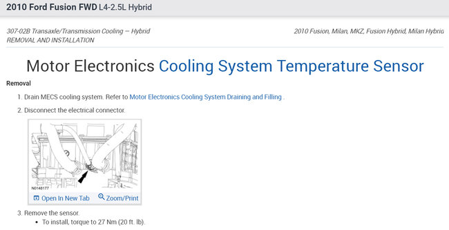

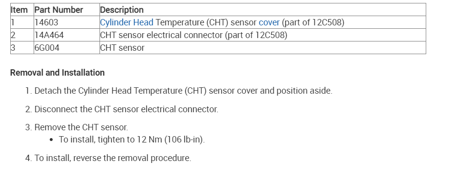

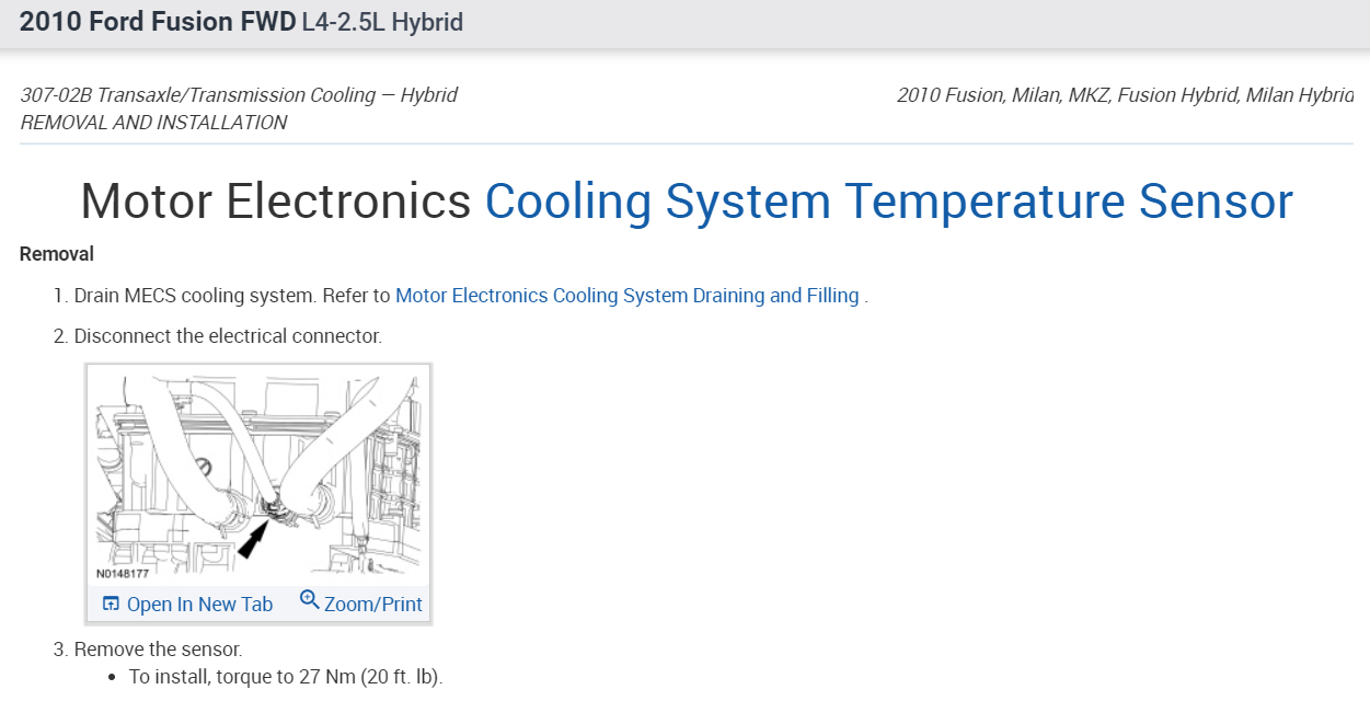

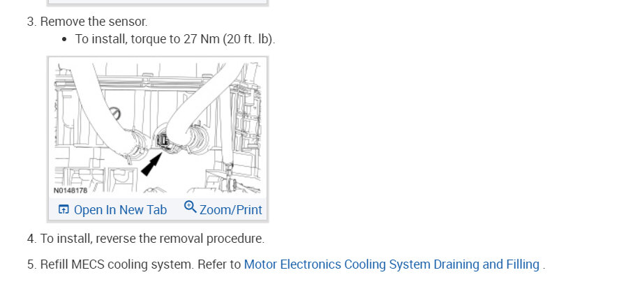

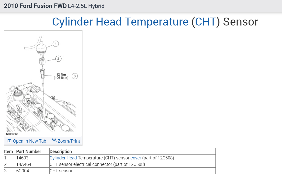

I'm looking for the location of the Electronic Coolant Temperature Sensor (Part# 3F1Z-12A648-A) and I believe it's the sensor for the auxiliary motor/Electric.
Jul 31, 2023 at 8:07 PM
Here are both coolant temperature sensors so there is no confusion on the location of the sensors. Check out the images (below). Please let us know if you need anything else to get the problem fixed.
Aug 1, 2023 at 12:43 PM
