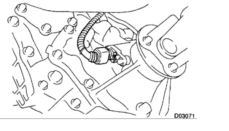

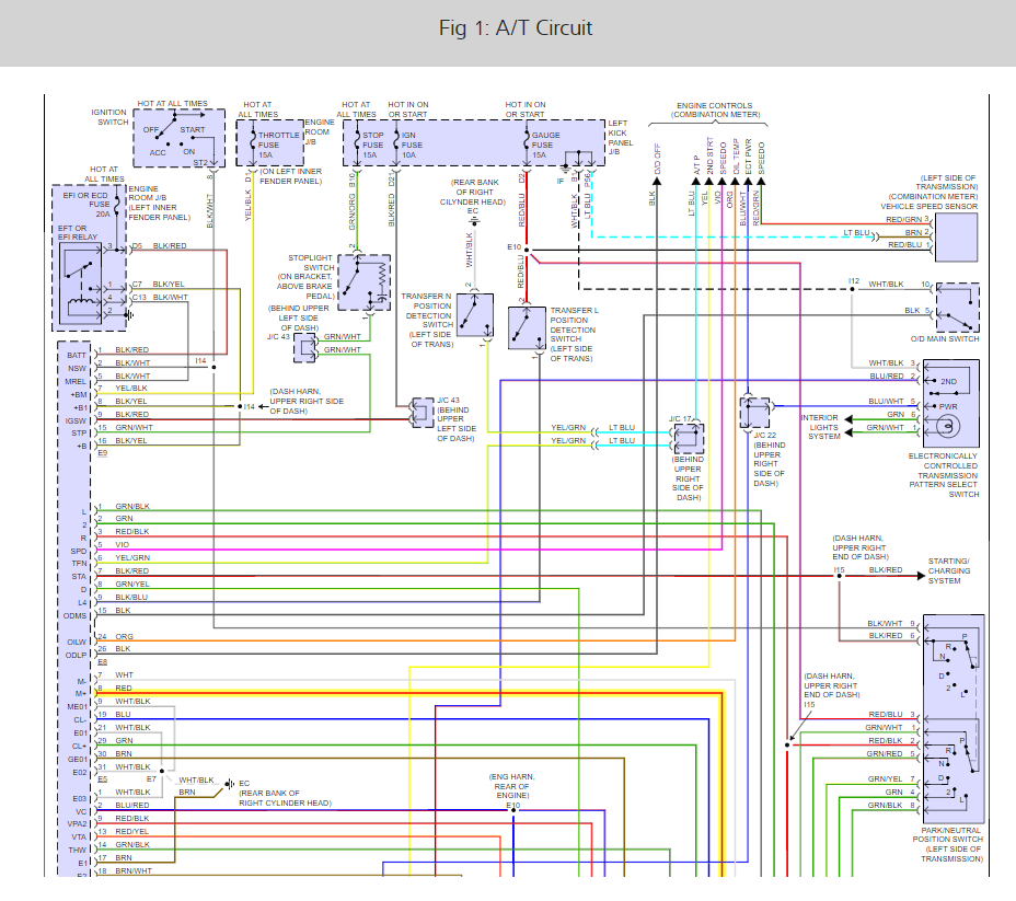

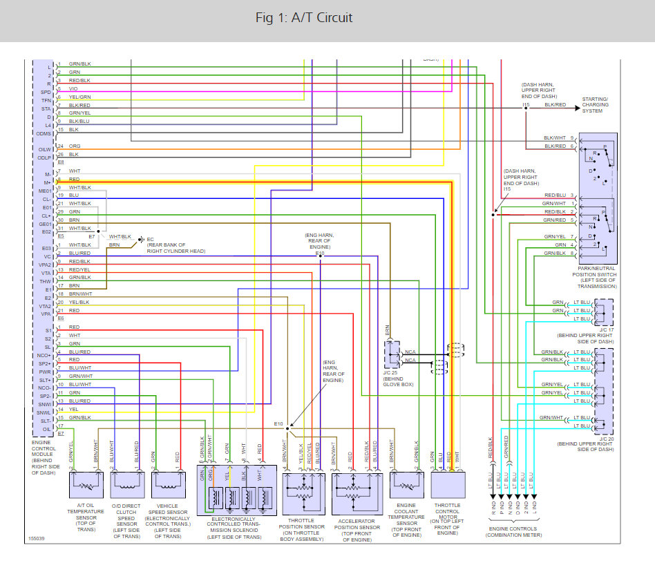

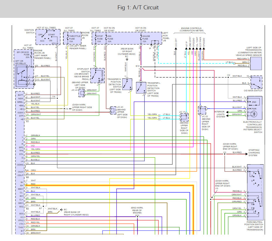

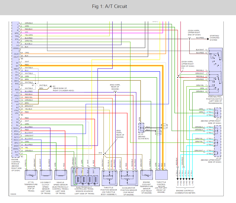

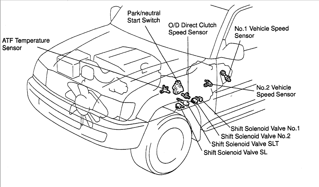

It sounds like you have a shaft speed sensor that is going out. Here is the locations so you can check it out. Also the shift solenoid could be shorting out as well. Here is a transmission wiring diagrams so you can check signals to the shift solenoids.
and
Please run some tests and get back to us.
