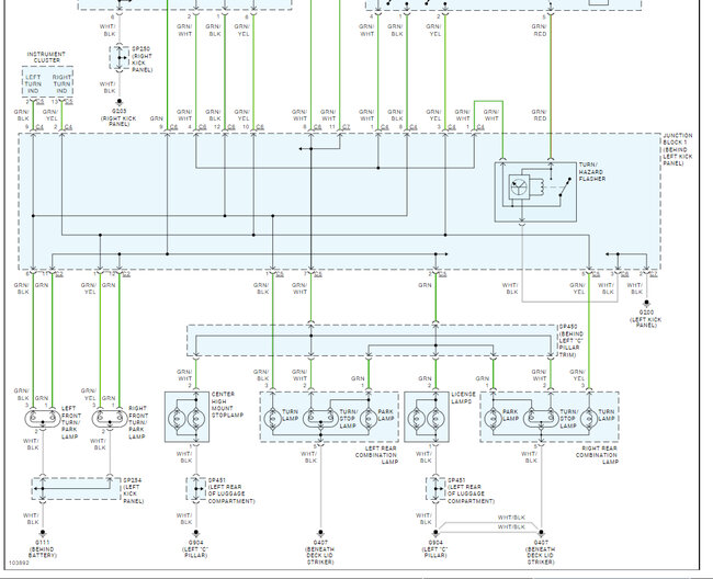

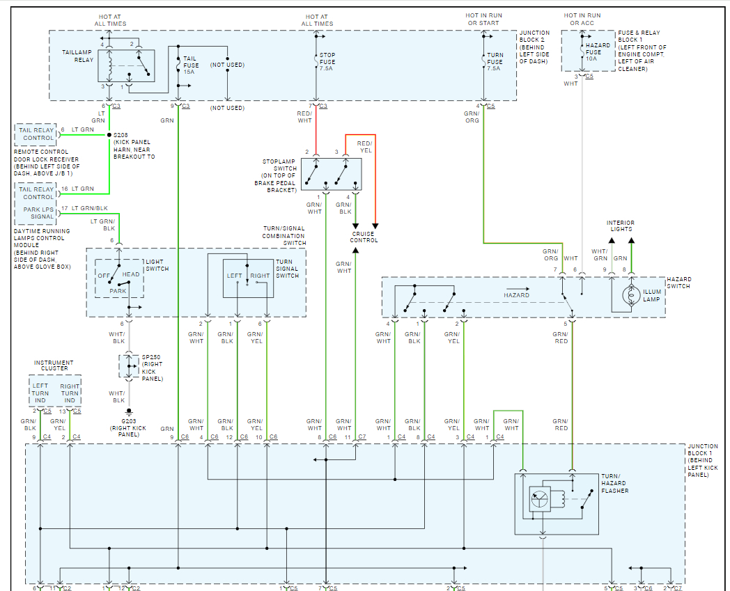

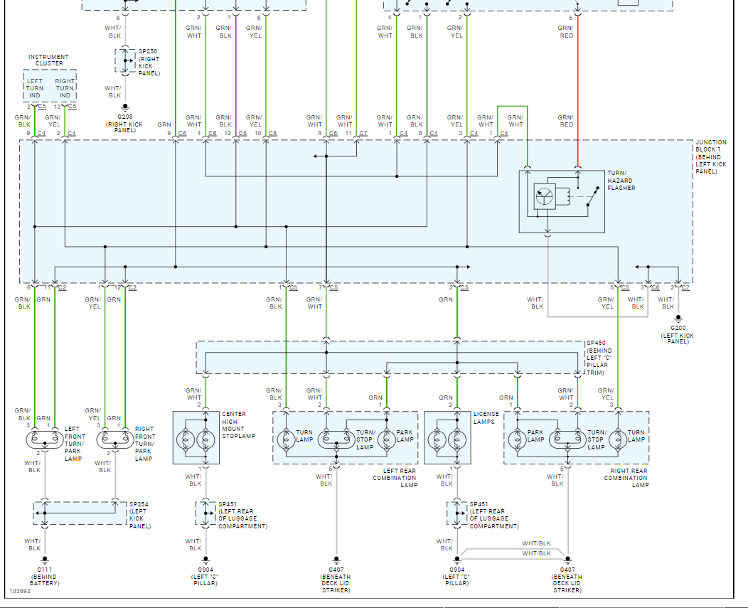

Here is the wiring diagrams for the running light system so you can see how it works. Check out the images (below). Please let us know what happens.
