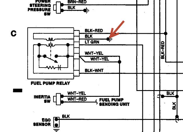

check your black red wire going to fuel pump relay to see how much volts you have. you rproblem may be you removing inertia switch and I don't know why you did that as it s' a safety device. then check to see how much power to pump. also check yoru ground to the relay as that may be the problem as well.

Thanks for the repsonse. Good idea to check the ground wire. I will do that today. Do you know if that ground is supposed to be the same as the Chassis ground (- battery lead)?
The supply voltage at the fuel pump relay varies from 5 to 10 volts with or without the relay plugged in. I'm unsure of the wire colors, as I have yet to disassemble the termination block. I'm afraid that might be the next step. I would like to find where that source voltage comes from first, however, and avoid tearing into that block.

I forgot to send the pic the blkred comes from the ignition switch through the starter interlock switch so you will have to go back from there. black is ground , lt grn goes to fuel pump tester plug and air tempsensor and whtyellow goes to inertia switch then to pump. but you may have a bad ignition switch lead or something not making good connection there.

As hmac300 notes, the supply for the fuel pump relay comes from the ignition switch. It also goes through the 15 Amp 'Engine' fuse. The ignition switch tested good with very little resistance through the contacts. The 15 Amp fuse tested good as well. However, by jiggling the fuse in the holder, I could start the car. And more jiggling could kill it, and cause the voltage to drop to 5-6 volts. Looks like the culprit was a loose connection within the interior fuse block. I didn't attempt to tear that apart, and rather bypassed the fuse block. I found a neat device that holds an automotive fuse with two flying leads. Perfect for this application.
