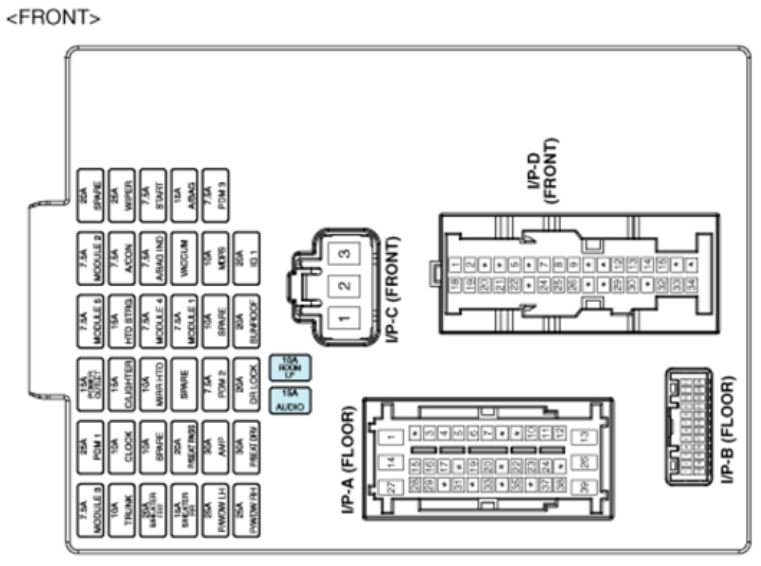

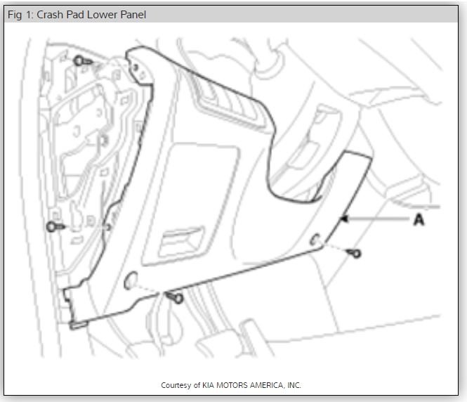

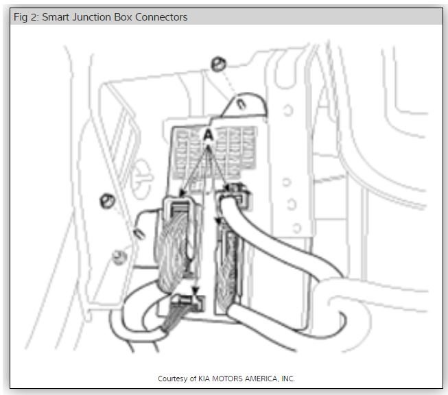

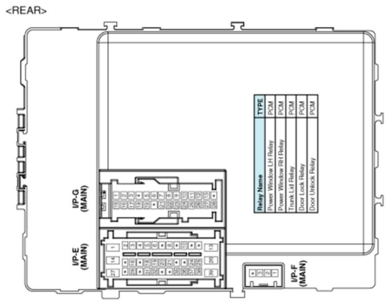

Sounds like relay clicking in under dash fuse panel area. Checked all grounds. Local mechanic replaced main engine fuse box and the problem still exists. Put main fuse box back in and recommended taking to Kia dealer, although when mechanic consulted with Kia, they say this is an odd sounding problem. Anyone else ever had this?
