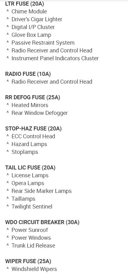

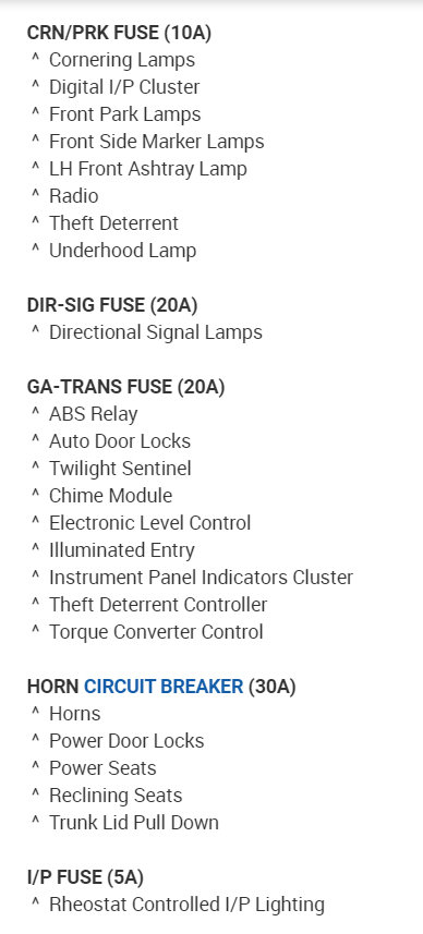

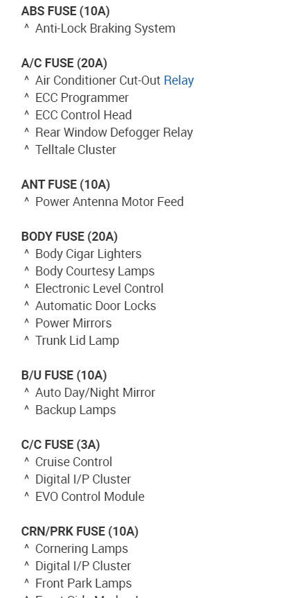

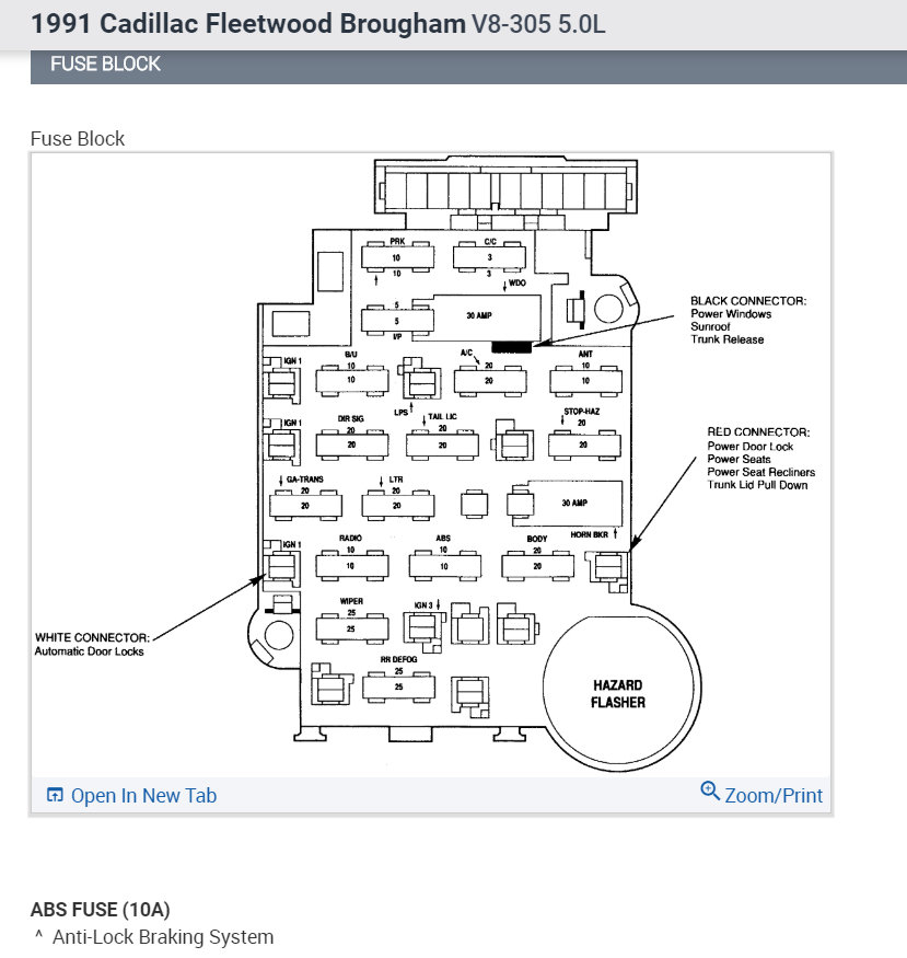

Can you see if you have power at the stop-hazzard fuse? here is a guide to help please test with the key one:
Here is the fuse location ins the diagrams below. Check out the diagrams (below). Please let us know what you find. We are interested to see what it is.

Yes sir it’s has power I tested it and it lit up green , so next I replaced the fuse and still nothing.

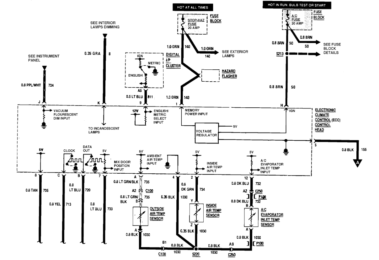

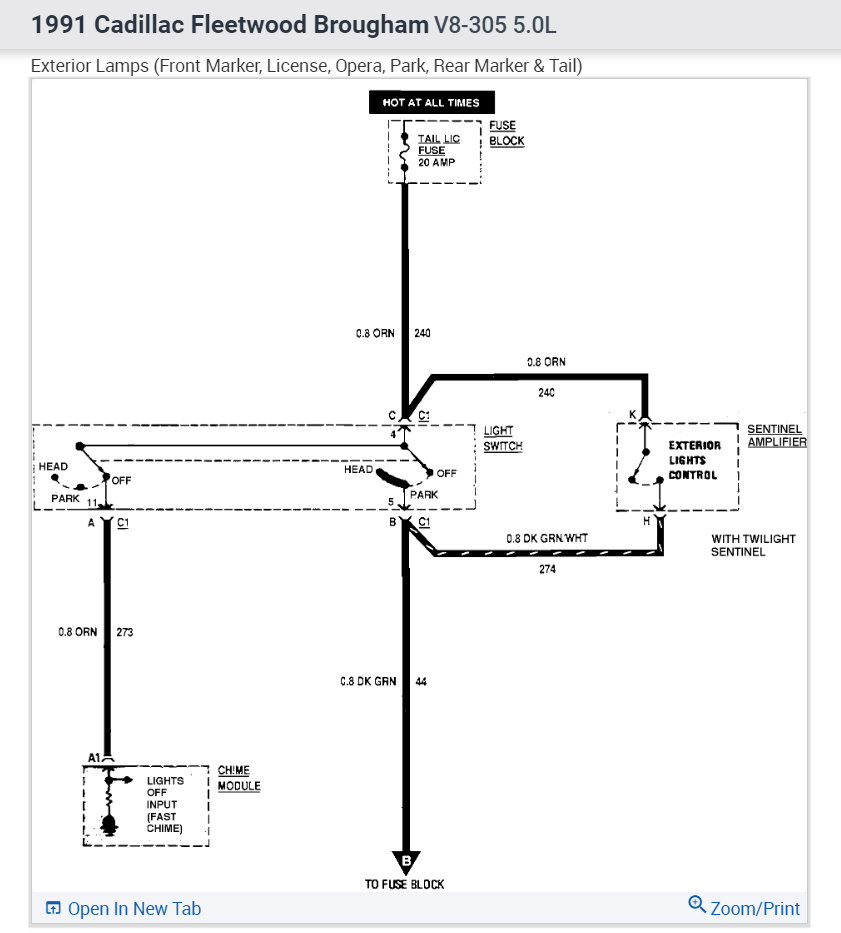

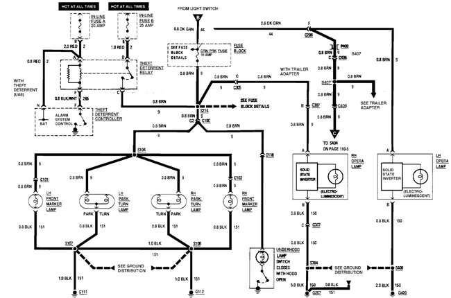

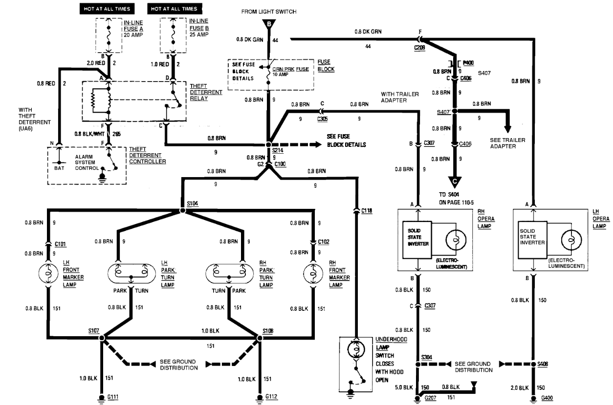

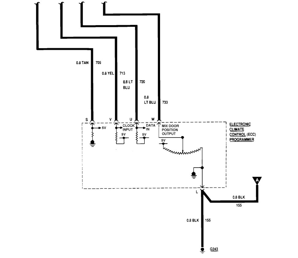

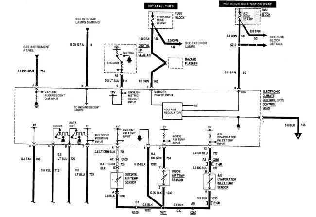

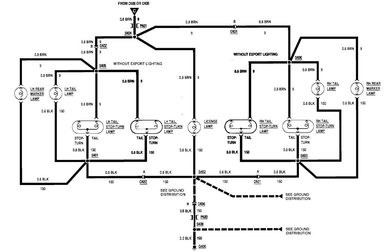

Okay, it sounds like you lost the ground somewhere. here is a guide and the wiring diagrams for the climate control and blinker and brake light systems:

I take that back I miss understood the light tester , so it’s lighting up green meaning it’s grounded and it’s not getting power any solution for this ???

The stop hazard fuse .
Dec 1, 2019 at 2:28 PM
Okay that is powered by fusible links down at the starter. can you inspect the links by pulling on them to see if there are still connected please? Let us know.

Use the wiring diagrams form above to check for power and ground if okay replace the HVAC controller.
