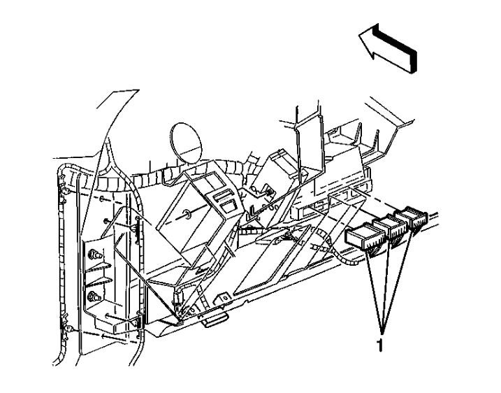

The one thing that all these components have in common is the body control module.
It is very possible you may have a bad connection or the actual module is the issue. If you have a scan tool, you could monitor the operation of the module and see if any codes are stored in the module.
It is under the drivers dash. I attached a picture for you to view.
