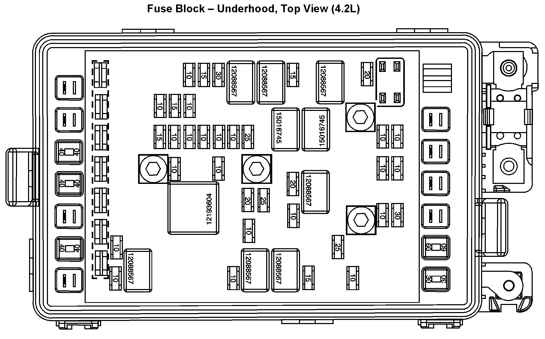

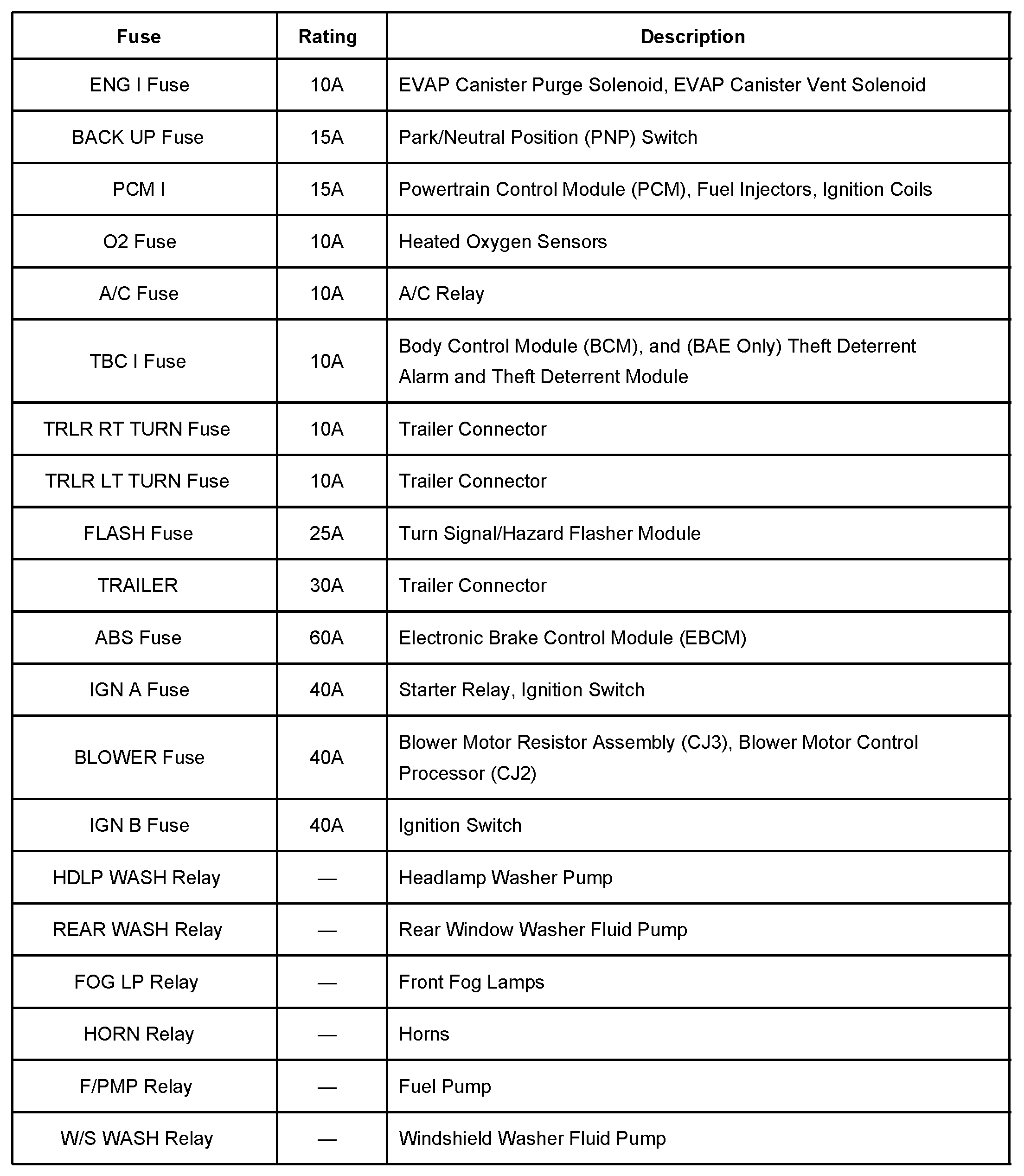

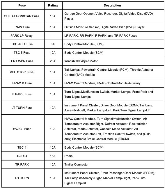

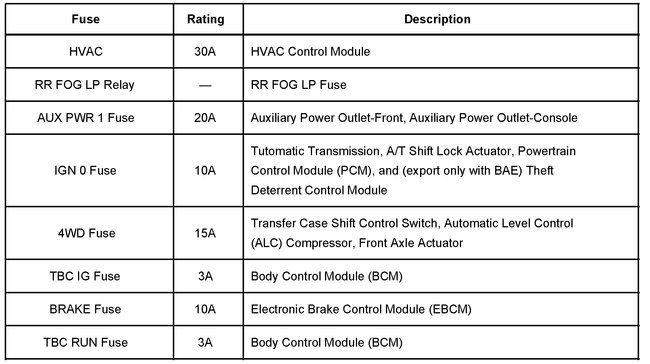

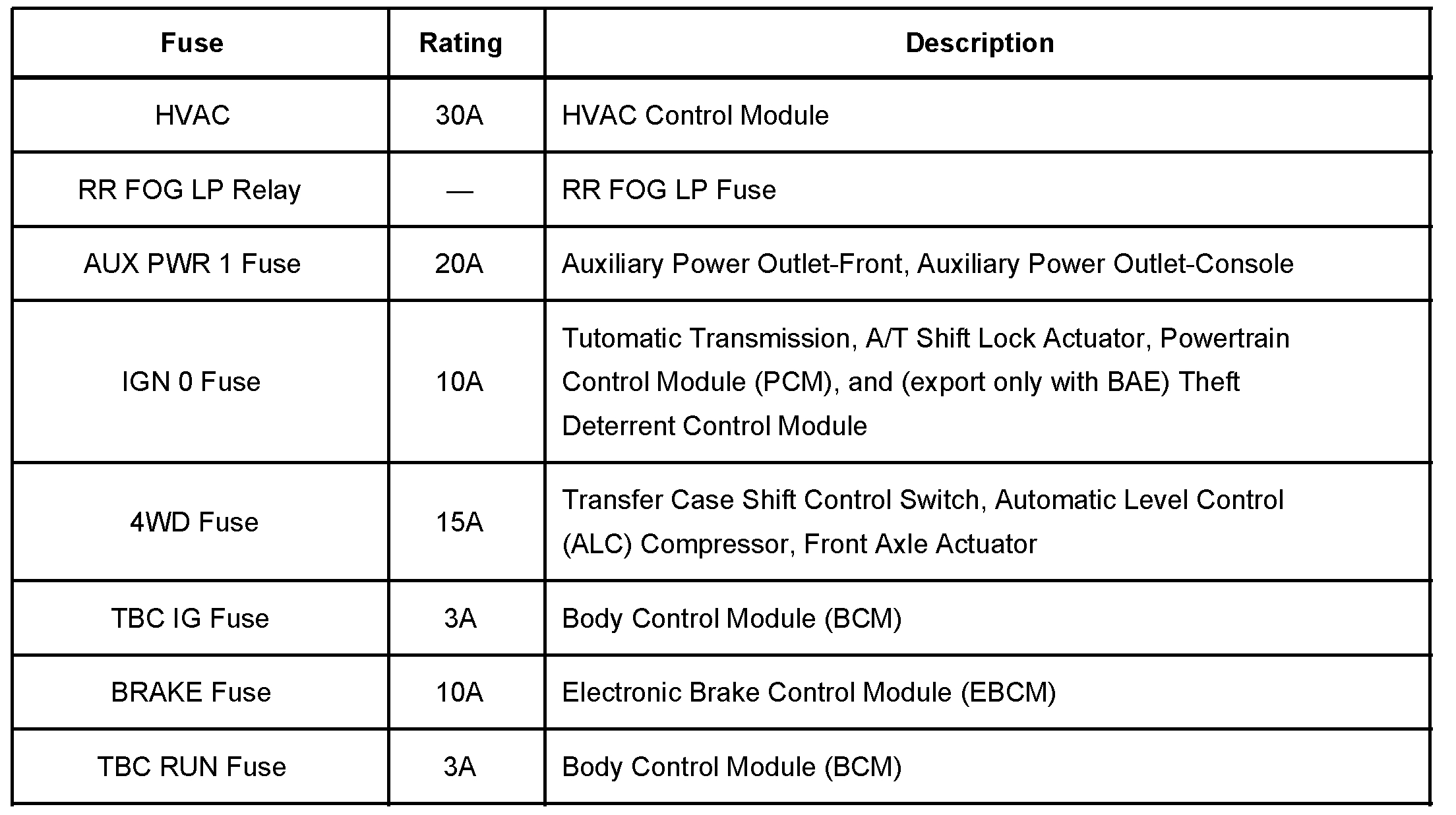

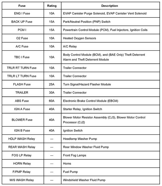

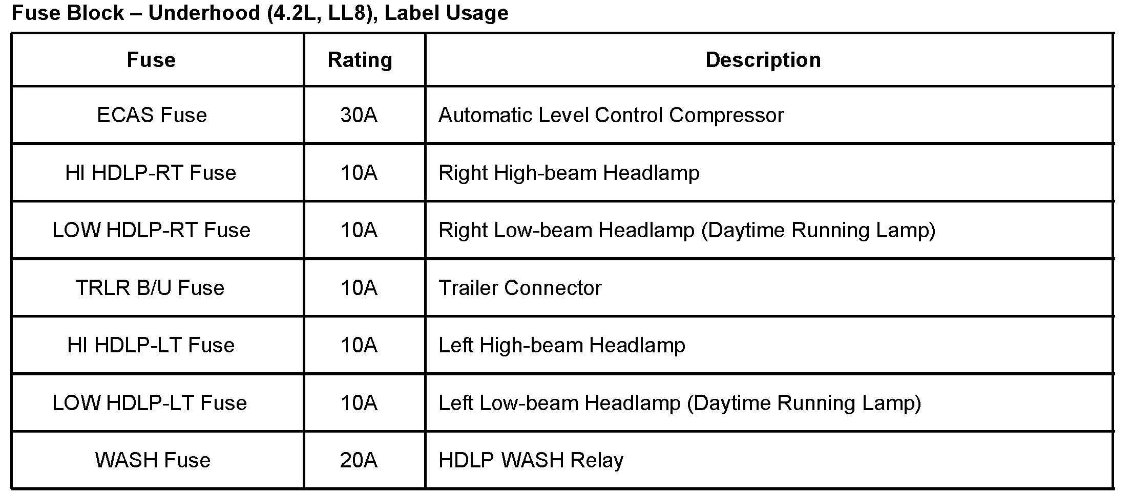

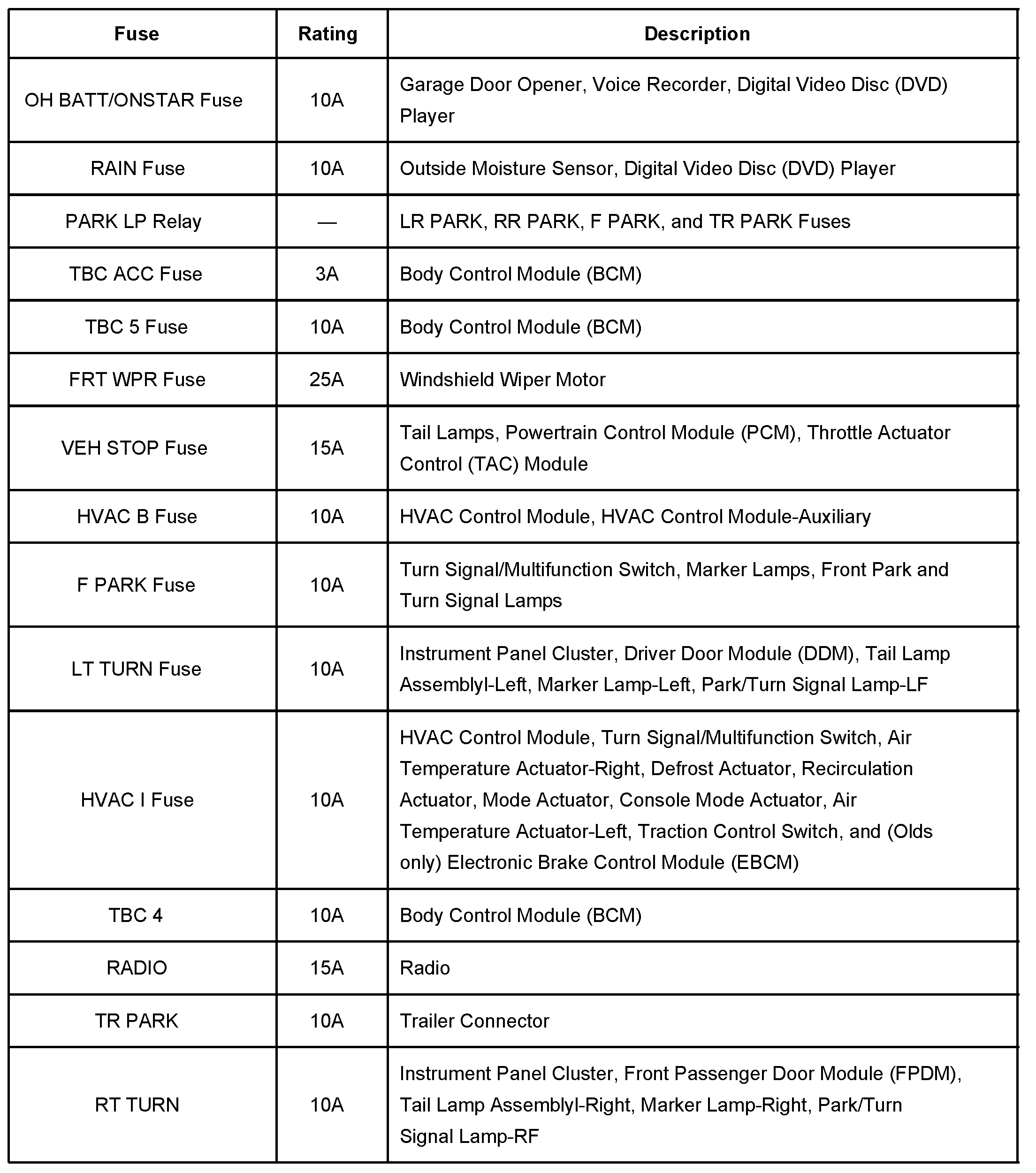

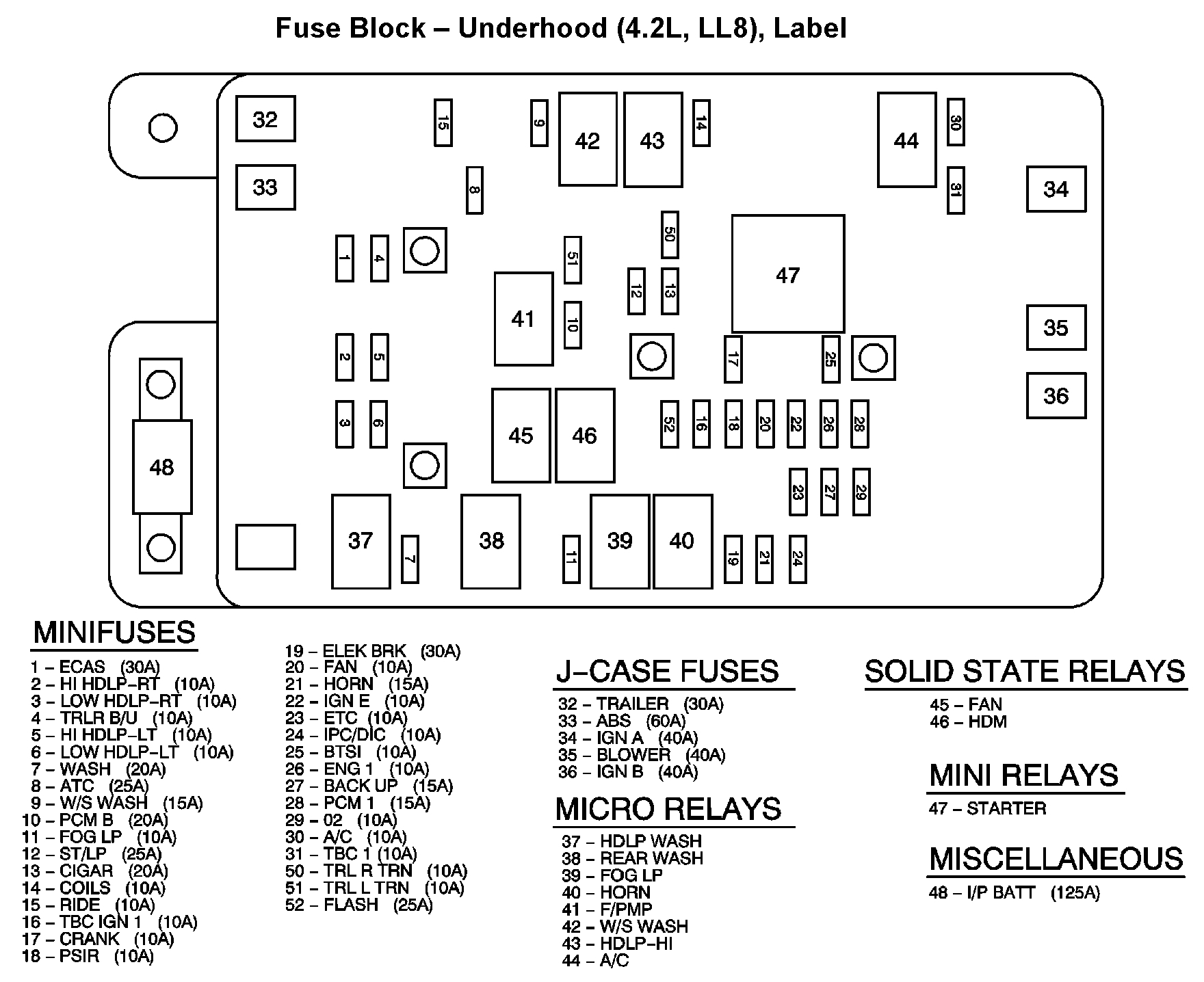

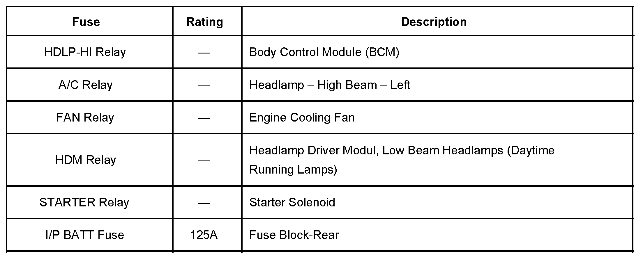

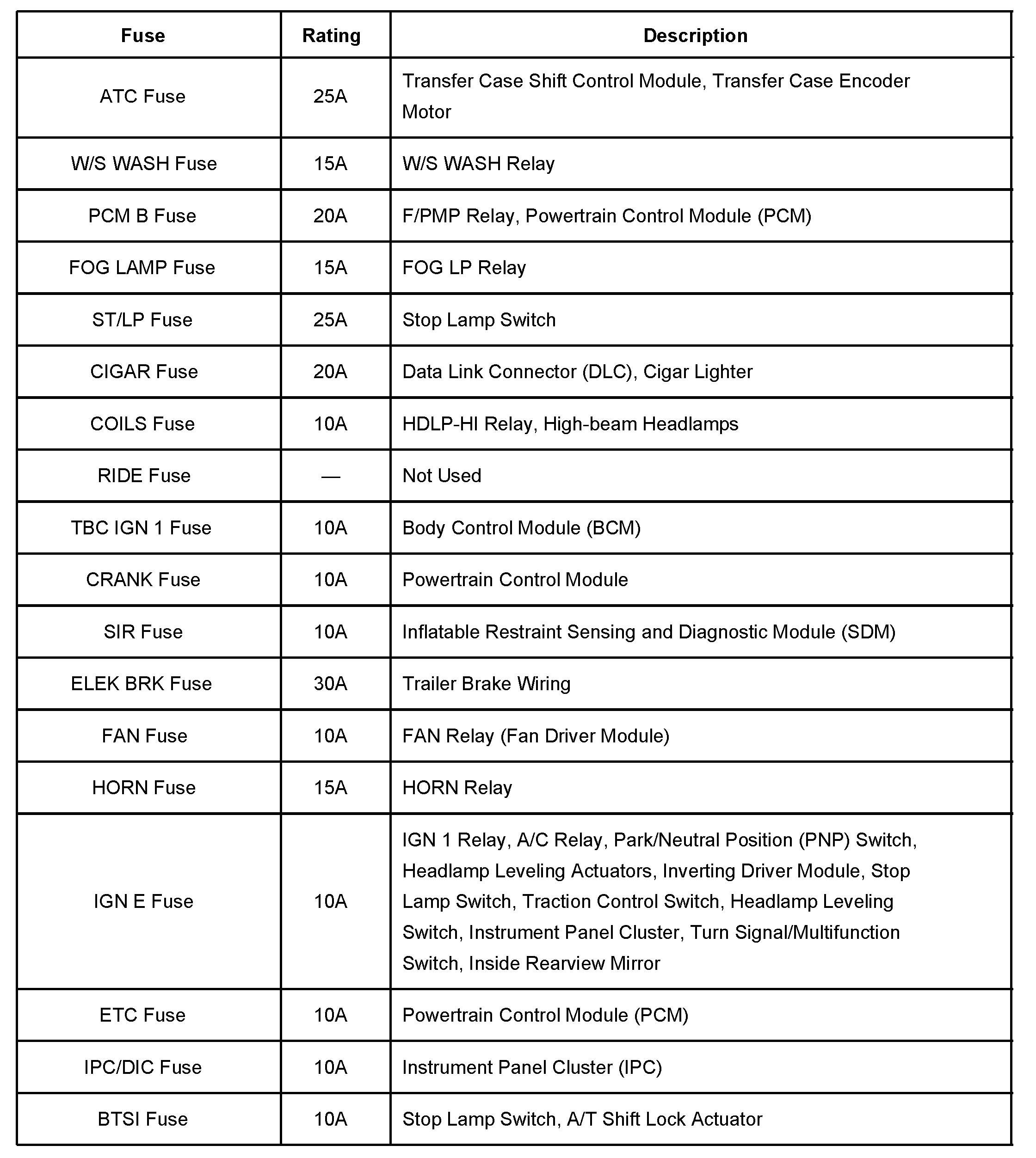

First, I have attached a picture of the under hood fuse and relay box. In addition, I attached the legends of what each fuse and relay and fuse is for. If you look at picture 1, it shows #41 as the fuel pump relay.

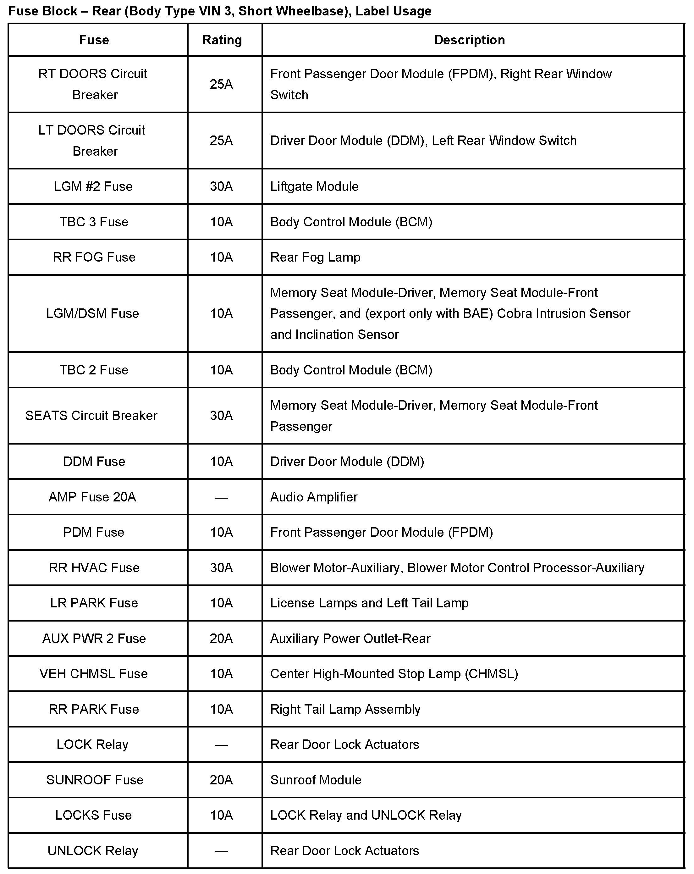

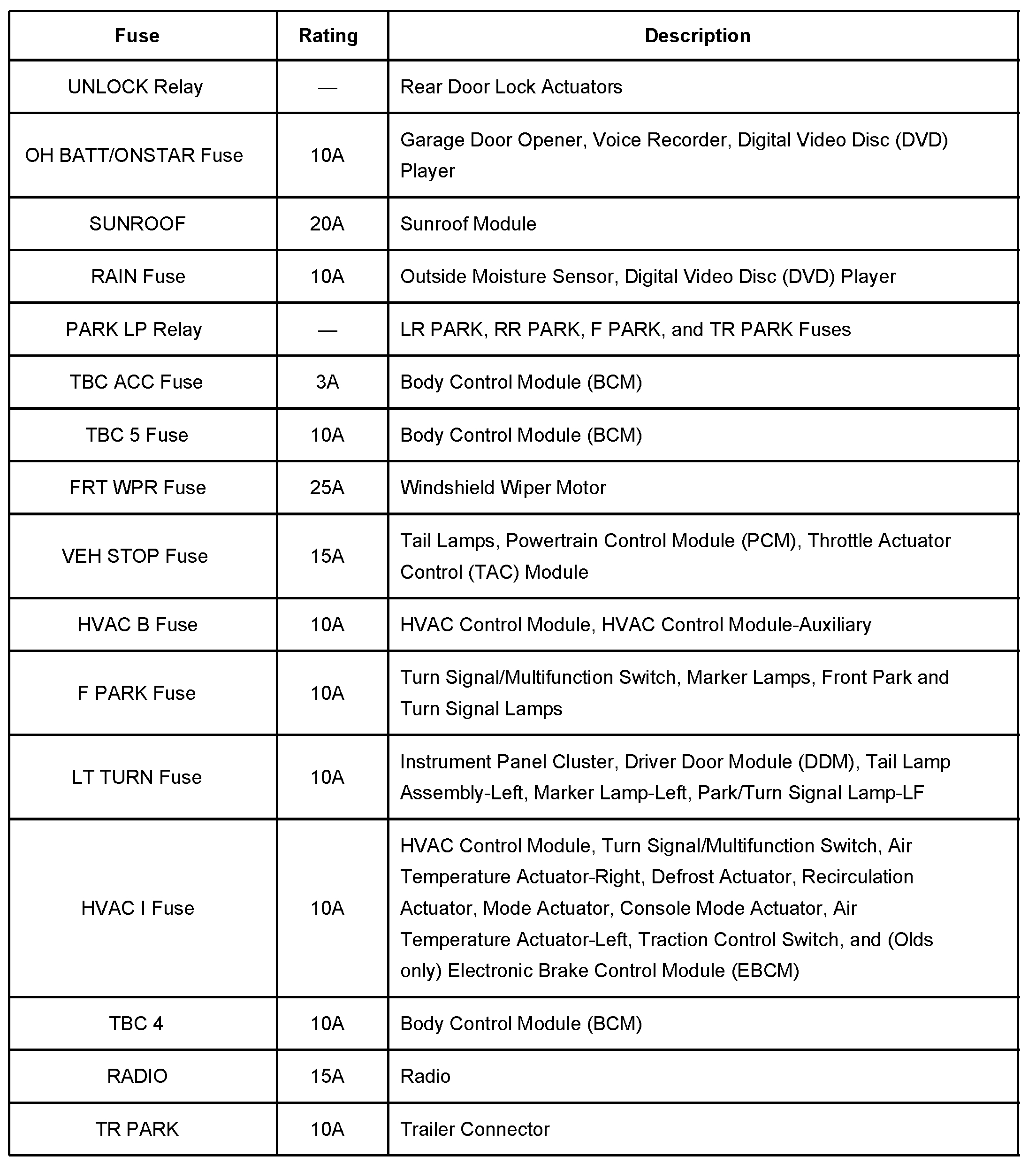

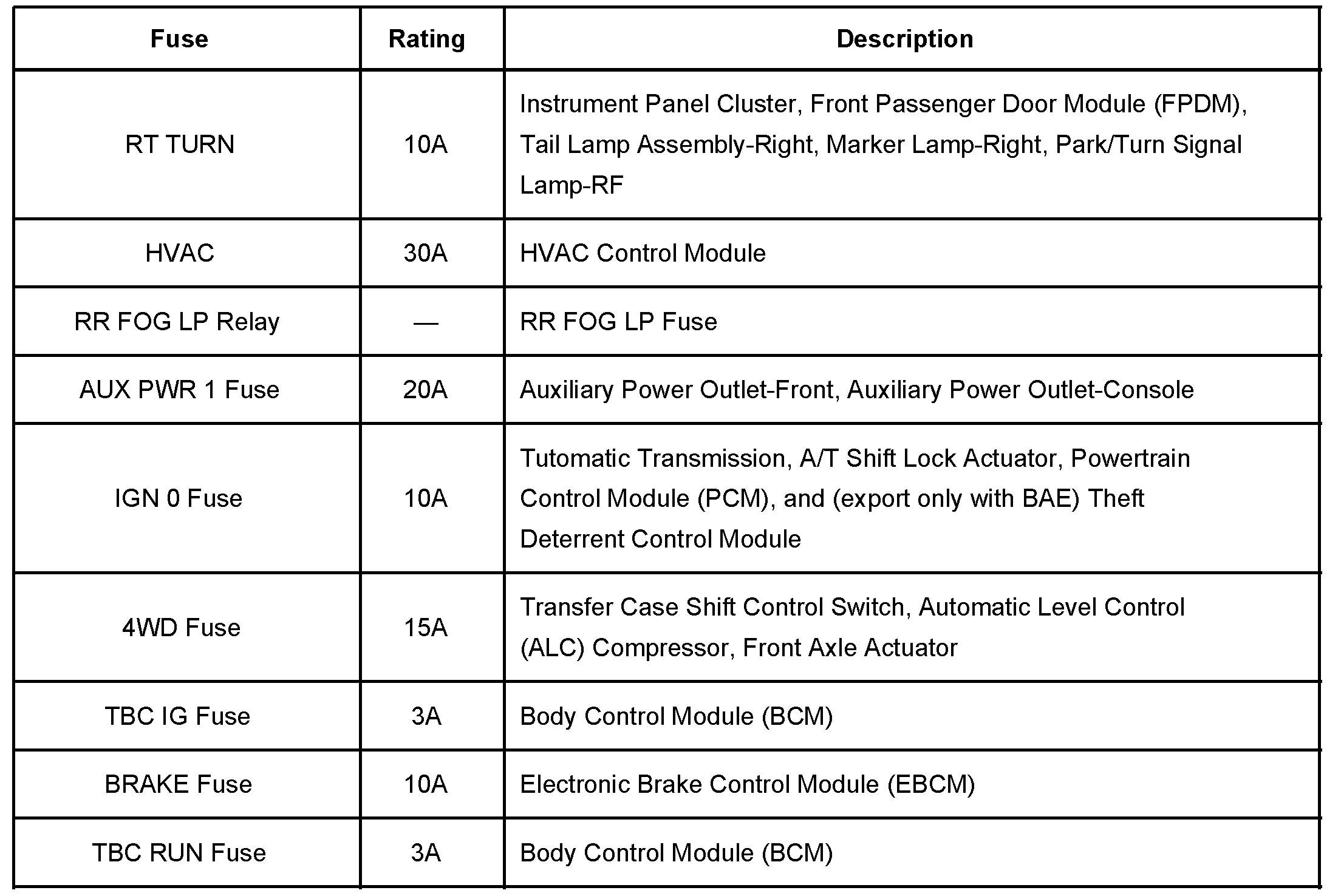

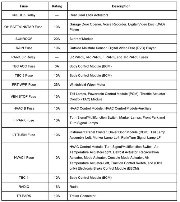

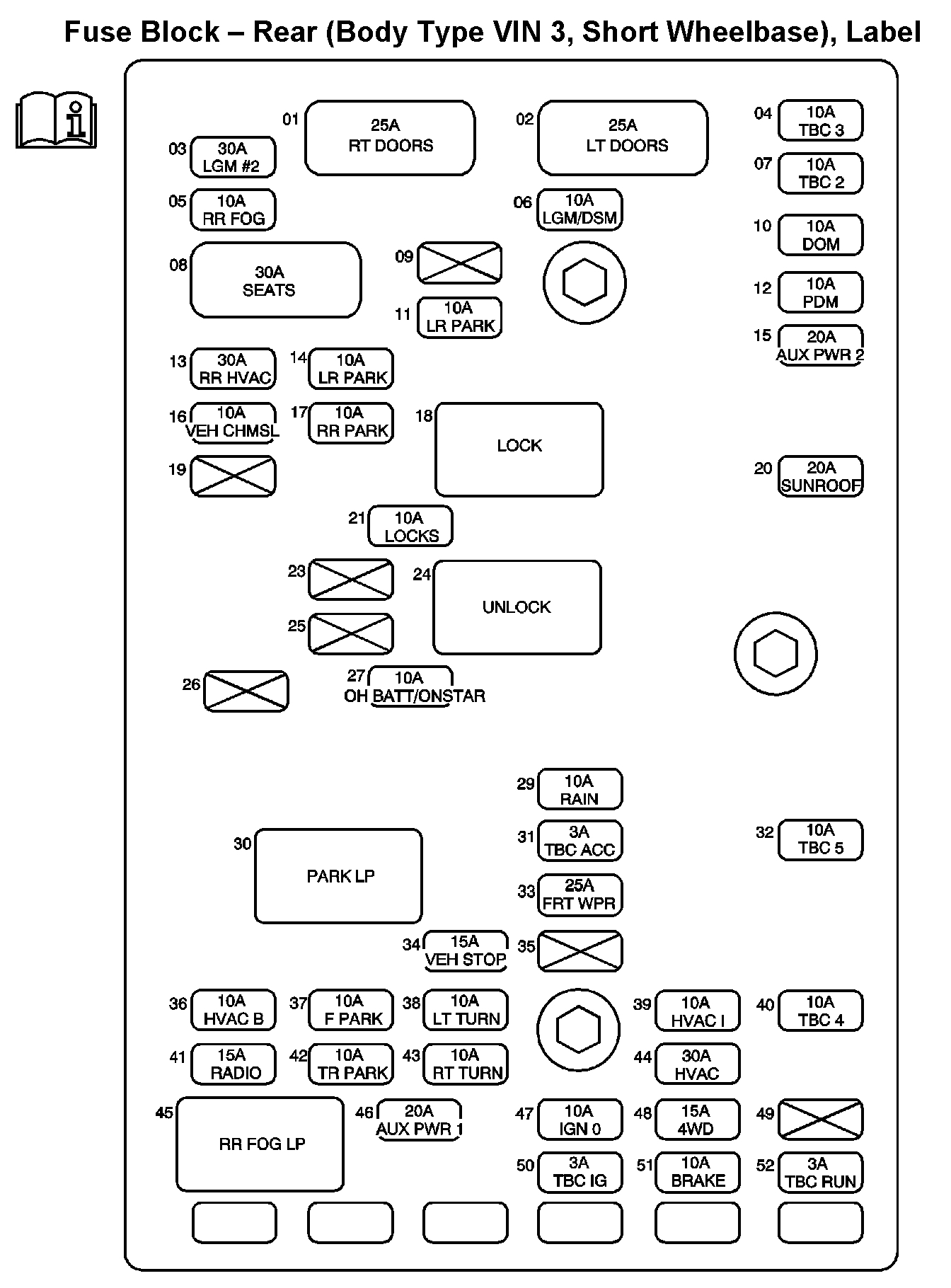

Now, there is a fuse box in the rear of the vehicle also. However, it differs based on if the vehicle is a short wheel base or long. Pictures 7, 8, 9, 10 are for the short wheel base.

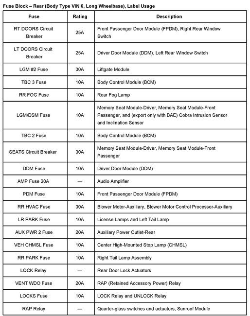

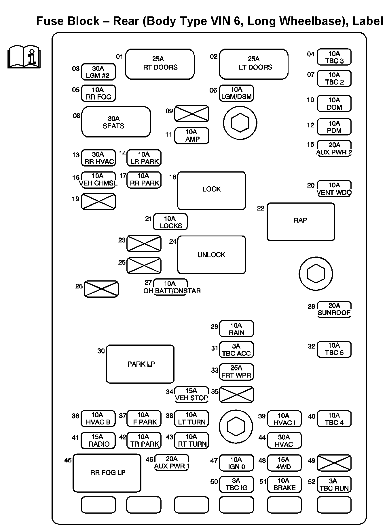

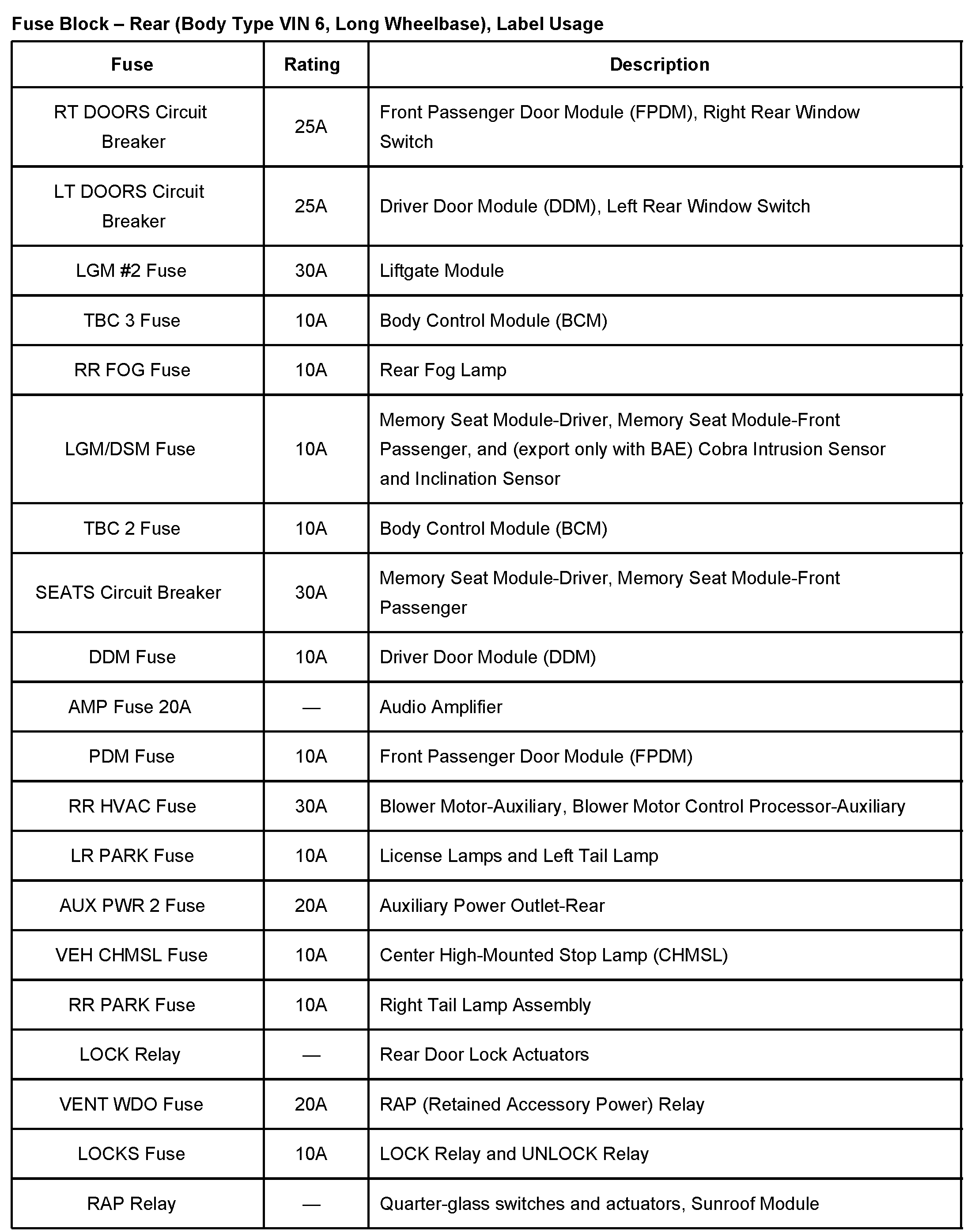

The long wheel base rear fuse compartment are the remaining pictures.
