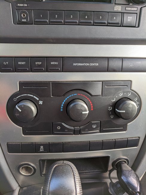

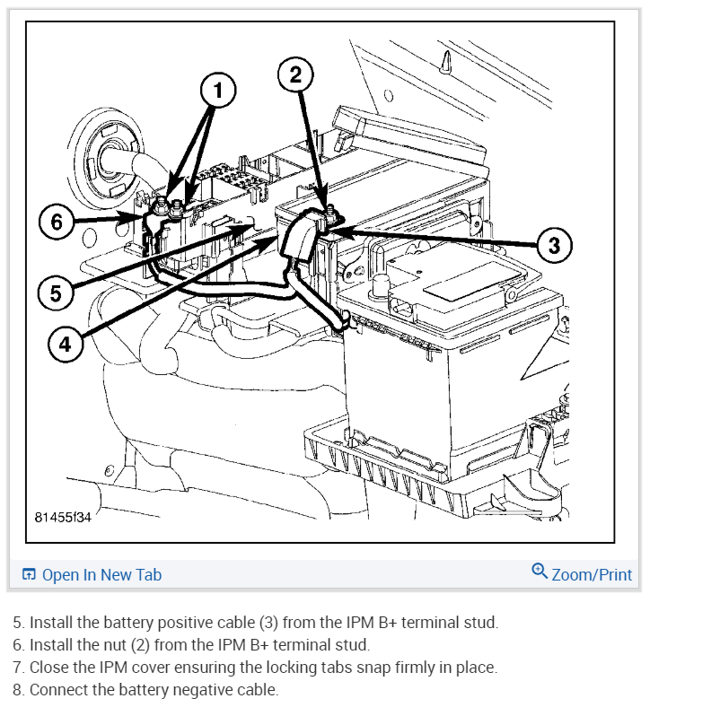

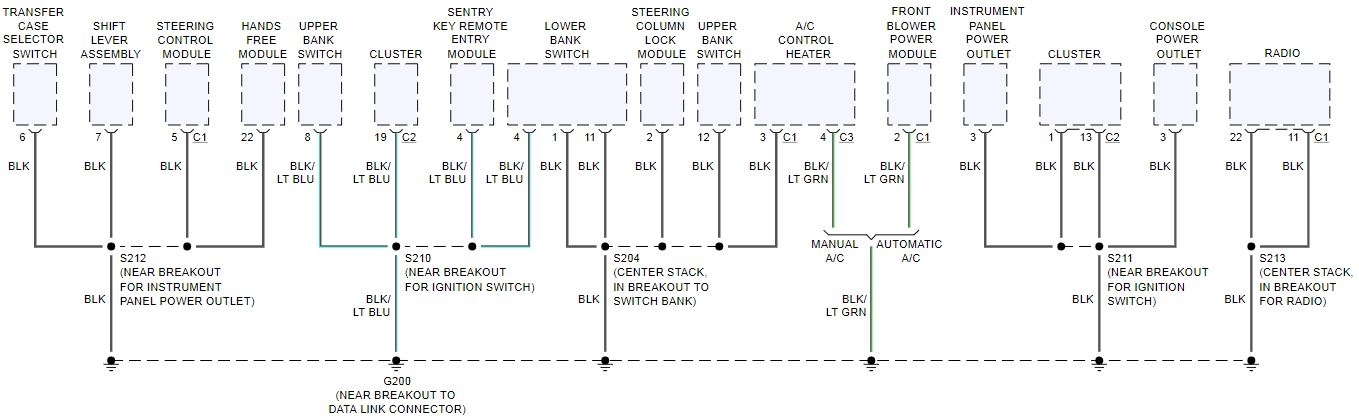

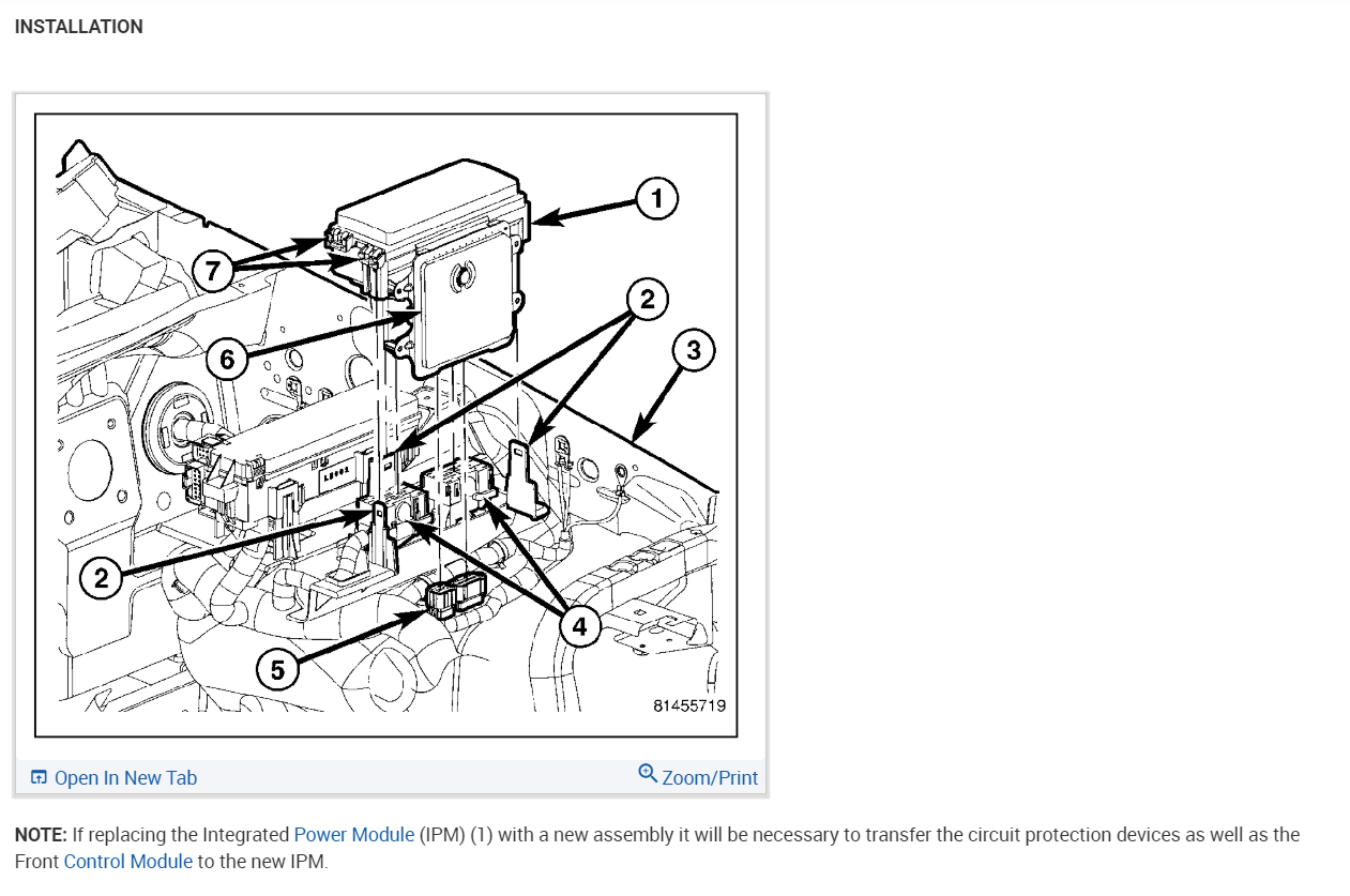

It started with the radio turning off when I started the car. Also a rough idle but went away once I drove it for a minute or two. Now I have now power at all to my dome lights, heat/AC controls. It's all dead nothing at all working, the radio lights up but nothing on the screen. I need my heat it's cold in Ohio lol.
