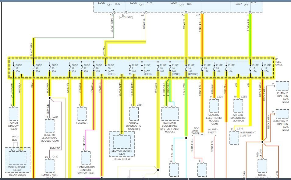

Did you verify power to the fuses? This is not a visual test but a power test.
Check the instrument panel fuse block for power with the key on to see if there is power there. That fuse block controls all the functions that do not work.
