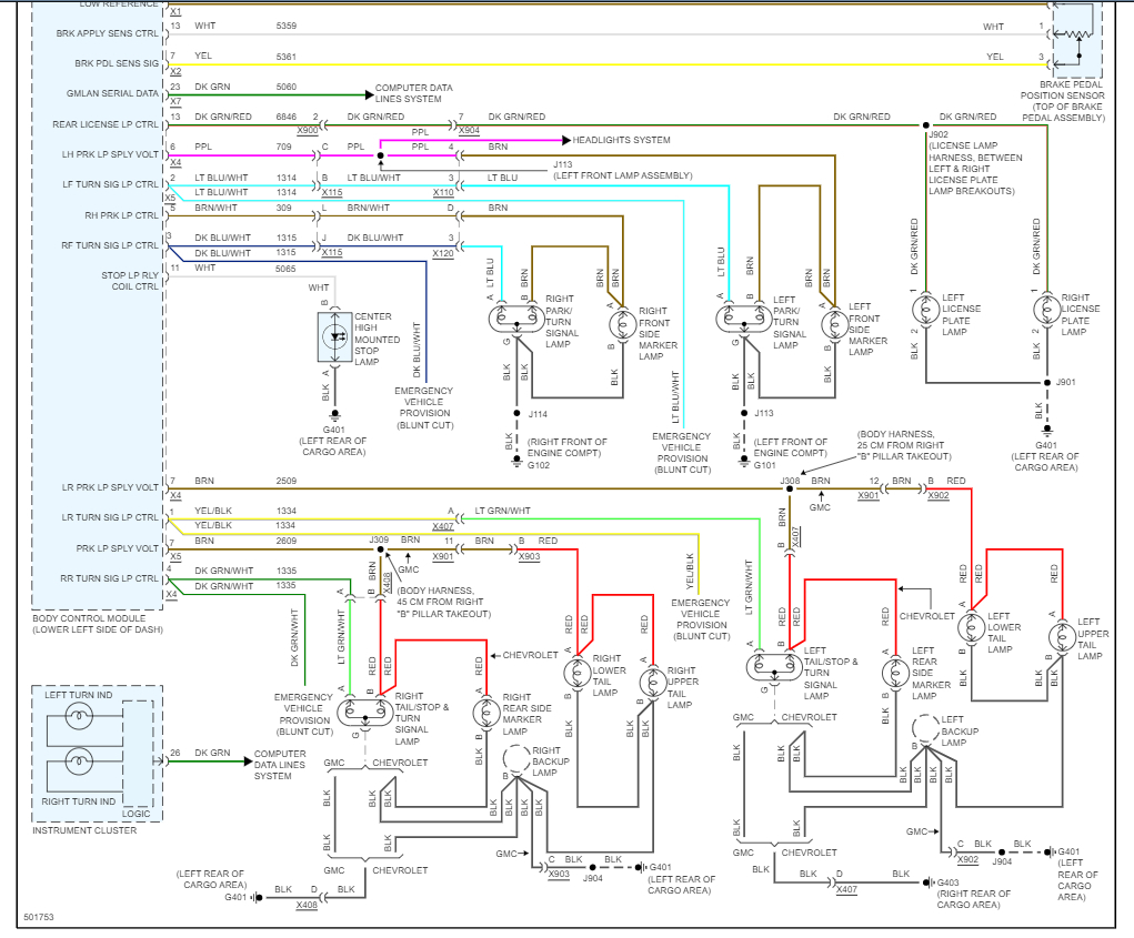

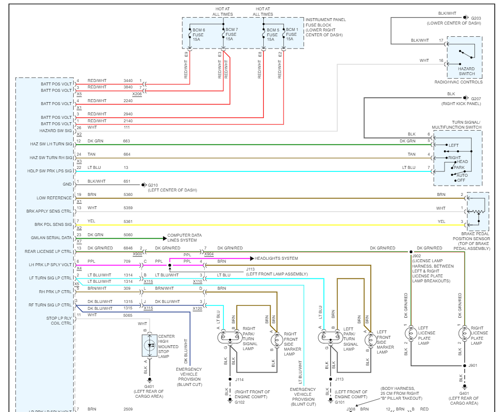

I need wiring diagrams for the turn signal switch, BCM, and fuse boxes etc., on the vehicle listed above LT model.
Apr 14, 2023 at 5:47 PM

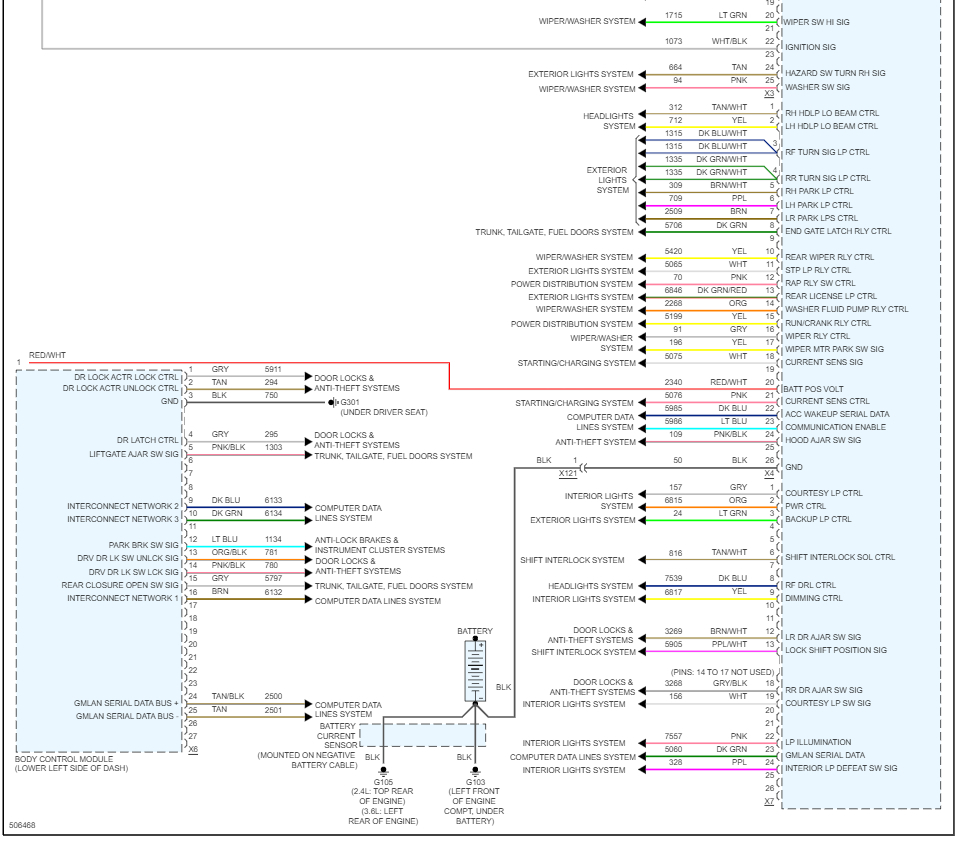

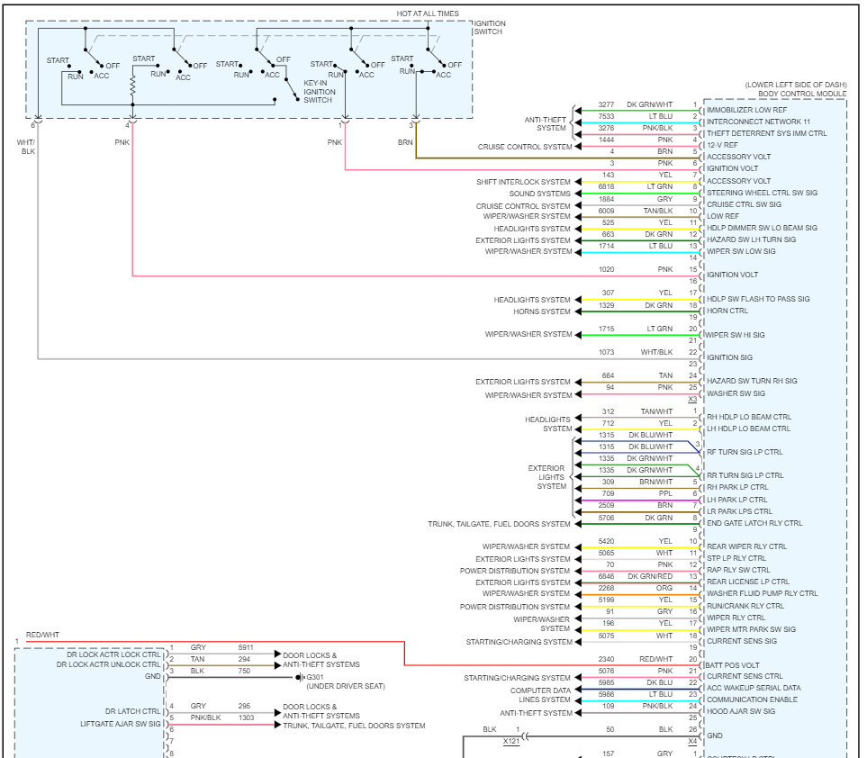

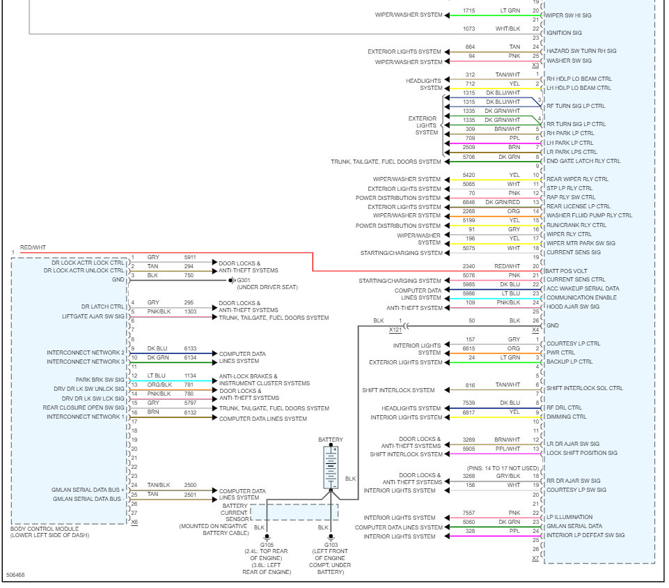

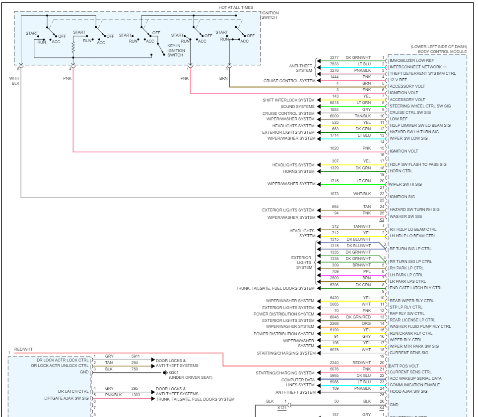

Here are the wiring diagrams for the system you have requested, and I have included a guide to help you run the tests on the connections.
Check out the images (below). Please let us know if you need anything else to get the problem fixed.

Thanks. I’m having trouble getting the left front turn signal out of the BCM as well as the right rear turn signal.
Apr 15, 2023 at 9:16 PM
MKLUERA86
  • 5 POSTS

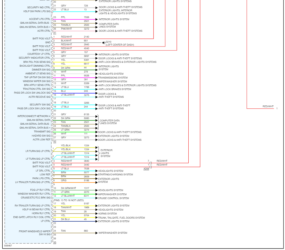

Also, there are several color-coded plugs on the BCM and the wiring diagrams provided do not specify which connector is which.
Apr 15, 2023 at 9:17 PM

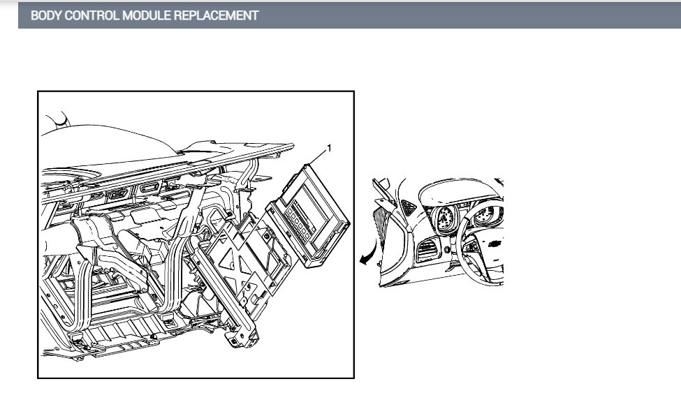

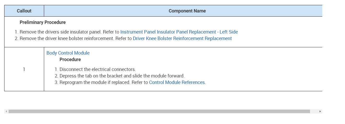

Yep, if the fuses are good and bulbs and grounds the BCM is bad which is common. Here is how to change it out. Check out the images (below). Please let us know what happens. You can get a preprogrammed unit by searching Google or Ebay.
Apr 17, 2023 at 10:05 AM

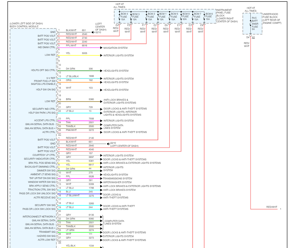

I appreciate your help, however I found out through some probing that the BCM was not getting voltage on an always hot wire and traced that to the fuse panel whereas it turns out there was a missing fuse. I wasn’t sure if this fuse was missing on purpose when I first inspected the vehicle because I’m unfamiliar with it, but with the wiring diagrams you provided I was able to solve the problem.
