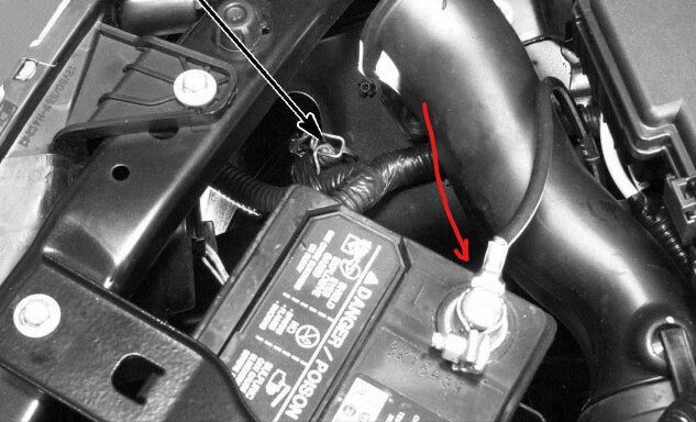

I don't think it is the alternator unless the battery warning light is on while the engine is running. I would remove the battery and take it to the auto parts store for testing; it sounds like it is bad. Here is a guide and instructions below for your car:
https://www.2carpros.com/articles/how-to-replace-a-car-battery
Check out the images (below). Please upload pictures or videos in your response.
