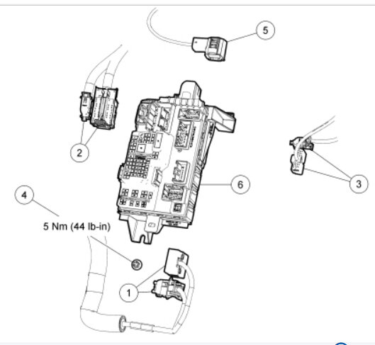

Yep, a battery which is shorting out will cause this issue, but I have seen a bad SJB on the right side of the passenger compartment get water damaged and go out as well. I would disconnect the battery and remove the SJB for inspection. The image below is what is looks like. Please let us know what happens. Ken
