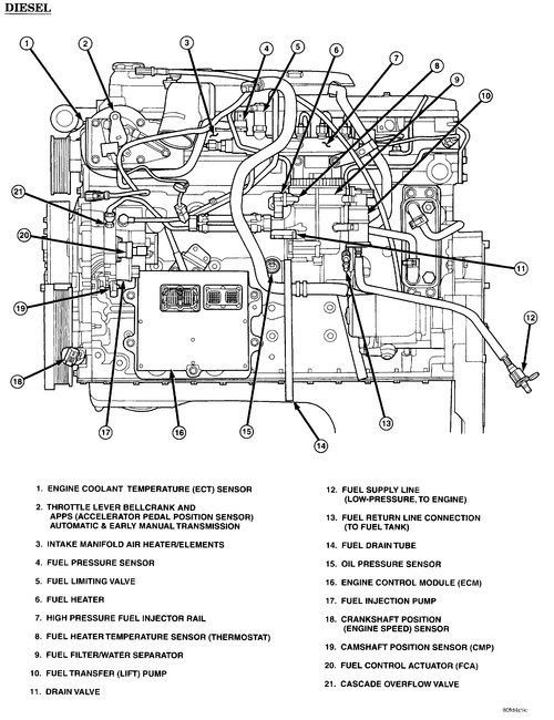

That is a concern. On this vehicle, the voltage regulator isn't a separate component. On the diesel, it is part of the engine control module (ECM). Now for the worse news. The ECM isn't serviceable. When the electronic voltage regulator (EVR) fails, the ECM needs replaced.
I attached a picture of the ECM location. It is number 16 in the pic.
If you decide to replace the ECM, they are no longer pre-programmed from Chrysler. It will require a specific type of scan tool to program it for your vehicle.
