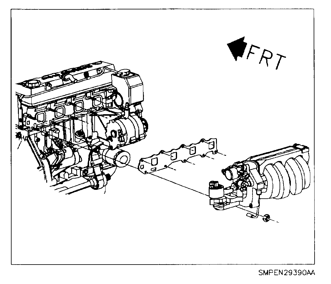

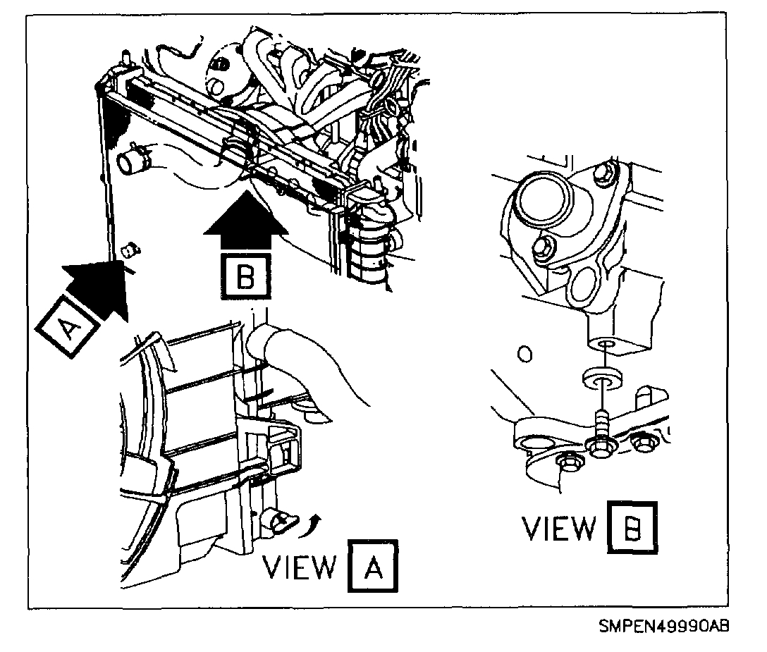

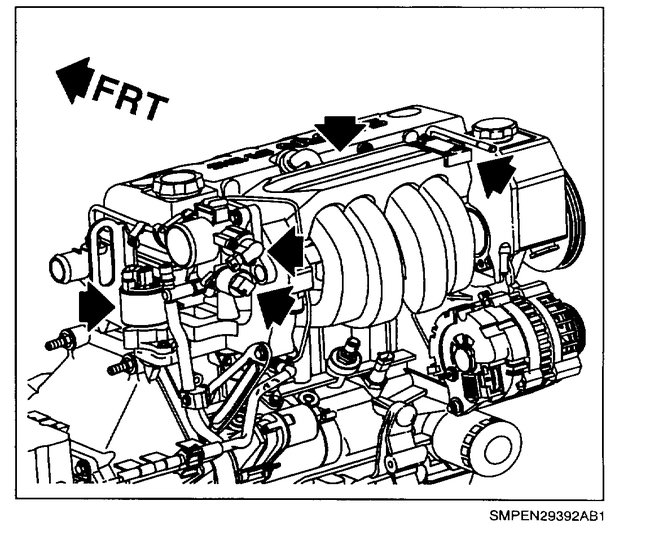

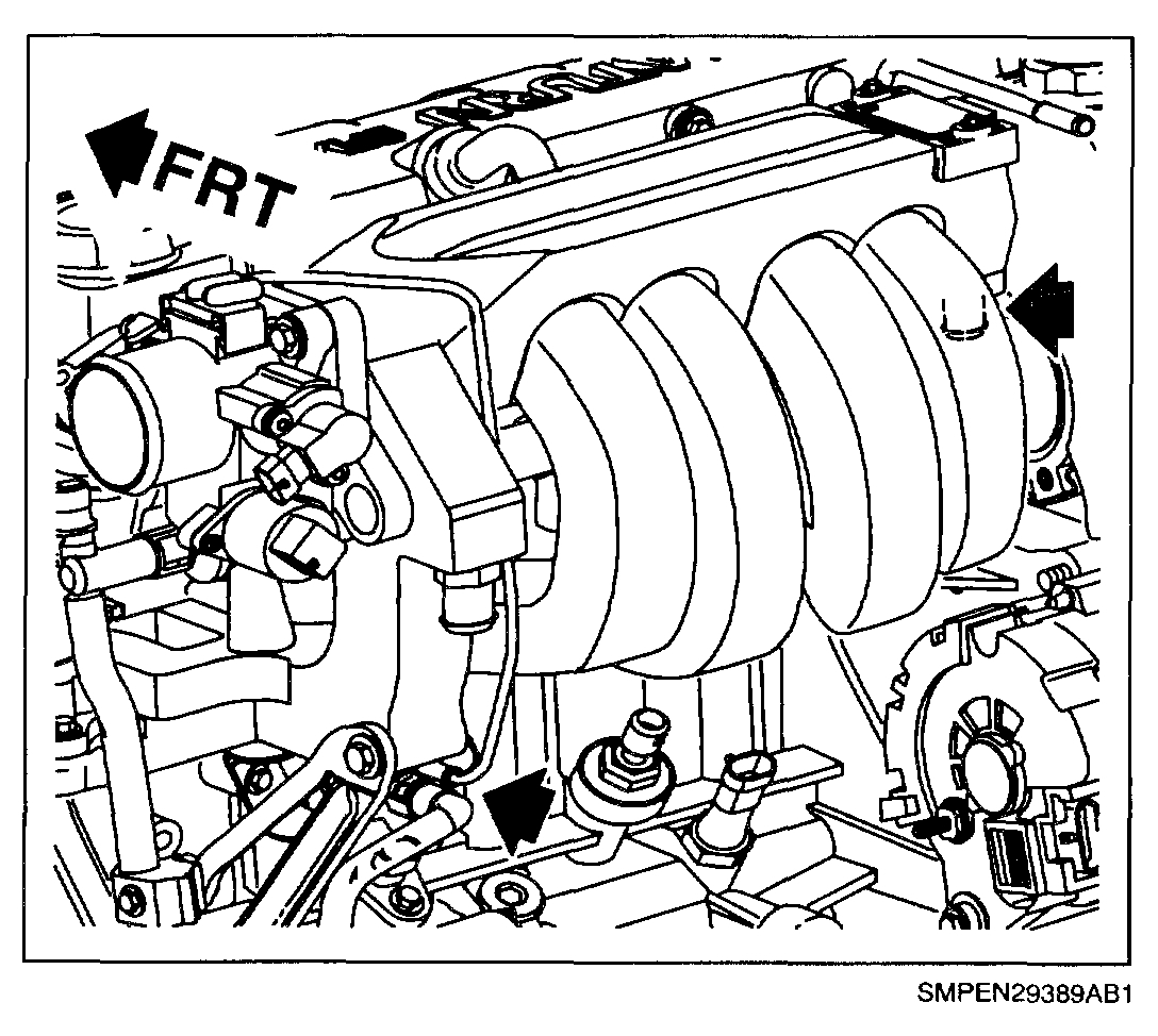

Next, I suspect that something was loosened or damaged when the manifold gasket was replaced. Have you checked to confirm that no sensors are loose and there were no vacuum leaks. I am going to provide the directions for removal and replacement of the gasket. Take a look through it to make sure there was nothing you may have missed. Also, all the torque specs are included. The attached pics correlate with the directions.

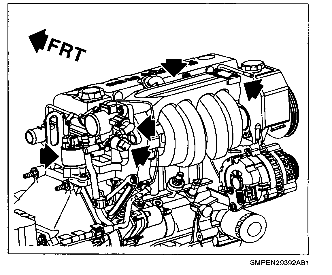

CAUTION: DO NOT ALLOW SMOKING OR THE USE OF OPEN FLAMES IN THE AREA WHERE WORK ON THE FUEL SYSTEM IS TAKING PLACE. ANYTIME THE FUEL SYSTEM IS BEING WORKED ON, DISCONNECT THE NEGATIVE BATTERY CABLE, EXCEPT FOR THOSE TESTS WHERE BATTERY VOLTAGE IS REQUIRED.

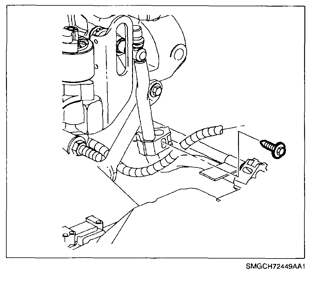

[pic 1
1. Disconnect negative battery terminal.
2. Drain engine coolant. Refer to "Engine Coolant Check and Replacement" in the Cooling System.
3. Remove air inlet tube and air filter cover, disconnecting fresh air hose at cam cover.
4. Remove PCV valve hose.
CAUTION: WHENEVER FUEL LINE FITTINGS ARE LOOSENED OR DISCONNECTED, WRAP A SHOP CLOTH AROUND FITTING WHILE CONNECTING GAUGE, TO COLLECT FUEL. PLACE THE CLOTH IN AN APPROVED CONTAINER.

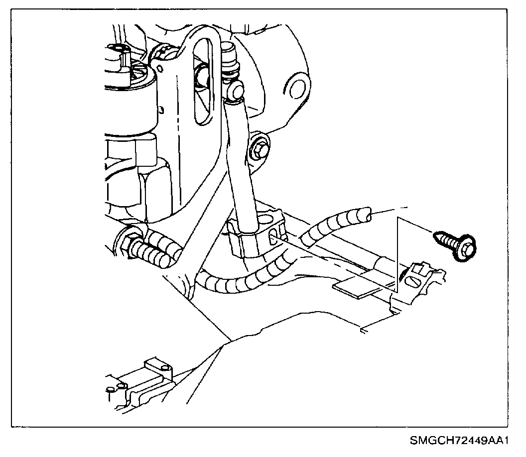

5. Relieve fuel system pressure. Refer to "Relieving Fuel Pressure" in the Fuel System.
pic 2

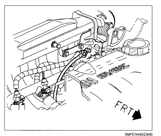

6. Remove screw from fuel line clip and disconnect fuel line from rail.

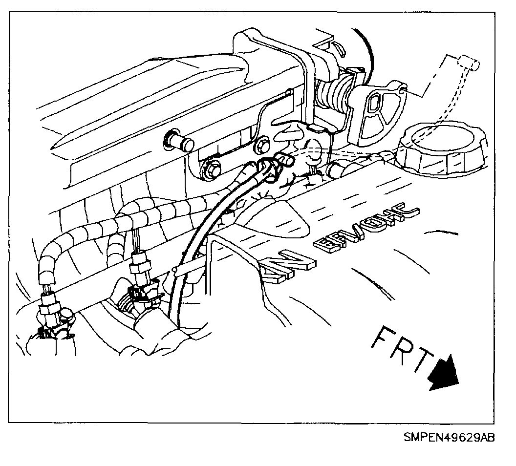

pic 3
7. Disconnect throttle cable from throttle body.
8. Remove throttle cable bracket attaching nuts.
pic 4
9. Remove the following electrical connectors and harness wiring:
- Fuel Injectors
- Throttle position (TP) sensor
- Idle air control (IAC)
- Manifold absolute pressure (MAP) sensor
- EGR valve

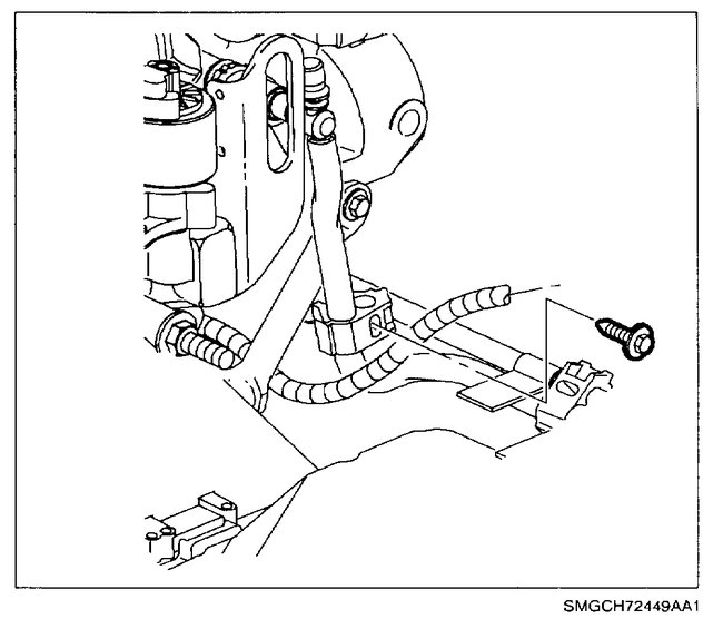

10. Disconnect heater and hose at intake manifold outlet.
pic 5

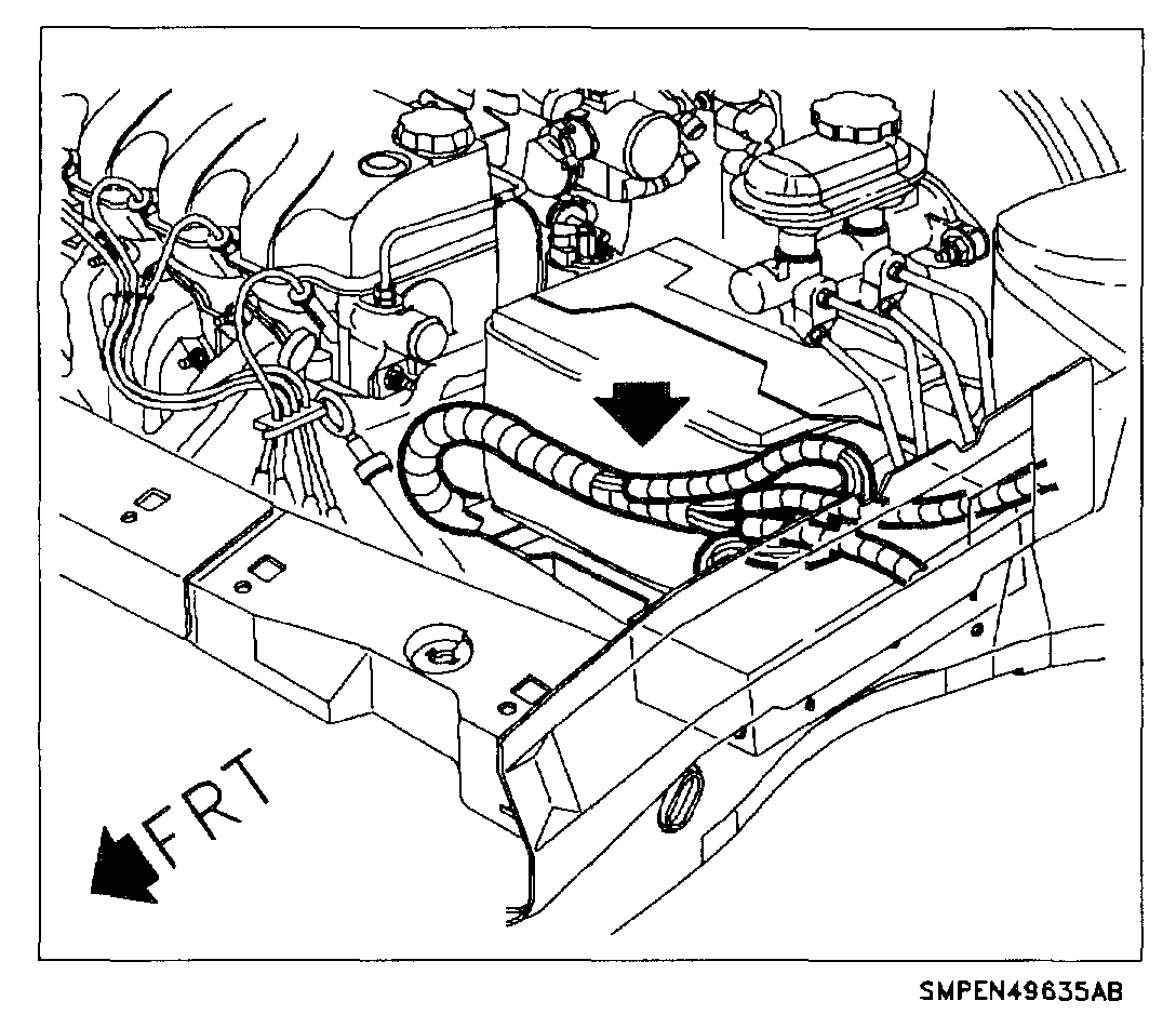

11. Lay harness over brake master cylinder.

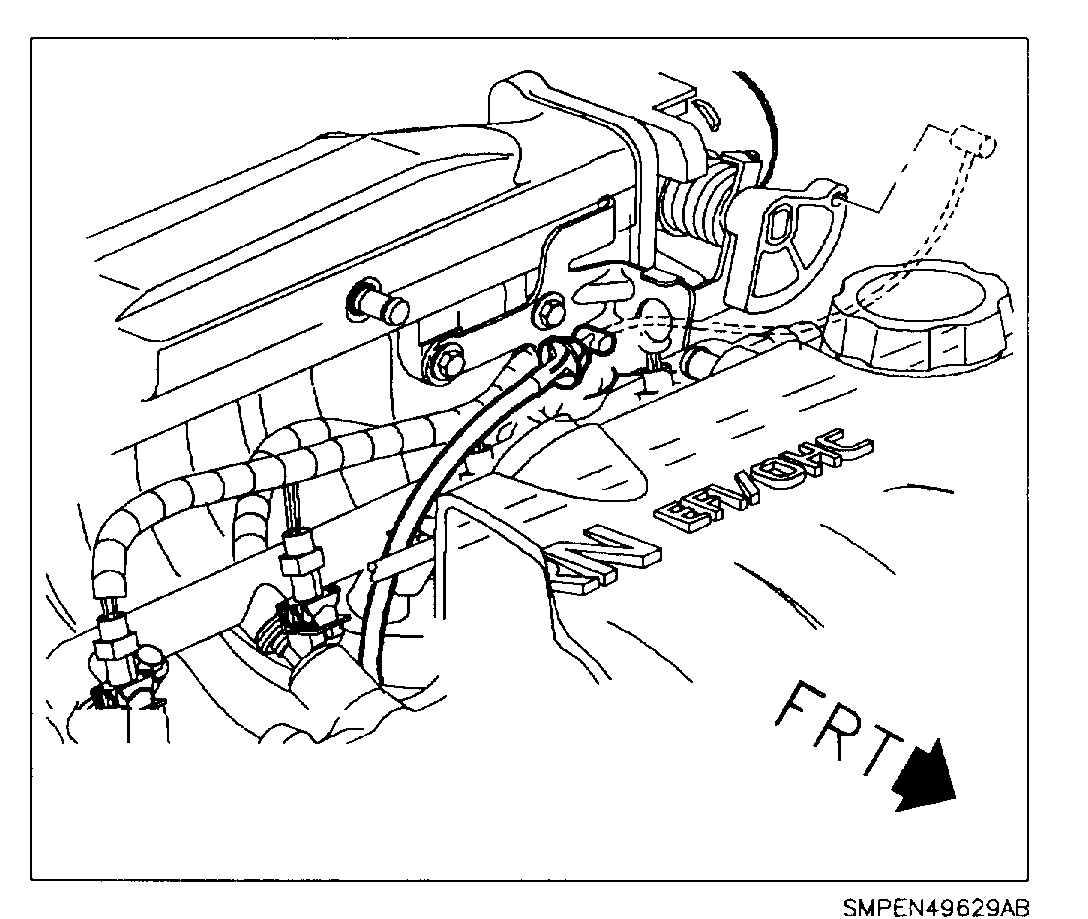

12. Remove the intake manifold support bracket bolt attached to the intake manifold located below the throttle body.
IMPORTANT: Label vacuum lines to make sure they are replaced properly.
pic 6

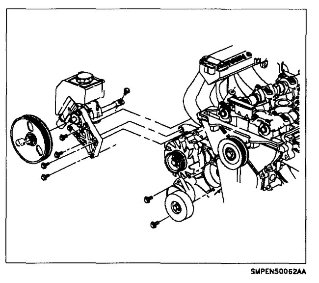

13. Remove accessory drive belt.

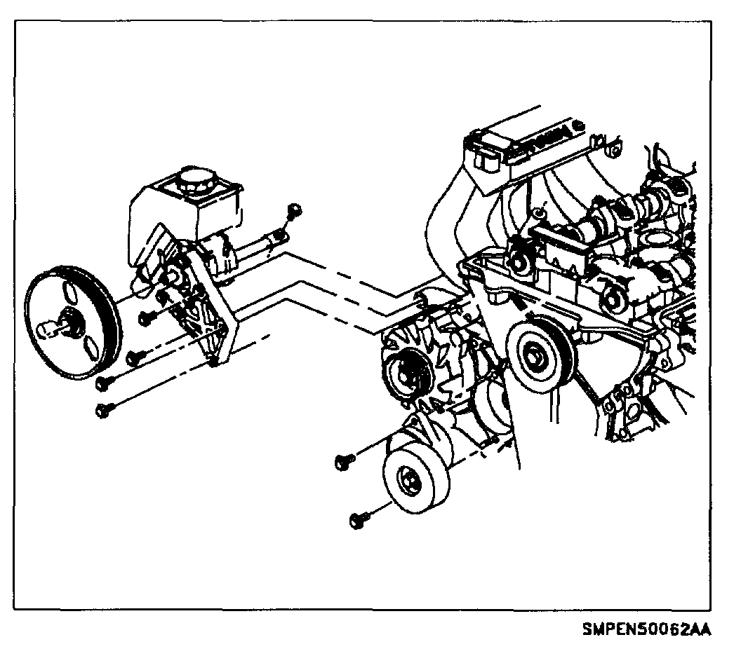

14. Remove power steering pump assembly. Remove power steering pump bracket attachment bolts and position pump next to the right-hand front of dash panel, away from the cylinder head and intake manifold.
15. Remove the four upper intake manifold attachment nuts.

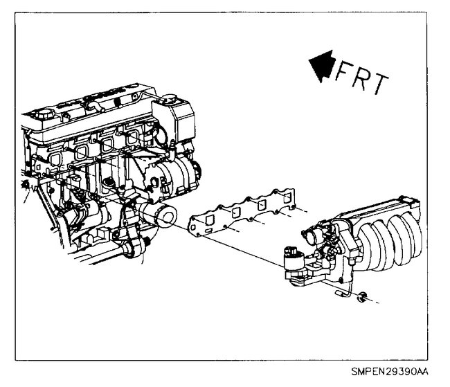

20. Remove intake manifold assembly.
21. Remove intake manifold gasket and discard. Clean cylinder head and intake manifold gasket sealing surfaces. Inspect surfaces as outlines in the "SOHC (L24) Cylinder Head".

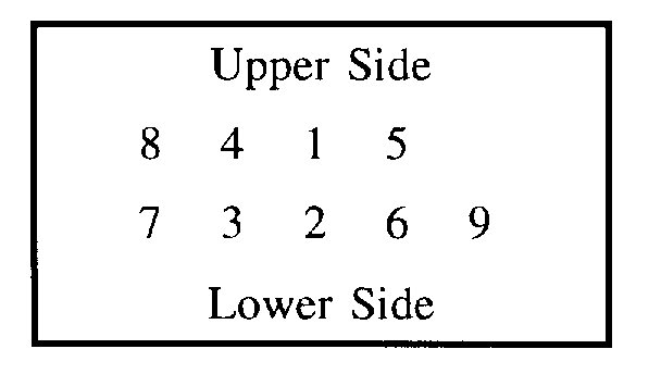

4. In sequence, torque the intake manifold attaching nuts.
Torque:
Intake Manifold-to-Head (L24): 30 N.m (22 ft-lbs)
pic 9
Intake manifold bolt tightening sequence:
