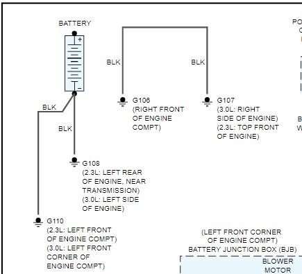

There is nothing in the alternator or battery that will cause everything to shut off. If the alternator stops charging for a second, the lights will dim but not shut off. If the battery is weak, you would be able to tell when starting the vehicle.
With that in mind, this is an electrical issue. The first things I would check are grounds, make sure the battery terminals are clean and tight, make sure the main ground from the battery to the engine and body are clean and tight.
I have attached a partial schematic which indicates the locations of the battery grounds. Check them for condition, corrosion, and if they are tight.
Do this and let me know what you find.

Did not see any corrosion and the wires are tight.

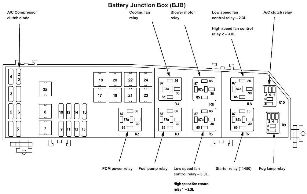

Okay. Next I want you to check fuse 17 ( amp ignition fuse) in the under hood fuse box. Also, check the PCM relay in the same under hood box. I attached a picture of the fuse/relay box. Check both of these items to make sure they are tight, there is no corrosion where they plug in, and if there is another relay with the same part number, switch it with the PCM relay to see if that makes a difference.

17 was good and tight. not sure how to get to the PCM relay and not sure how to pull the cover odd.

The relay should just pull out. Are you able to remove any relay in the box?
