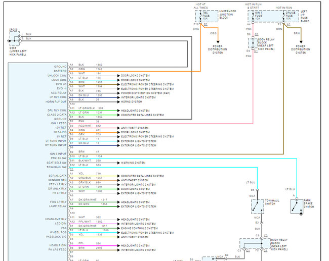

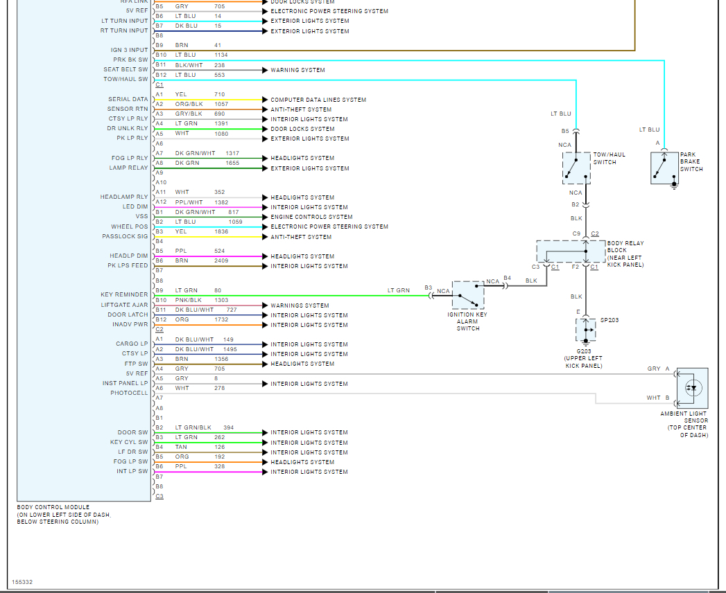

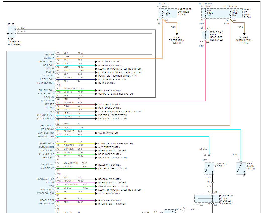

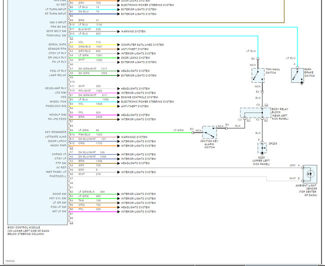

You were correct replacing the BCM which run all of these systems. I would run a CAN scan to see what codes are stored. Also, I would see if the BCM is getting power and a good ground. This guide can help, and I have included the BCM wiring diagrams below so you can see which wires to test for power and ground.
If the power and ground is good here is how to do a CAN scan. You can get a CAN scanner (Controller Area Network) which will work on most cars from Amazon.
Here is a video to show you how:
https://youtu.be/u-4syLc-ifQ
Run the power test with the key on. Check out the images (below). Please let us know what happens.

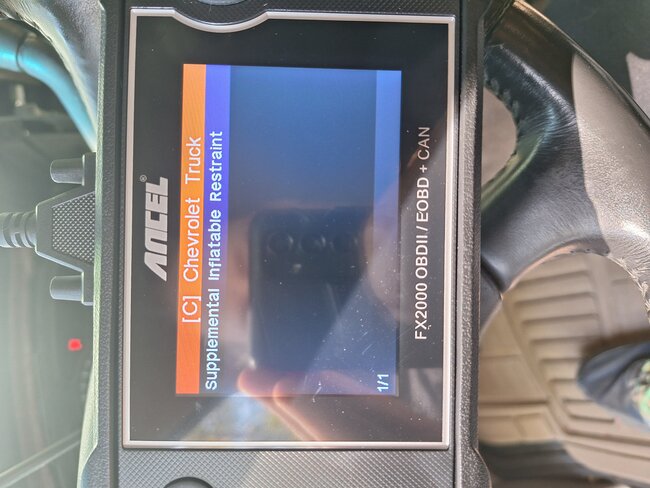

What about the modules showing up on the scan tool? I'm attaching a picture of it for you.
Oct 15, 2024 at 9:52 AM
BEEFY72
  • 18 POSTS
Ken,
Does this model have a dash integration module and if so where is it located? When I bought the tahoe the blower motor was real noisy. I removed ot and found something had been in there making a nest. I was just wondering if that is where the dim module is around the glove box and maybe there might be some chewed wires. Thanks again for all your help.
Oct 15, 2024 at 12:09 PM
It looks like you may have found the problem, mice like to eat the wiring. You may need to remove the dash and do a main wiring harness inspection.
