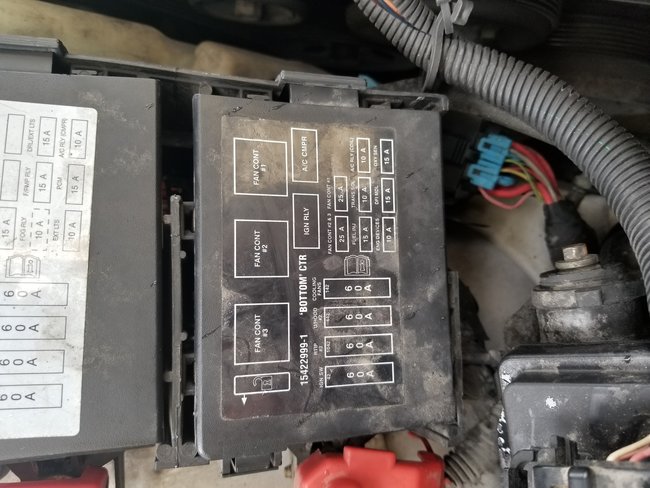

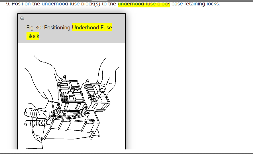

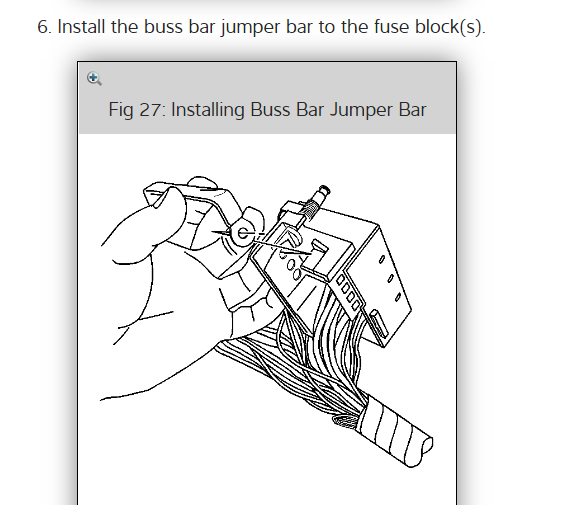

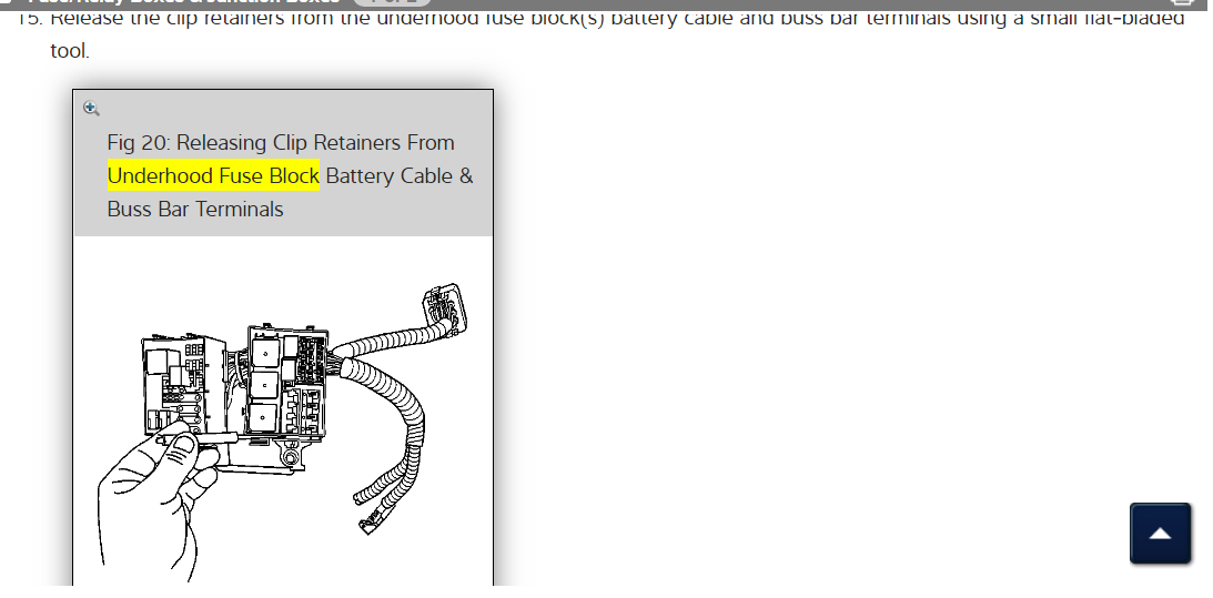

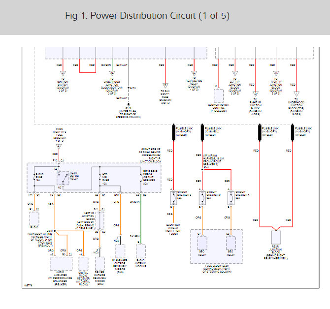

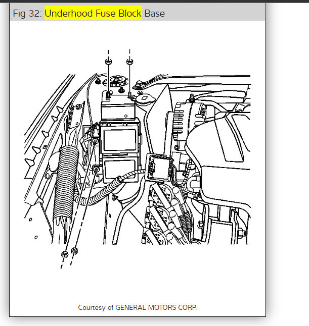

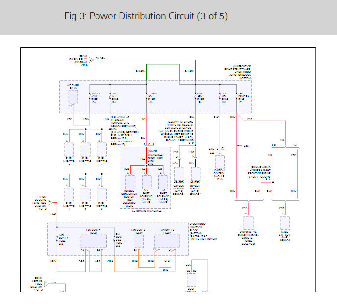

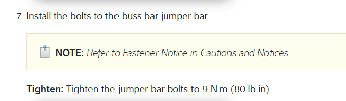

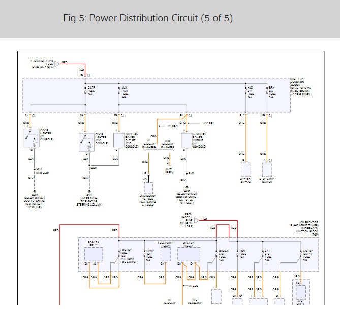

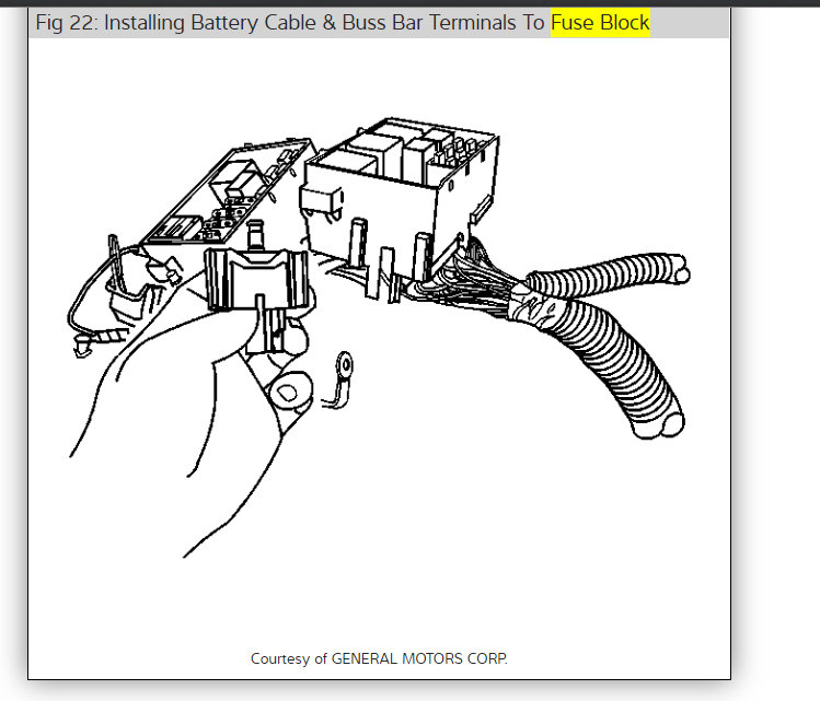

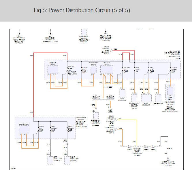

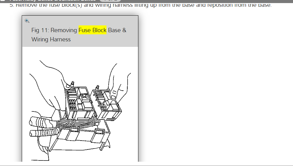

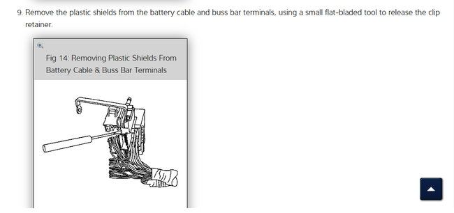

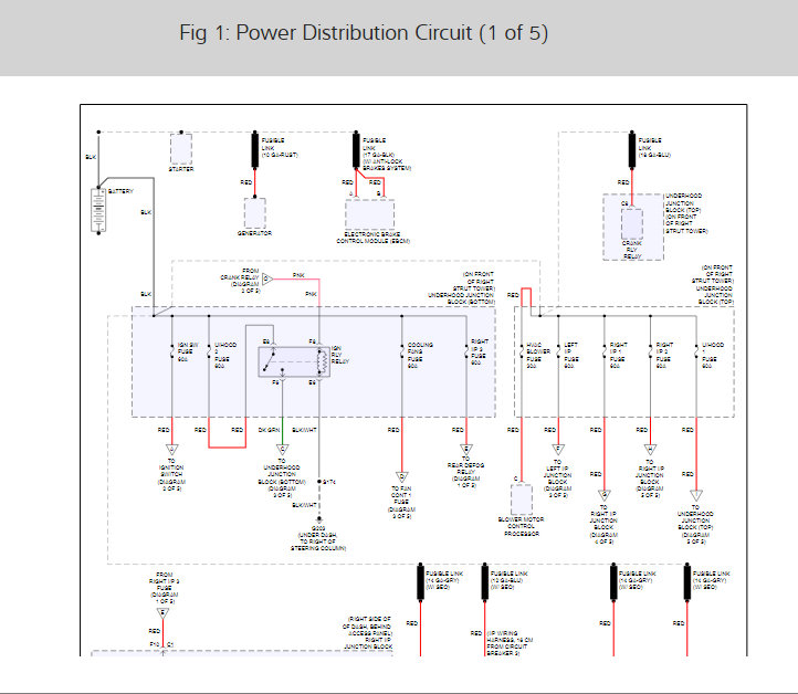

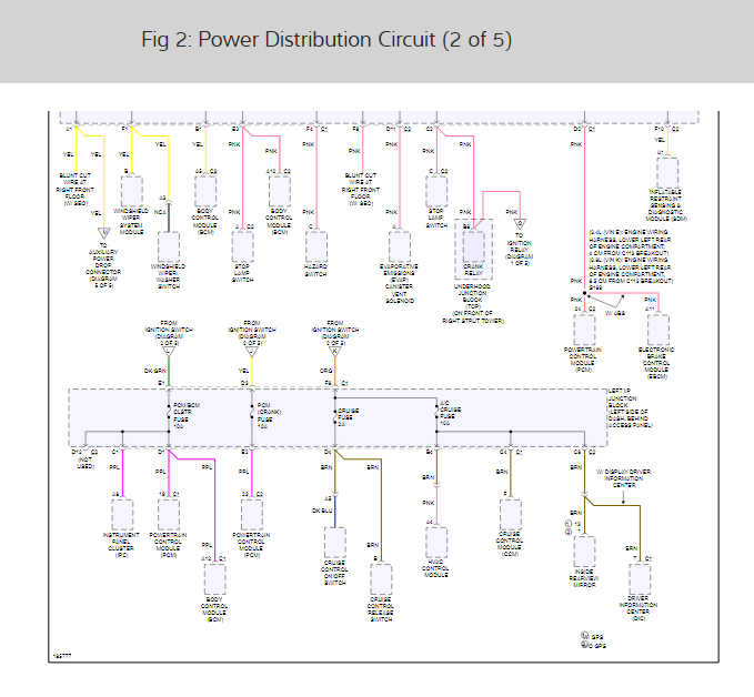

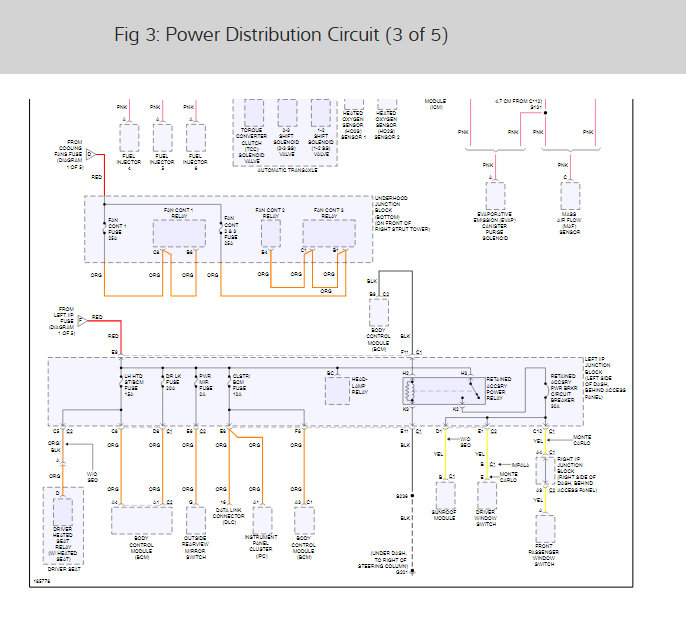

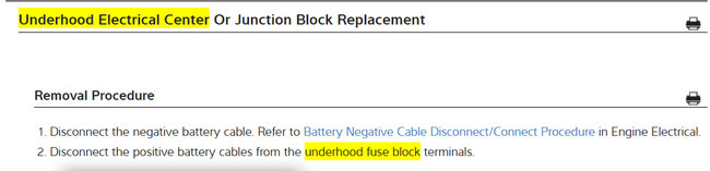

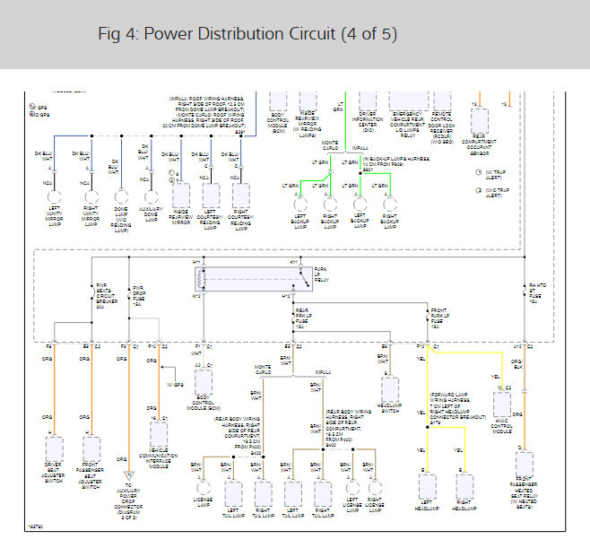

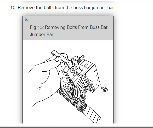

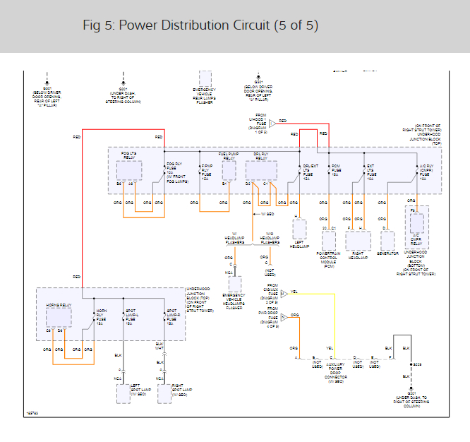

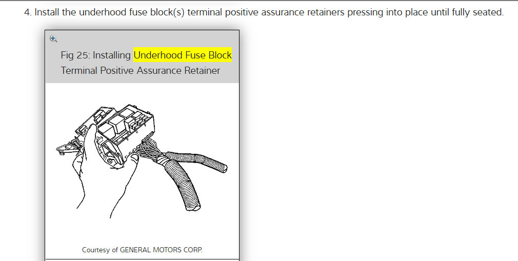

For some reason I have no power going to 6 of my fuses. the bottom 6 on the cover of the fuse box starting with fuel injection and ending with oxygen sensor. All 6 fuses are good. I have power coming from the battery into the fuse box. The rest of the fuses in the box all have power. What threw me for a loop is that one fuse that has no power is ENG Comp which is supposed to supply power for various things such as the MAF sensor. Pulling the connector from the MAF sensor and I tested it for power which it has??? Help
