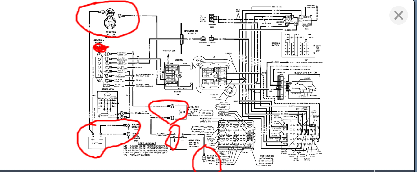

From your video you supplied us it looks like you are loosing complete system voltage when you turned your steering wheel. I would double check all battery cables, positive side and negative side on both ends. On the engine, frame, body and starter, and Battery. Check and make sure you have a good clean and tight connections.I am including a wiring diagram below and marked the connections to pay special attention too. Also check around the bell housing with a good flash light. I hope this helps you out and please let us what fixed it.
