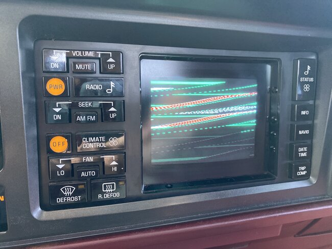

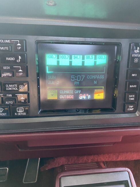

I just purchased the car listed above that has sat for roughly 5 years. I got a good deal on it and I’m trying to fix this electrical issue. I’m having issues with the VIC and digital instrument panel. I have checked all fuses. Cleaned all grounds. Tried replacing the CPS (Central Power supply) unit with 2 used junkyard ones. Checked wiring for cuts. Wiggled wiring around. Removed Vic and cleaned connectors with electronic cleaner. Also replaced most relays in the fuse block behind the glove box. Nothing seems to work. The Vic will come on after the car has sat for roughly 20 minutes. But if I go to start it back up after the Vic was just functioning the Vic just shows lines. The digital instrument cluster is always black but the right side of the cluster flickers when starting. I have read other forms about this issue and others are saying replace the CPS with a good known one. Maybe there is a way I can repair my old CPS. I know the soldier joints were bad and there is a service bulletin on that. Any information or suggestions would be very helpful.

Your first photo looks like a picture tube tv that lost its horizontal hold. If that really is a picture tube, they require a really high voltage to run that tube. That can be over 20,000 volts. You'll see a fat wire with a rubber cap where it plugs into the side of the tube. Stay clear of that while the unit is running. The horizontal output circuit is what develops that high voltage, so if you can see anything on the screen, it's working, but that doesn't mean it's "in sync". Being out of sync is what makes the picture turn into those horizontal lines. That used to happen to tvs when the set was not in sync with the cameras at the tv studio, or the signal they were broadcasting. I'm not sure what they would be syncing to in a car. The tv studio, in effect, is right there in the same unit. I'm thinking out loud now. That Central Power Supply you mentioned might be the system that develops that high voltage to run the crt. If it is, follow that wire plugged into the side of the crt back to its source. That would be the high voltage transformer. In tvs, those were ripe for broken solder connections where they mounted to the circuit board. Some are held on first with two screws, then the pins are soldered to the board, but a lot of them didn't use those screws. Just the pins held the transformer in place. That's a lot of weight to ask of them, especially in a vehicle that's bouncing and vibrating. In some tv models, the right broken pin's solder connection could keep the transformer working, but the feedback circuit wasn't there to keep the screen in sync with the pulses in the broadcast signal. That would give you the horizontal lines like you have.
To say that a less-complicated way, check for more bad solder connections around that transformer. There will also be a much smaller "horizontal driver" transformer nearby. They're commonly less than an inch square and will usually have only four terminals. The high voltage will be lost if any one of those pins has a bad connection, but that gives you an idea of the area on the board to look over closer.
You can also try pressing lightly on the circuit board with a non-metal tool while the unit is running. If doing so makes things change, you know there's a hairline break or a bad connection. The problem then is to find it.
