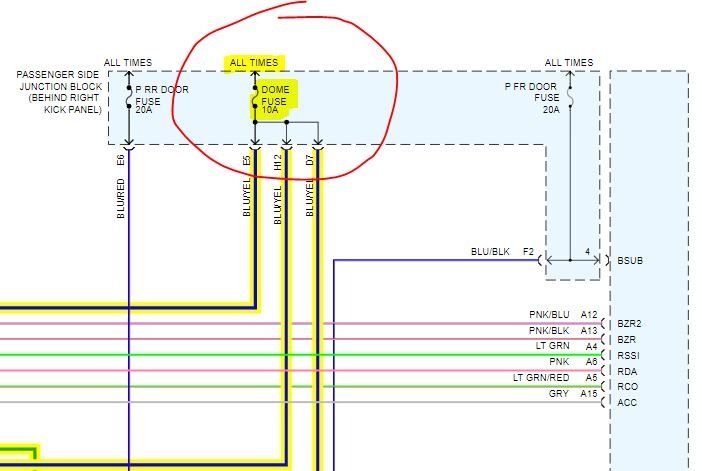

I need to get a better understanding of what has happened. My biggest concern is that there are wires needing twisted together to make the radio work. Is this an aftermarket radio that was installed? Looking through schematics, I see no red or yellow that would work in conjunction with the radio power.

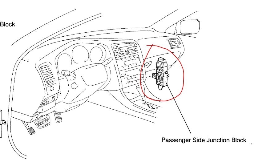

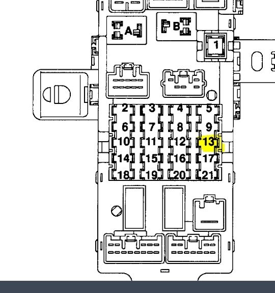

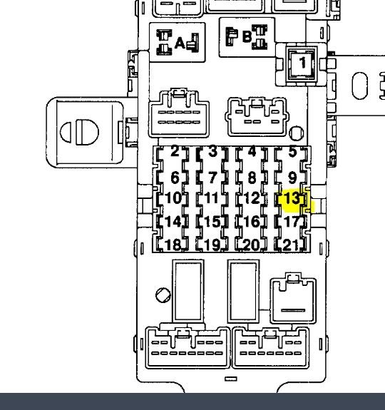

Do me a favor. There is a 10 amp fuse behind the right kick panel. If is for the dome light and should provide power at all times. Check it to make sure it is good. (See Pic 1) Also, pics 2 and 3 show the passenger side fuse box location and which fuse to check, number 13.
If the fuse appears good, confirm there is power at the circuit. Here are a few links you may find helpful:
