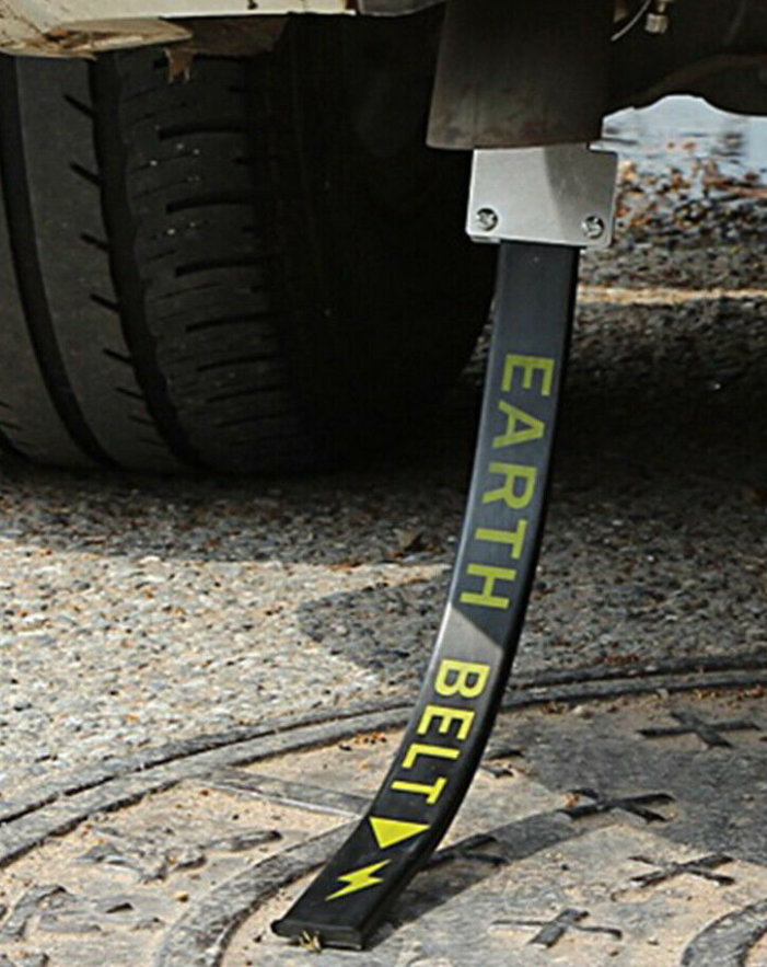

Static Strap
This is a conductive strap which is bolted to the bottom of the vehicles chassis. It then hangs down and contacts the ground beneath the vehicle. This is a very effective way to eliminate static electricity build up but for some people it is not aesthetically pleasing.
Please find picture attached below

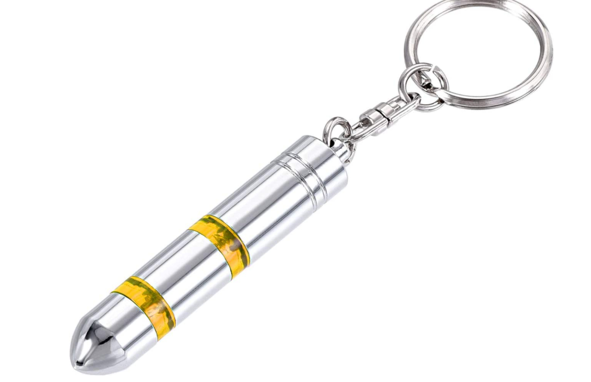

Anti-Static keychain
You can also buy an anti-static keychain. These devices provide a safe, painless way to discharge any static built up in your clothes before you touch your door to get out. They typically also include some kind of display or light that flashes when static electricity is discharged through it.
See picture attached below
