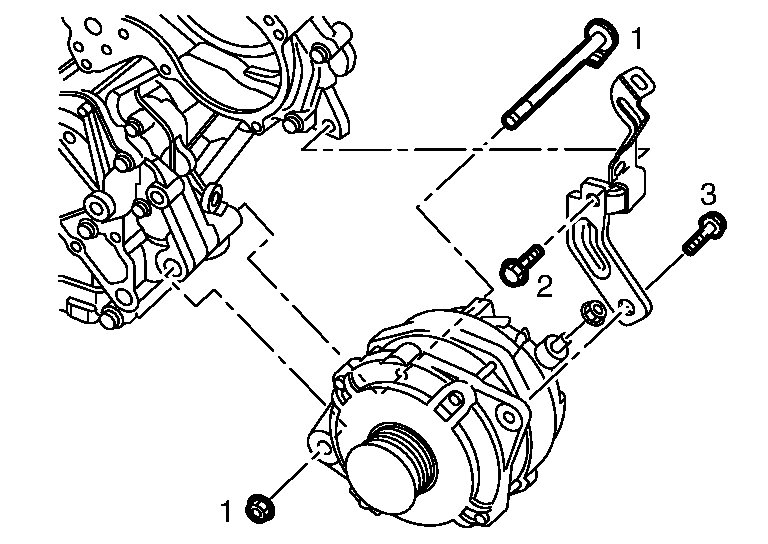

11. Remove the alternator bolt and nuts, using power tools.
12. Slide the alternator out and remove.
INSTALLATION
Installation is in the reverse order of removal.
CAUTION:
- Temporarily tighten all of alternator bolt and nuts. And then tighten them in numerical order shown in the figure.
- Be sure to tighten "B" terminal nut carefully.
- Install alternator and check tension of belt. See: Drive Belt Tensioner > Removal and Replacement > Exploded View.
- For this model, the power generation voltage variable control system that controls the power generation voltage of the alternator has been adopted. Therefore, the power generation voltage variable control system operation inspection should be performed after replacing the alternator, and then make sure that the system operates normally. See: Charging System > Initial Inspection and Diagnostic Overview > Inspection Procedure.
