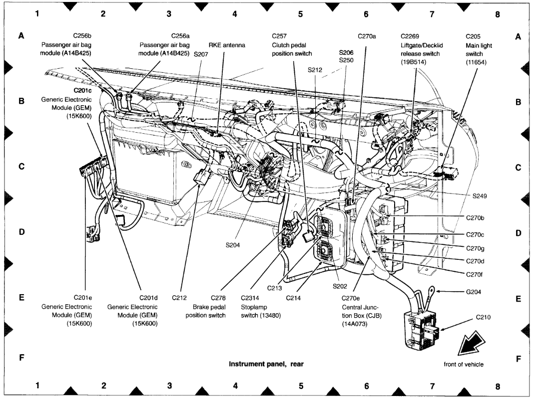

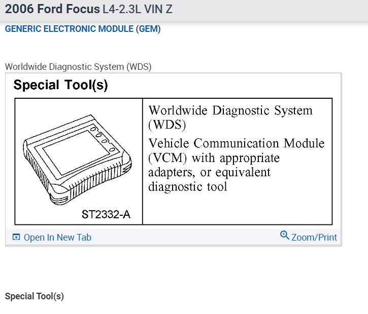

You may have had a voltage surge and taking out the GEM. we should do a CAN scan to confirm. You can get a CAN scanner (Controller Area Network) which will work on most cars from Amazon.
Here is a video to show you how:
https://youtu.be/u-4syLc-ifQ

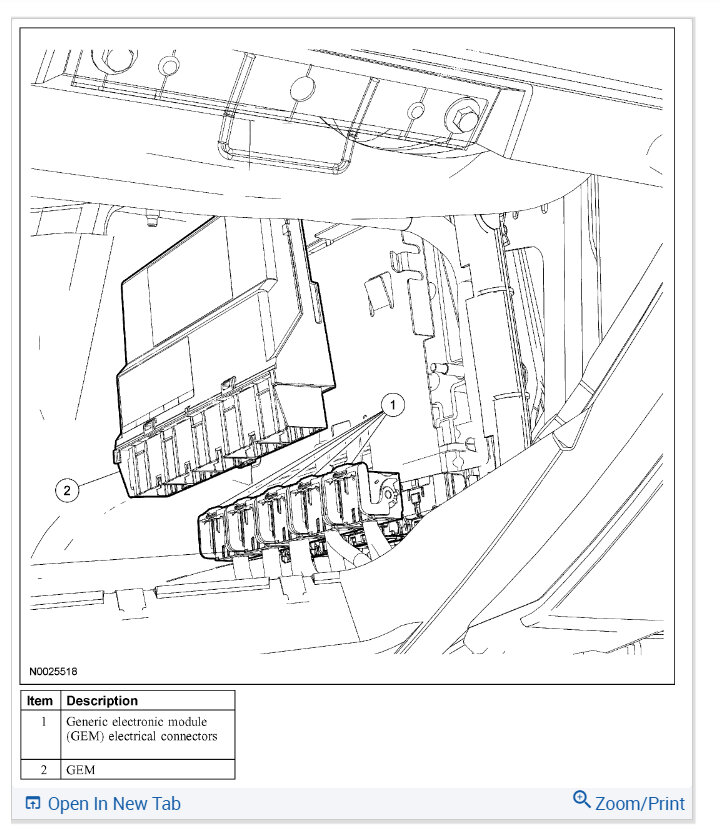

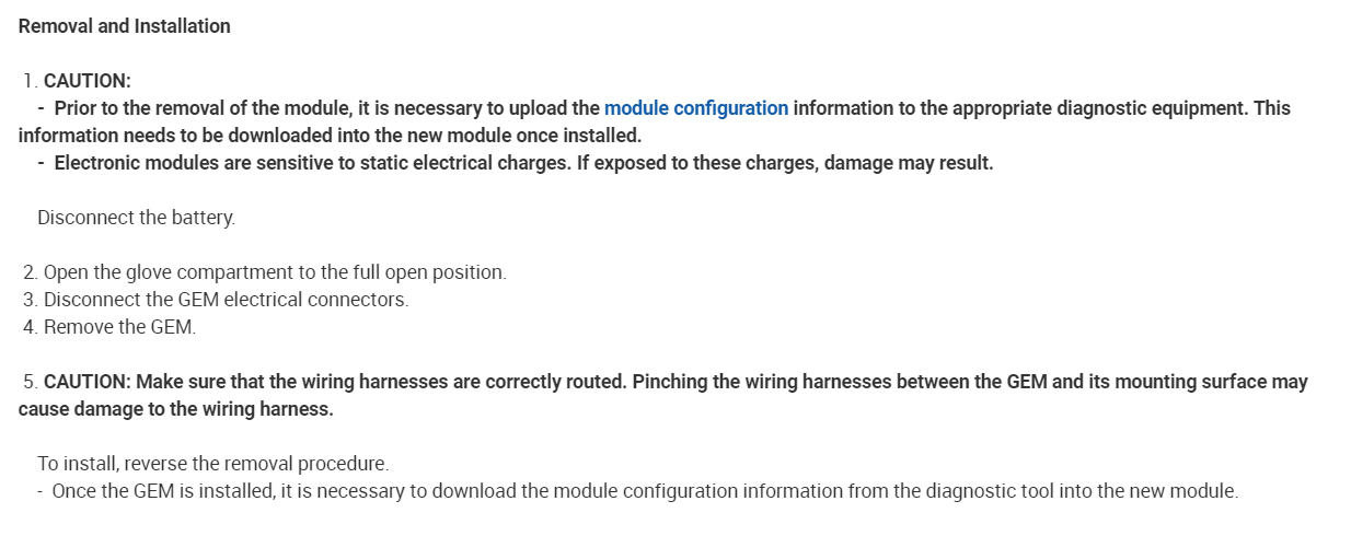

Here is the location of the GEM so you can check it out and replace it if a code comes up for it, you can get a preprogrammed unit by searching Google or Ebay. Check out the images (below). Please let us know what happens.
