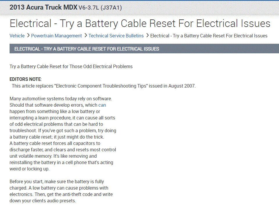

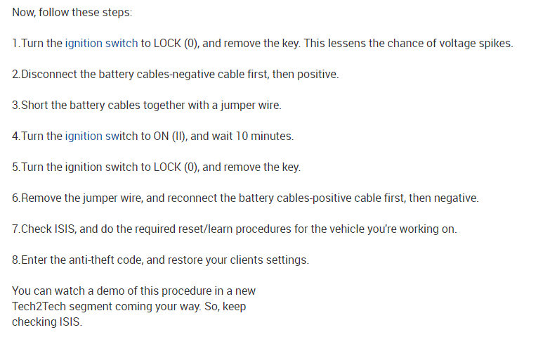

My key fob stopped working along with my high beams, turn signals, power gas door release, intermittent and low speed wipers, temperature gauge, door locks, electric rear gate open, air condition, auto headlights. Replaced batte5with AGM Battery, occasionally I get day-time running lights going on and off.
