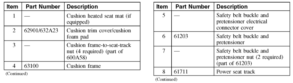

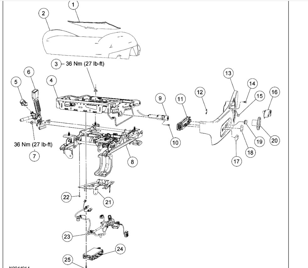

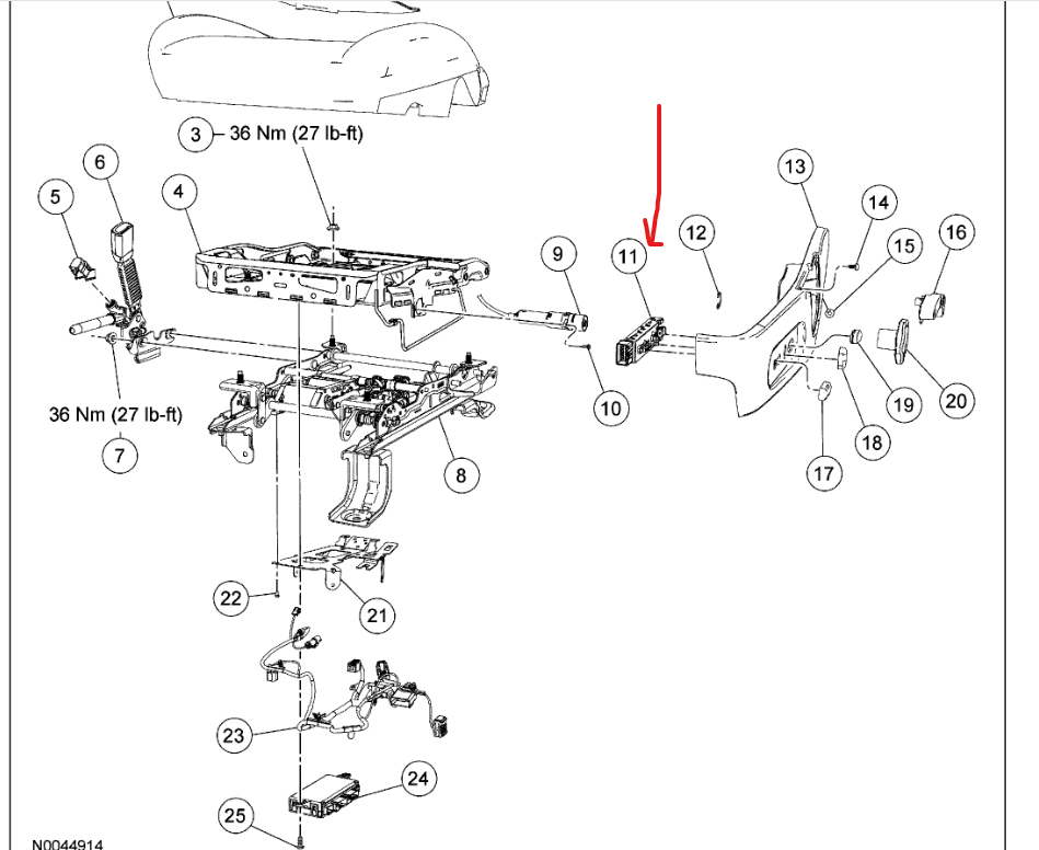

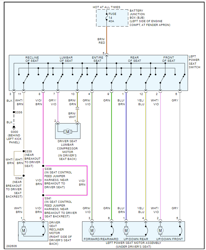

The switch for the seat is independent of the interior lights, there is no circuit that connects the two. So please start a new thread for the interior lighting issue. As for the seats, the only thing that can cause this problem is the switch itself. This is how to change it out to fix the problem. Plus, I included the seat position wiring diagrams so you can see what I am talking about. Check out the images (below). Please let us know what happens.
