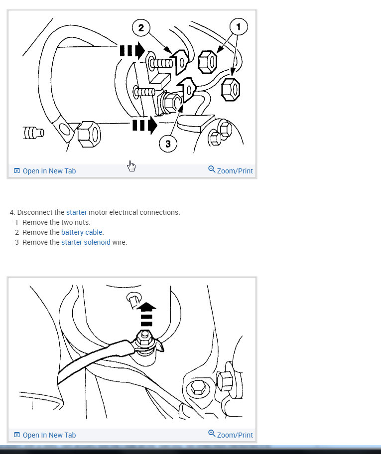

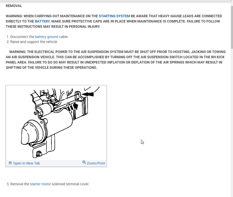

I take battery in, it tests fine after a charge at the auto parts store. I install a new starter. No joy. Then I put the breaker bar on and pop the belt off. It starts right up. I hand check all the pulleys, see the A/C pulley is stuck, pick and pull and repair (just the pulley, leave the old clutch). With the belt back on everything's good and I'm back on the road. Still no cold A/C though.

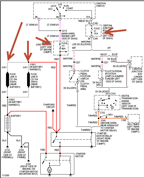

Multimeter across the battery terminals reads 12.39. I brought it in and it's currently charging on a 3A max bench power supply for last 6 hours. Original cabling is in place and showing age. No corrosion but certainly rusty.

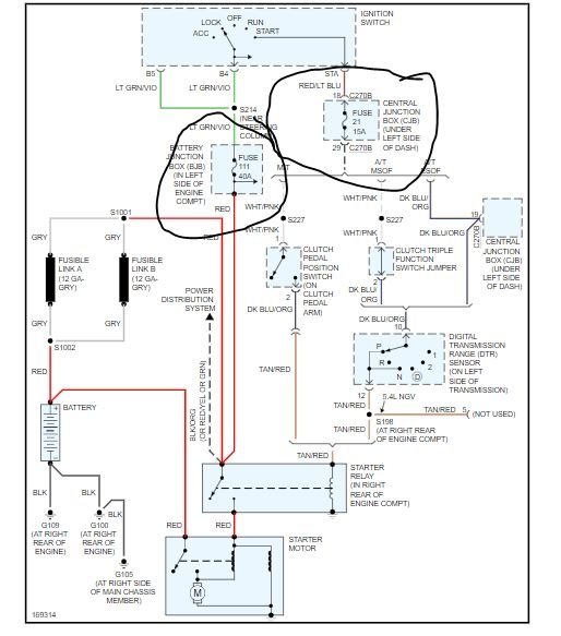

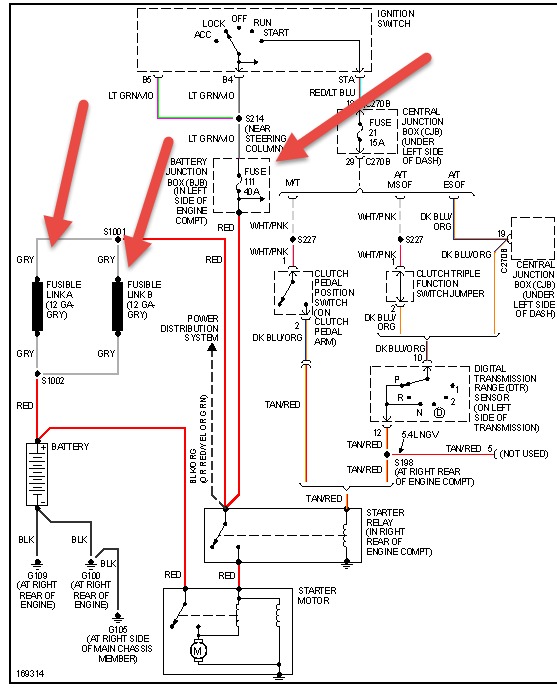

I figure in the morning I'll try to fully eliminate electrical by doing voltage drop test, checking relays and fuses. As for mechanical, can I try to turn the flex plate manually with my breaker bar and a socket? How would I go about that? Do I need to remove spark plugs?
Can a faulty alternator cause a no crank/no start? I mean hypothetically if the battery is known good/brand new.
