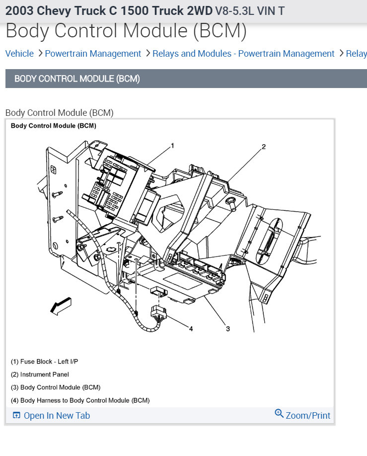

It sounds like you have a fuse out on the BCM. To be sure lets use this guide to check for power using this guide and the BCM location below:
Jun 27, 2019 at 11:12 AM
DANIELSLIFE13
We checked all fuses that we could. There are black ones that are factory with no viewing port. All checked good. Is there a fuse on the BCM? The gauges are now working but the left turn signal still blinks fast with foot on the brake, blinks normal without brake pressed. Cruise still will shut off if engaged when left signal is turned on, but has no affect on right signal
Jun 29, 2019 at 4:37 PM
Yes there are fuses on the BCM I would check those first.
