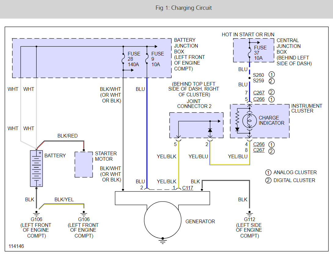

My battery is draining. if it drains too far it will not start so i put my jumper box on and i get it started. as soon as i disconnect the box the alt light and clock and interior dome light flicker. increasing engine speed does not solve issue if i start turning stuff on the flickering gets worse. if i check charging at battery by meter on jumper it reads 0. if i test with digital meter shows 11 volts. if i charge battery with auto charger it shows charged i start vehicle and all is well and it is charging 14.8 no load 14.4 with stuff turned on. forget about it for a few days and then i go some where park for a few hours and it will not start! rinse repeat.
