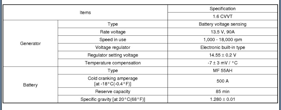

Okay, the battery light on my car comes on after i start it, but it is only dim not fully on. sometimes it will go out while driving or if i leave it idle but not always. There are times the car wont start it will just crank as if it's not getting spark. Usually i can let it sit for a couple hours an it will start right back up. The battery is new. i am thinking it could possible be the crank sensor. does anyone else have any insight or could possible guide me in the right direction? Thank you so much for reading.
