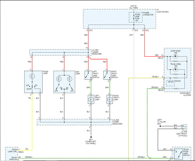

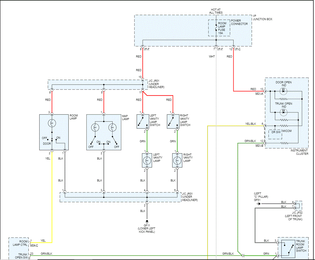

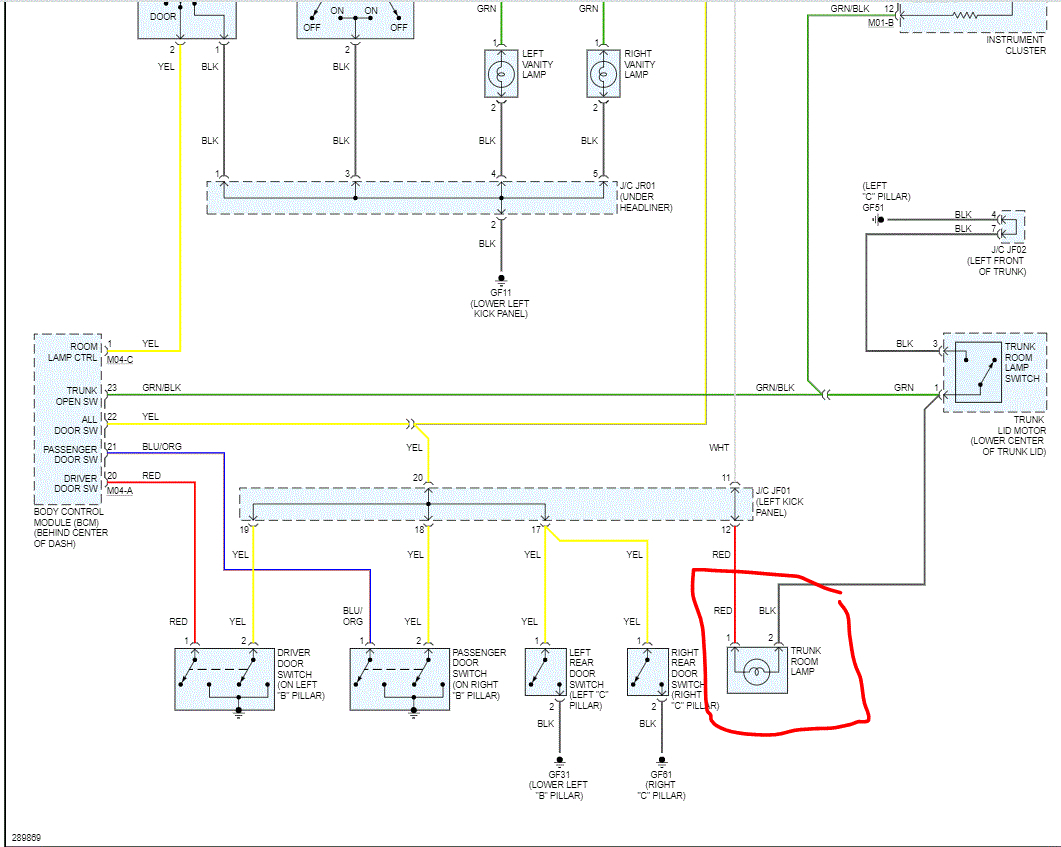

Okay, the fuse you found as the draw basically covers everything you mentioned. Do not cut the wires to test for a draw. How did you check the trunk light? Did you remove the bulb? Where were the other components disconnected?
If you look at the two pics below, I attached the entire wiring schematic for that circuit. See if anything was missed.
I cut the pic into two parts so you could read it. However, I did overlap them so you could follow from one to the other.

No, I am not cutting any wire, I was going to do that as a last resort and/or remedy as the car is old and has 110,000 miles on it. I wanted to pinpoint the wire if I can and then cut it to remove the draw. I don't know if I'd have the wire fixed or not, especially if it's something simple as a dome light or trunk light, I don't care if those don't work. :)
But what I did with the digital clock, trunk lamp, map lamp and dome lamp was simply unplug them. I popped the plate open on the dashboard to get to the back of the digital clock and literally just unplugged it from the unit. Did the same for the other things as well. Didn't remove any bulbs.. basically what you would do if you got a replacement part.. unplug the old and simply plug the new in, and pop or screw it back into place.
I was hoping that's all it would need to be done so I don't have to clip any wires to fix anything. but would simply unplugging like that do the trick? If so, then I need to unplug elsewhere since I unplugged all of them and that didn't do it.
I am wire diagram illiterate I'd say. I'm trying to make sense of it.
