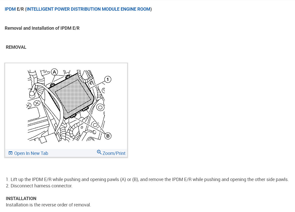

This sounds like the IPDM is going out. here is a guide to help you replace it. Here is the instructions in the diagrams below to help you change it out. Check out the diagrams (below). Please let us know what happens.
