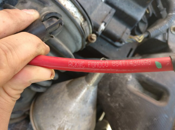

Wondering where to connect this electrical connection eyelet. I took it off but forgot where it connects. Here's what it says on the side. Thanks!

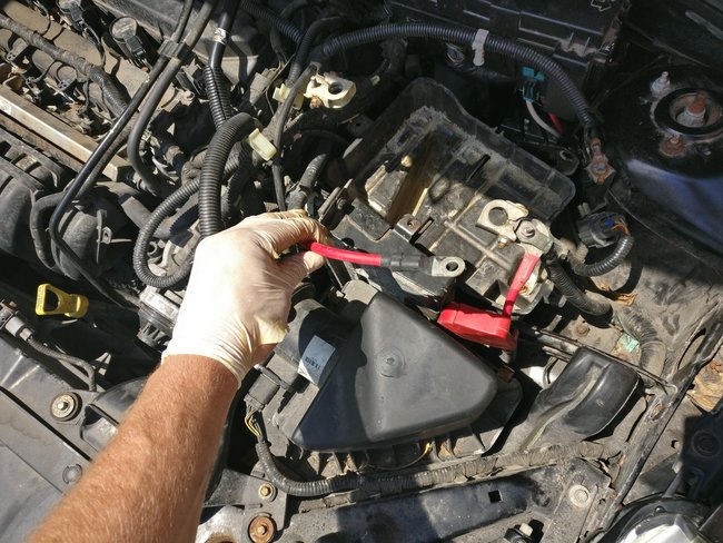

That does not look like a factory cable. Do you have lights, sound system, or an alarm on this vehicle? If so, and the cable was attached in the engine compartment or the general area that you have it laying there, it would only go to the positive battery post. I circled the nut that you would remove and connect to the post there.

Thanks for the reply. This car is 100% stock. I traced the line back to the alternator, which is confirmed by the battery icon light coming on. So it has something to do with the alternator. You think I should put it under that nut on the positive terminal? There is already a connector there.

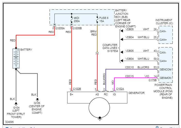

Here is the wiring diagram that shows the other end of this connects to the alternator. That means this end connects to the BJB.
There should be an empty spot for it. If you can't locate it then get me a picture of your battery junction block and we can find the spot.

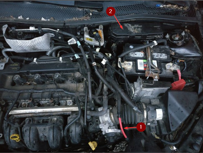

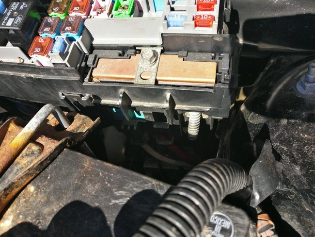

Just to confirm, number 1 in the picture I attached is the cable in question, correct? If so, It is going to attach to something in the junction box, which is number 2. Open that up and we are looking for terminal 1. More then likely it will be an empty spot. Get a picture of the open box if you can't find it and we will figure it out.

You are correct in the labeling. I will look tomorrow after work, thanks.

Sounds great. I am sure that cable is going to go to that box so let us know when you get to it. We will wait to hear back. Thanks

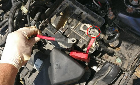

Would it go to this bolt?

That's it. You should have a nut with a washer to secure it. If not, just get a new on from a parts store. Also the wire is going to be pointing down. In other words you put the eyelet on the stud and then the wire should be going down, not sideways or up.
Good job. Let us know if you have other questions. Thanks
