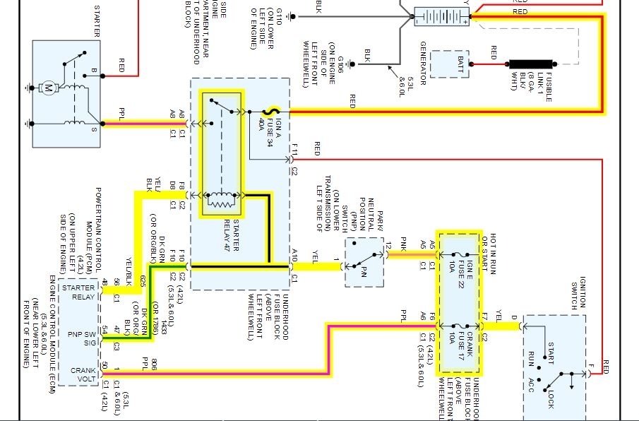

I am looking for the wiring diagrams for the start circuit from switch to starter and also diagram for fuse boxes. all I have so far is the relay is clicking when key is turned. thanks
